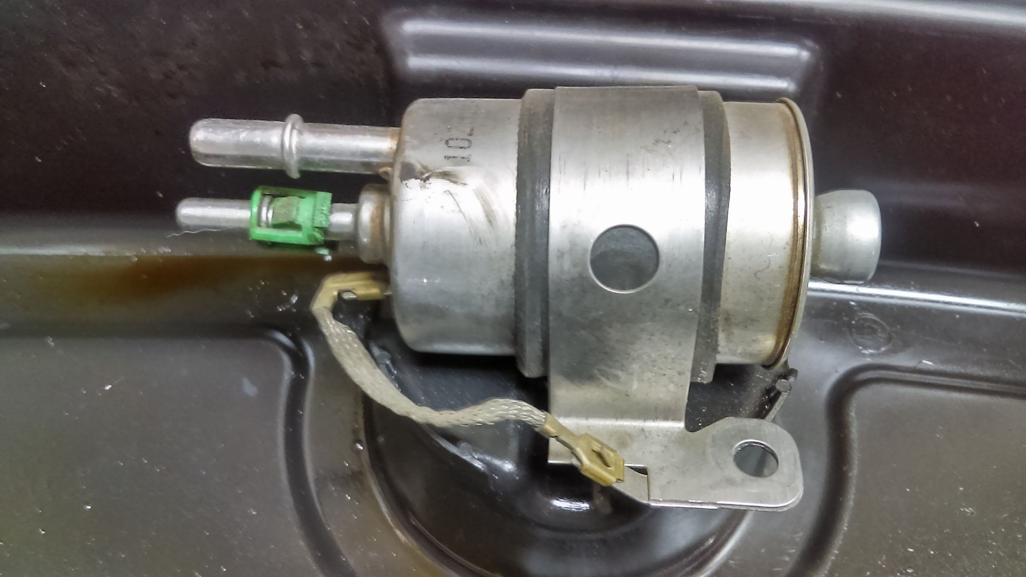

'03 Z06 with fuel filter/regulator assembly. I'm going to replace it since it appears to be the original unit that's over 18 years old and has over 47K miles. What is a good quality replacement? Checked a few autoparts stores and prices range from $20 to $120. Car does mainly track duty so it spends a lot of time over 4000 rpm. Prefer something not made in China.

Your local Napa will have or can get the Napa Gold filter, which is a U.S.A. made Wix.

This is what I used.
https://smile.amazon.com/dp/B000C9UJ...v_ov_lig_dp_it

Originally Posted by joeflyer
Used the same in my 03 z06

Wix here as well
Ditto …. no issues after about 30k miles since the install.

They install in line, not in tank.

Somewhere in mid 2003 they changed to the FFS system so there is no filter to change with out dropping the tank

Mission accomplished. I ended up going with the WIX unit, proudly manufactured by our good friends in Taiwan. Searched both high and low for a USA manufactured assembly, no luck. Pretty straight forward, the clips were a bit off a PITA due to minimal accessibility but got it done. Got the proper tool for the outlet line.

Ive used wix products in the past and have never had any issues. they make quality oil filters as well (ie, no paper inserts). good luck!

Did you verify what fuel system you have? If you have a late 03 you have the C6 fuel tank system, and the filter arrangement is completely different. I learned this the hard way and now have a brand new fuel filter that is completely useless.
