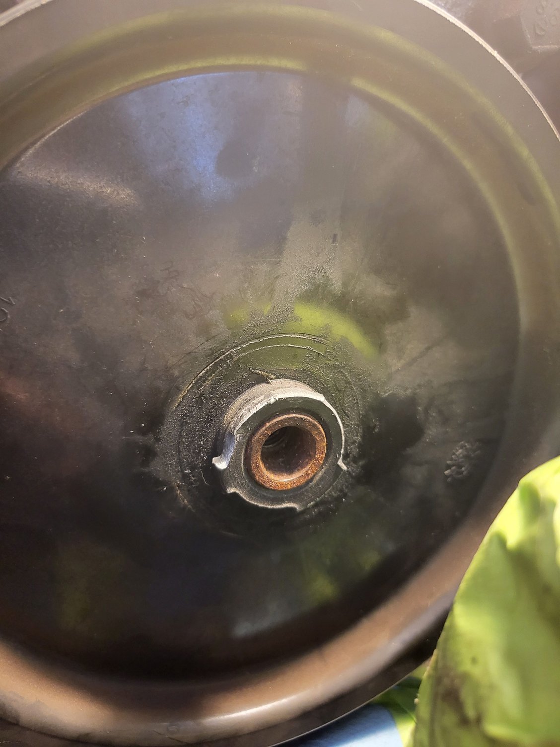

Old Oct 15, 2021 | 03:20 PM

Posts: 7
Originally Posted by Smoken1
You can just break the rest of pulley off till you get to where you can use a dremel to to cut it off the shaft
Then just replace the pulley with the metal LS2 pulley
I attached a picture so that you can see what I'm talking about. Just to be sure we are talking about the same thing.

Put the pulley in a vice and start breaking it off, It will break just like the collar did
or take it to a machine shop they will do it

It's attached to the engine still and the vehicle is not capable of being driven as I am currently working on some mods. The transmission is out, differential, etc.
I guess I'm gonna have to take a dremmel to it and see where I can get. Thanks again for the input. By the way, is your vette really in the ocean there?1? Yowza, I'm sure there is a back stroy. lol

Well...I got it. Thanks for all the help @Smoken1 I appreciate you!
The aftermath😬
