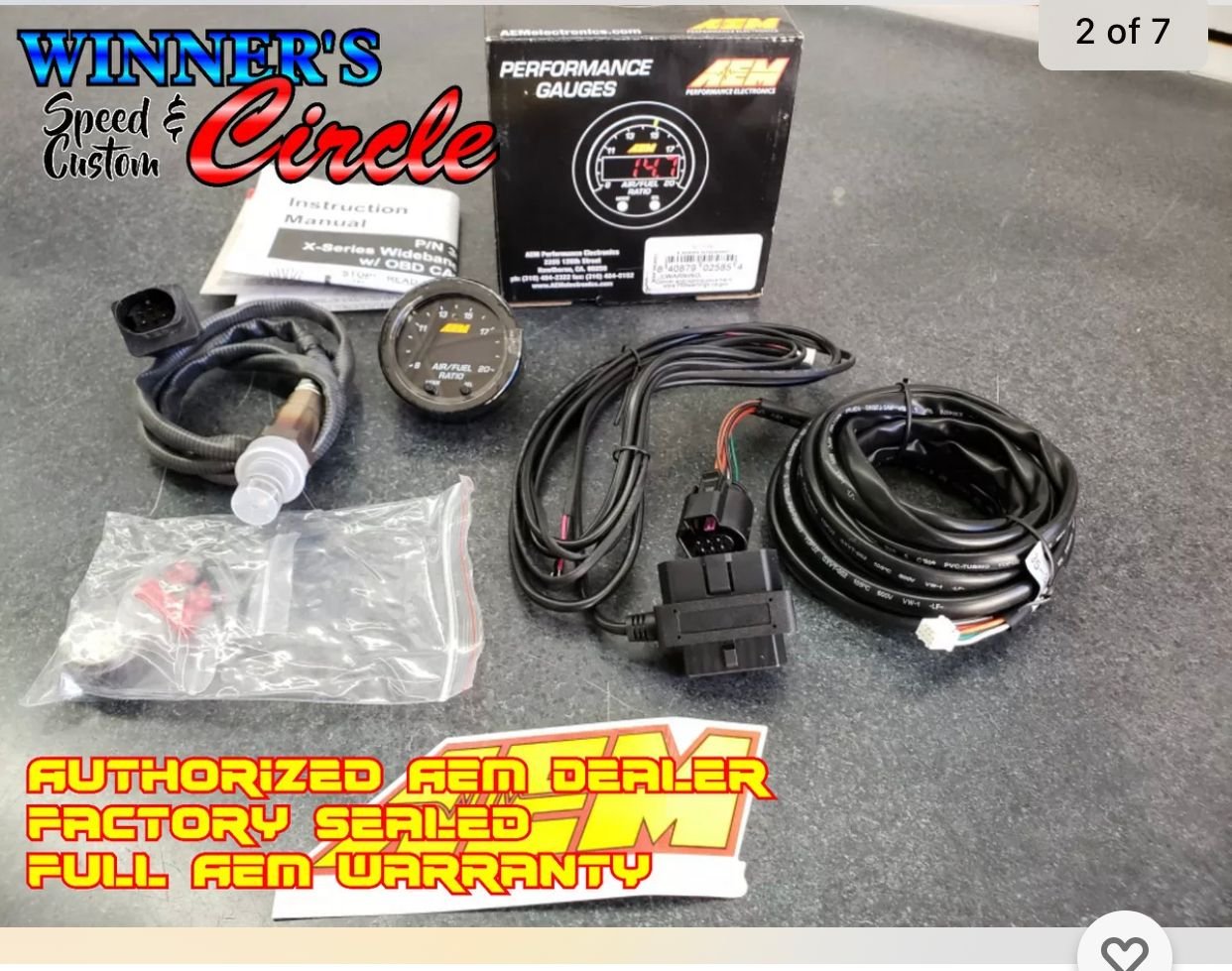

Aem 334 x series uses a adapter on the obd 2 port for hpt tuners no wiring that up for tuning
I did a ton a research, not sure but there was a reason I didn’t use that one. Can’t recall what it was though
works great been in the car two years
The adapter is what came in handy just slide that piece over the obd 2 and hook up your hpt….yup it was simple now & u can always add in the hpt live afr but that cost more through hpt

I’ve heard it’s just fine. I was more searching the type of data it sent. I think that one is a digital reading that has to be computed back and the 0300 is analog, not computing needed. Again, can’t recall, looked into heavily at some point but soon as I made my purchase, I forgot the info.
