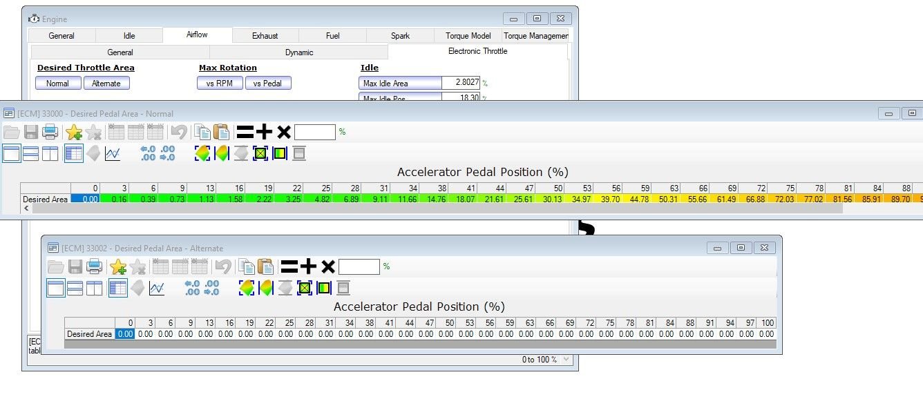

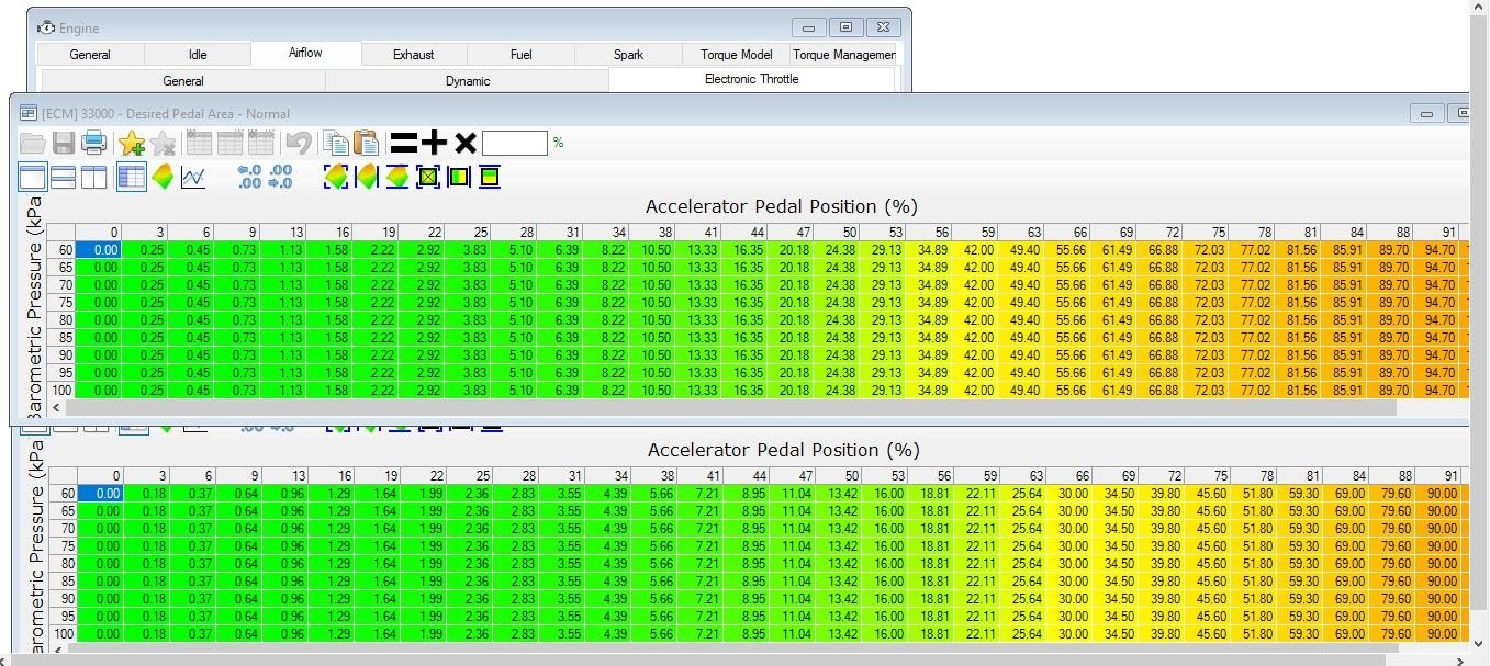

The 01 and later have the dual throttle tables. The 99 and 2000 do also, but the Alternate table is populated with 0's.
I've attached some screen shots.
2000
2001
What I don't know yet is where or how this is communicated to the ECU.
I do know that when I put a 2001 tune file into my 2000, the engine runs fine, starts right up, but the gas pedal is dead.
So working on figuring this out.
Timing tables are here.
This looks a little different on a 2001 file.
Not sure if this helps, but it is interesting.
Ron
