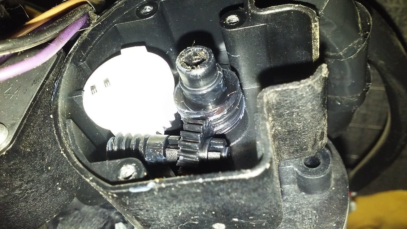

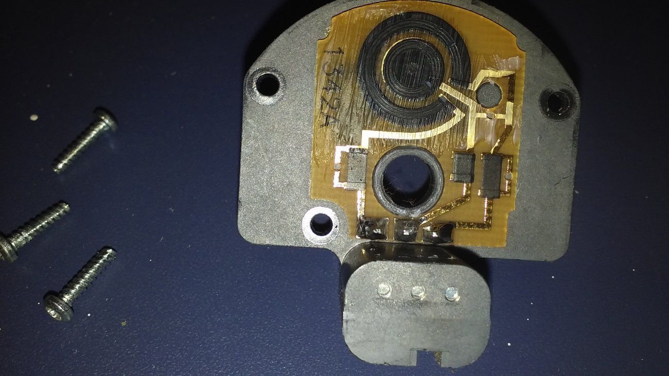

Seat position is controlled by the BCM which receives a seat position signal from the seat via a position potentiometer attached to the seat motor. There have been reports that cleaning and re dielectric greasing that seat motor potentiometer can restore accurate seat position signal from the seat to the BCM.
Bill Curlee suggested some tome ago to first run the seat back and forth a number of times to perhaps self clean the seat motor potentiometer and see if the condition disappears.
Different keys can, if the BCM has received a different seat position saved location for that key, cause different seat movements which may or may not be blurred by a dirty seat motor potentiometer.

Jim993 is correct. 2 years ago, I grew tired of my seat stopping wherever it wanted to! So I pulled the seat, put it on a workbench, and did exactly what he suggested, except for the dielectric grease part. Do a search. C&S Corvettes, and/or other You Tubers have video's on how to do it. I followed their instructions (can't remember the user's name for the video) to a T. It didn't honestly look that dirty, so I was skeptical. But I put everything back together, and 2 years later it's still working right. Best of luck to you.......
