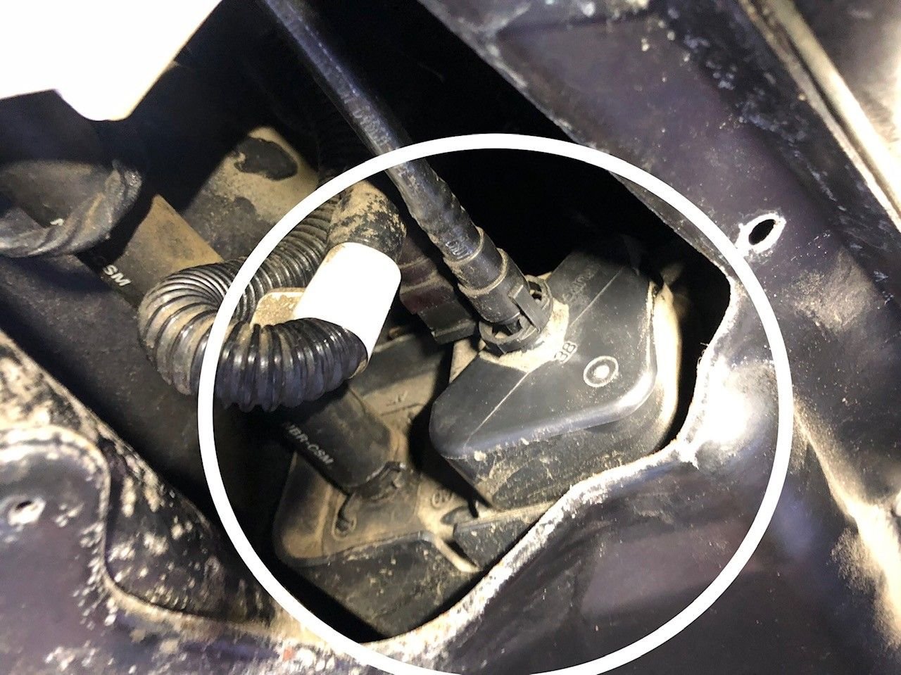

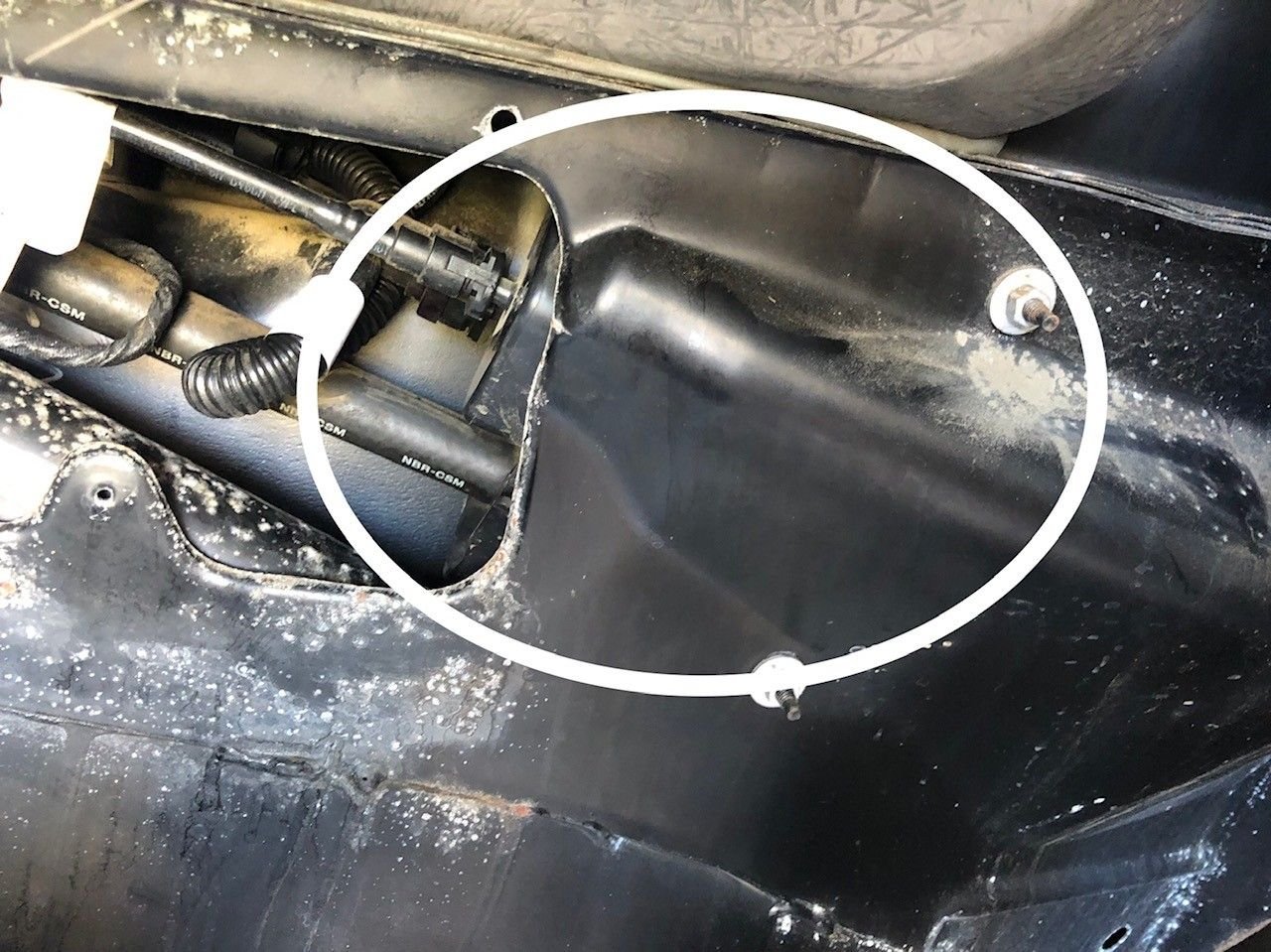

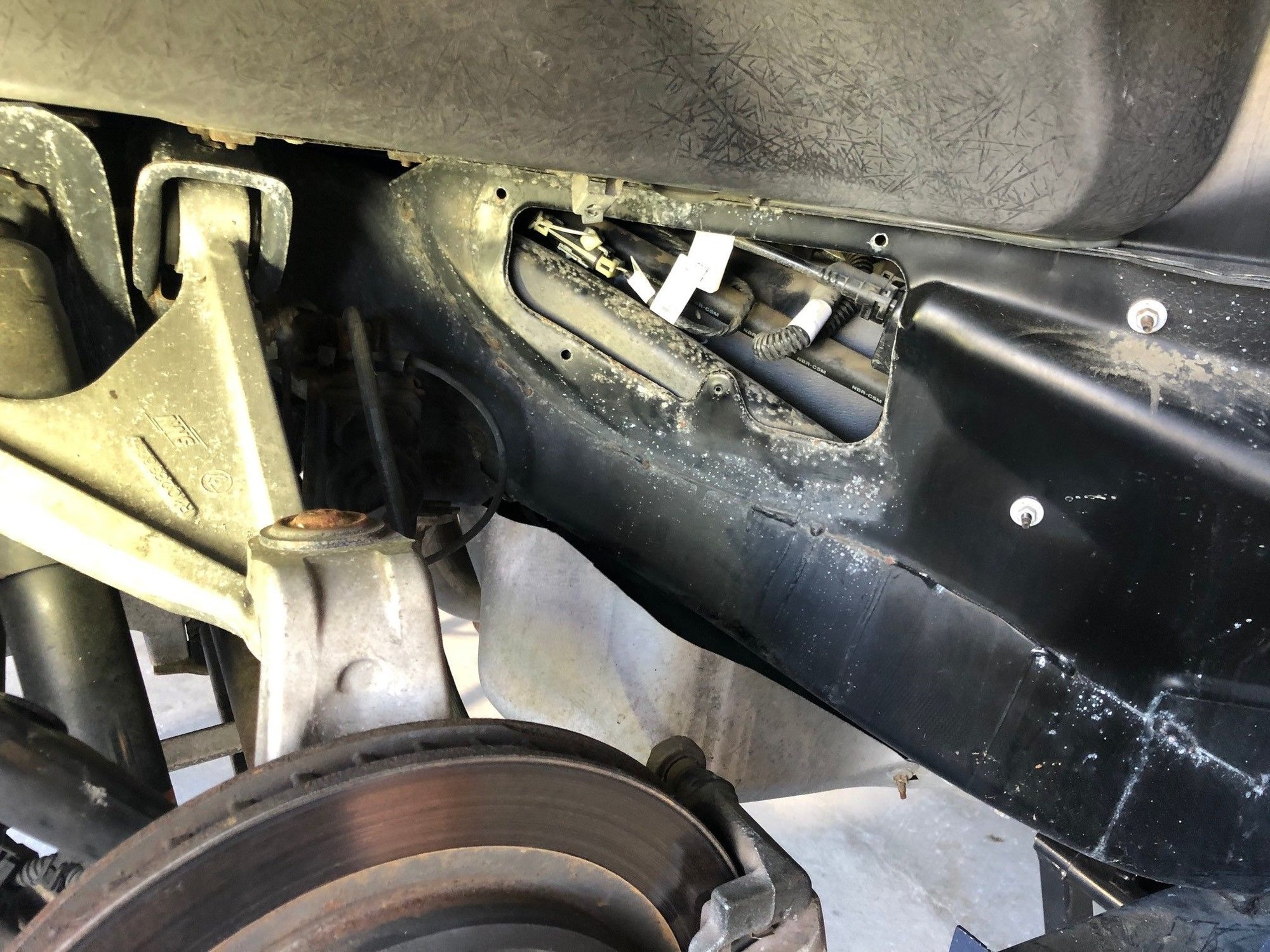

I have recently purchased a 2002 Corvette with 2800 miles on it and I am having some issues with the fuel system. When I fill the gas tank up, the gage reads 7/8s full, then after driving for a bit it slowly starts moving until the gage indicates slightly over full before declining erratically afterwards. More concerningly, I smell fuel coming from the right rear area of the car by the wheel after refueling. After driving for a bit, the car throws P1431, sending the gage to empty. I reset the code but it always comes back. It has also run out of fuel with roughly 6-8 gallons of gas remaining in the tank. I have tried the Techron solution before 6 fill ups to no avail. Any ideas on what could be causing this?

The P1431 is a faulty right tank fuel sender...if you add the Techron to a full tank it will not get into the right tank...add it when the tank gets down to say
a 1/4 tank or less... the EVAP charcoal cannister is in the right wheel well area and also the EVAP vent valve is located in that area also. Also don’t overfill your tank and if you can get non ethanol fuel in your area use that with the Techron for a while !!
