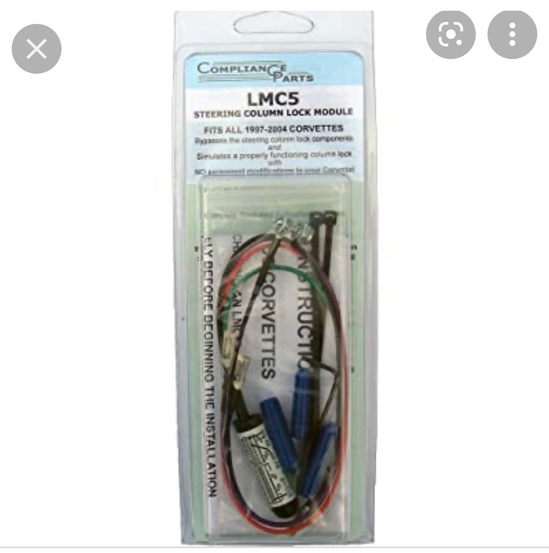

Getting yourself an LMC5 will cure your car stalling when you give it the gas !!..easy fix but you will eventually have to get the current wiring straightened out !!

I did install one but removed it and set everything back to stock. I even went as far as to check every pin out on all the bcm connectors because the prior owner moved pins for whatever reason. Sorry there's been so much I forgot to mention that in my original post
