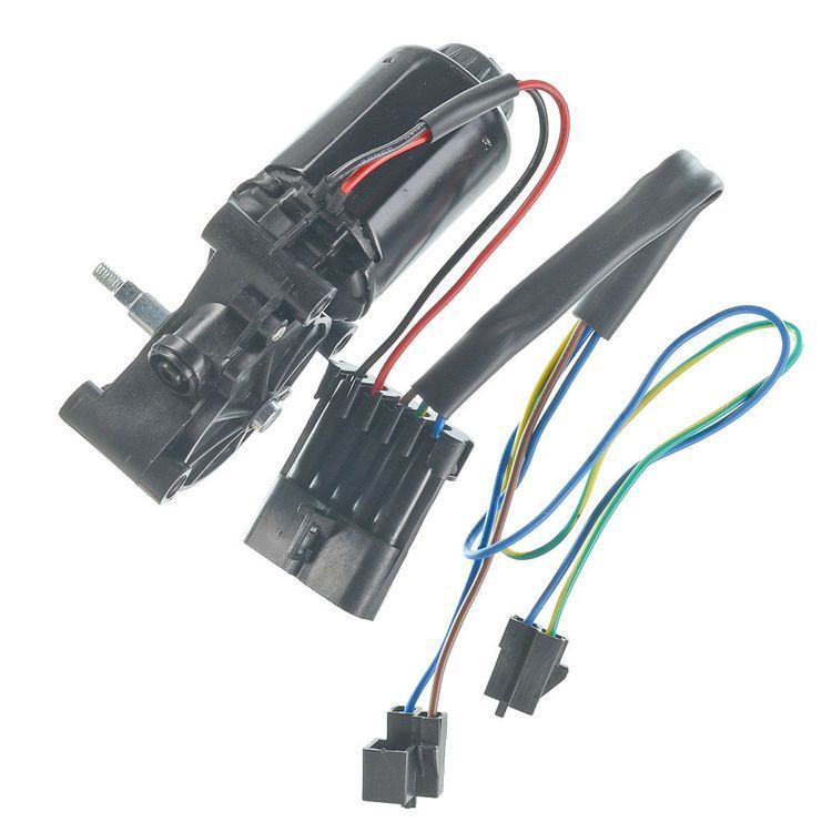

Looks like $160 for the pair of motor assemblies from Amazon, and $101 for the pair of gear kits from Rodney Dickman (including shipping): http://rodneydickman.com/product_inf...products_id=92
If I had more time on my hands I’d probably go for the gear replacement, but I’m thinking I’ll replace the entire motor assembly to save time.

Just be sure those are for Corvette. The F bodies have a different length shaft and if that is the case you will be taking the motors apart if you wish to keep them. I looked at the Amazon listing and they list for a corvette but picture a F body. I looked up the other wiper motors from that company and they have the same exact F body pictures but list for firebird.
Amazon Amazon
Maybe JDM can verify they are correct.

The bulb connections in the Amazon link appear to be from a C5.
The firebird bulb connections look quite different.
I went through the process of putting firebird motors in my c5 and it can be done you just have to swap some things around

If OP hasn't bought them already, here are a pair of new motors for $55 each
