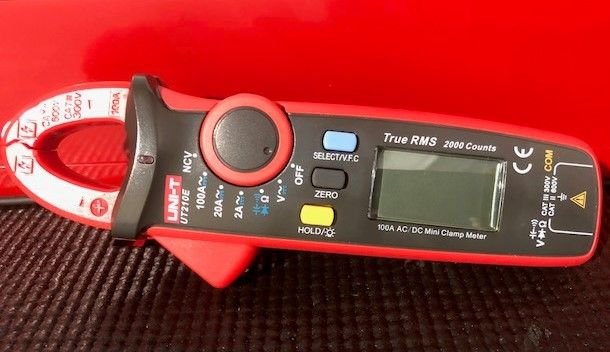

Where did you purchase the fuel filter/pressure regulator ??...if Amazon or Ebay that would be suspect...you may also have high resistance in the fuel pump circuit...high resistance equals low current flow equals low pump output equals low psi !!...you can try removing the pump connector and hotwiring the pump directly from the battery or another car battery if you can...if pump pressure is normal you'll have to do some detective work...I'll be moving your post over to the Tech section. BTW, if you get yourself an amp clamp off Amazon it would be easy to check current flow and a good addition to your tool box...the normal current flow should be around 6 amps or so key on. The power (gray wire) and ground (black wire) are on either end of the pump connector...pins A and D.
