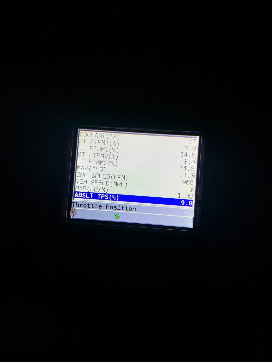

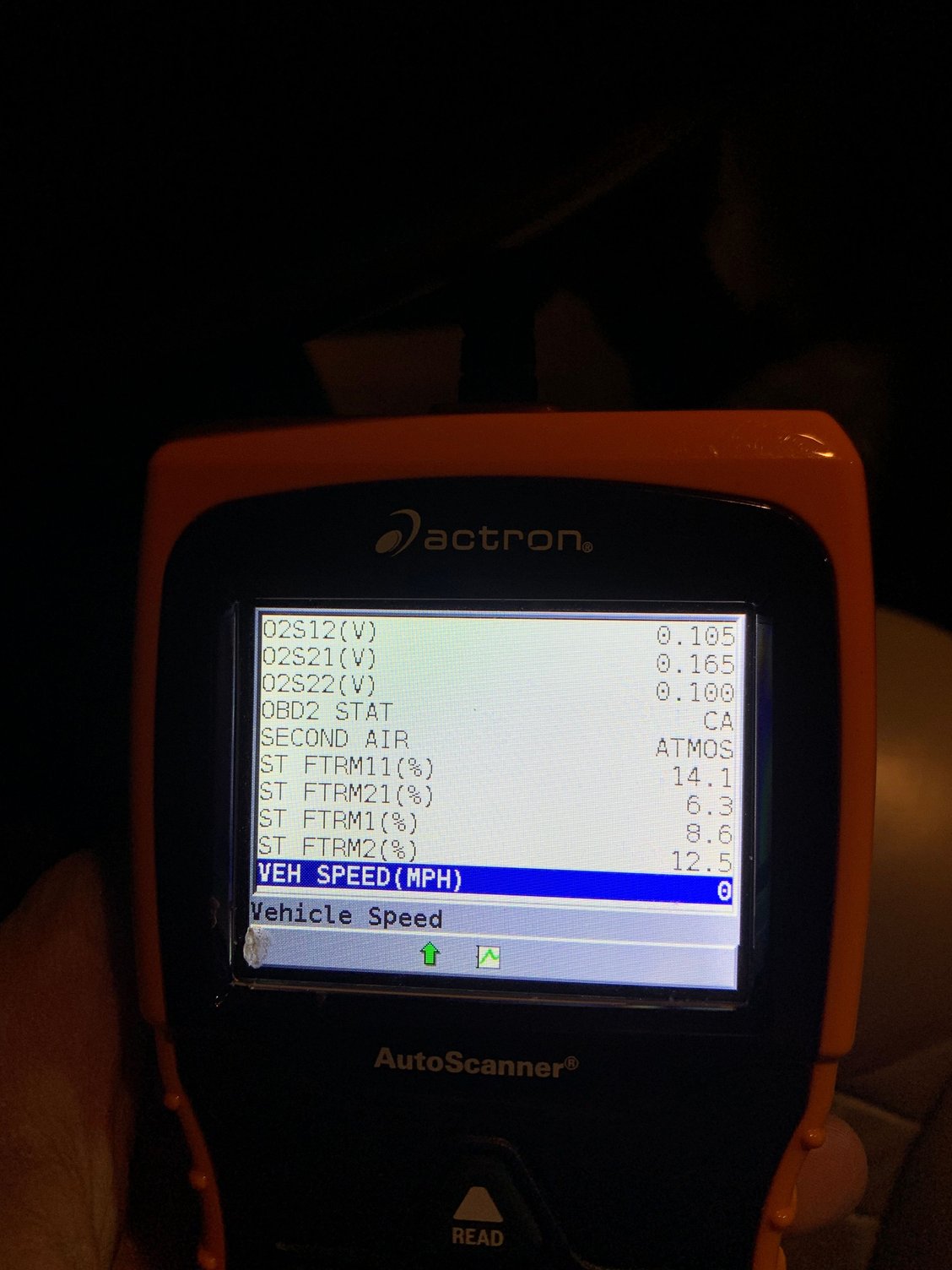

Any idea what these trims mean? Idle engine temp around 80. Slightly feeling like a misfire but not lighting up check engine light.

Spend your time finding the cylinder that is misfiring during a live run. Get the misfire counts off each cylinder. This will help you find your problems more than fuel trims.Your trims are showing that your fuel is within specs and you may have an internal problem if your ignition is OK.

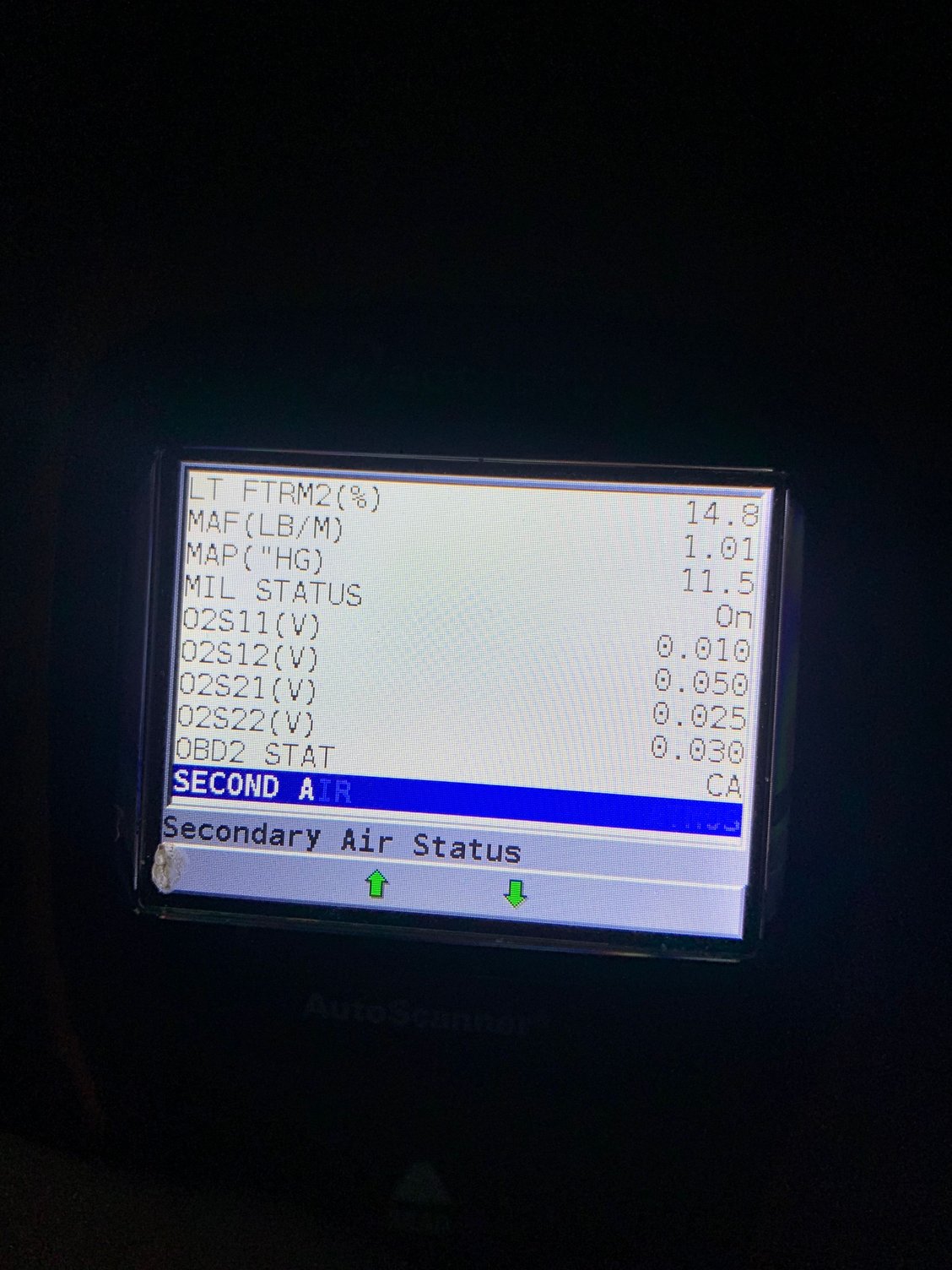

Here’s the LTFT and the freeze frame data for when the code was set. I know I still need to figure out which cylinder is misfiring. Hope to do that tomorrow

Depending on the load with almost 15% positive long term fuel trims it’s either a vacuum leak or an injector misfire being that high…I’ve explained a few times here how to diagnose for a vacuum leak…good luck !!

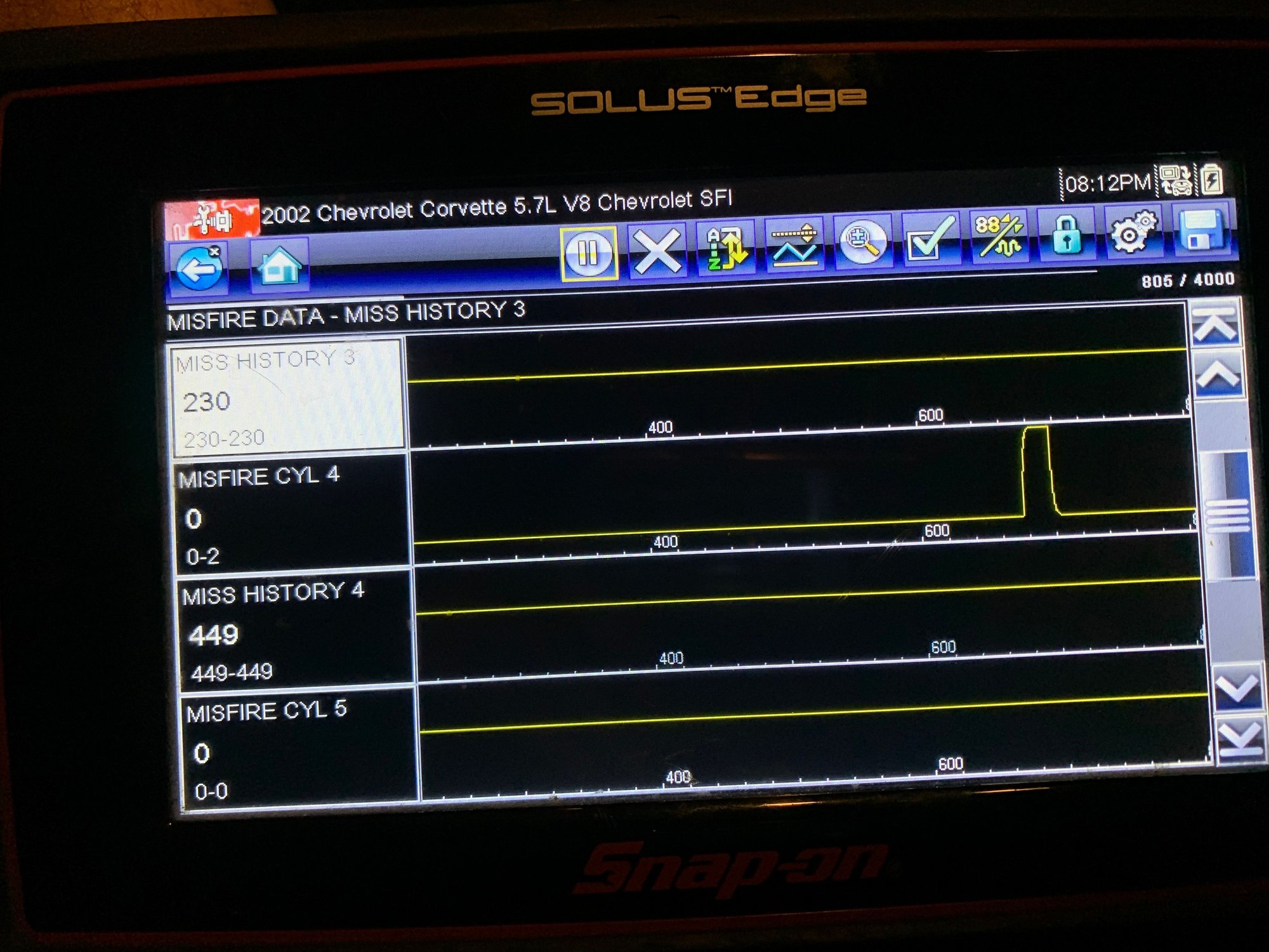

got cylinder two still missing quite a bit. Also found the large diameter PCV hose that goes over the PCV valve very cracked so I’m going to take a look at that tomorrow. Gets dark so early now.
