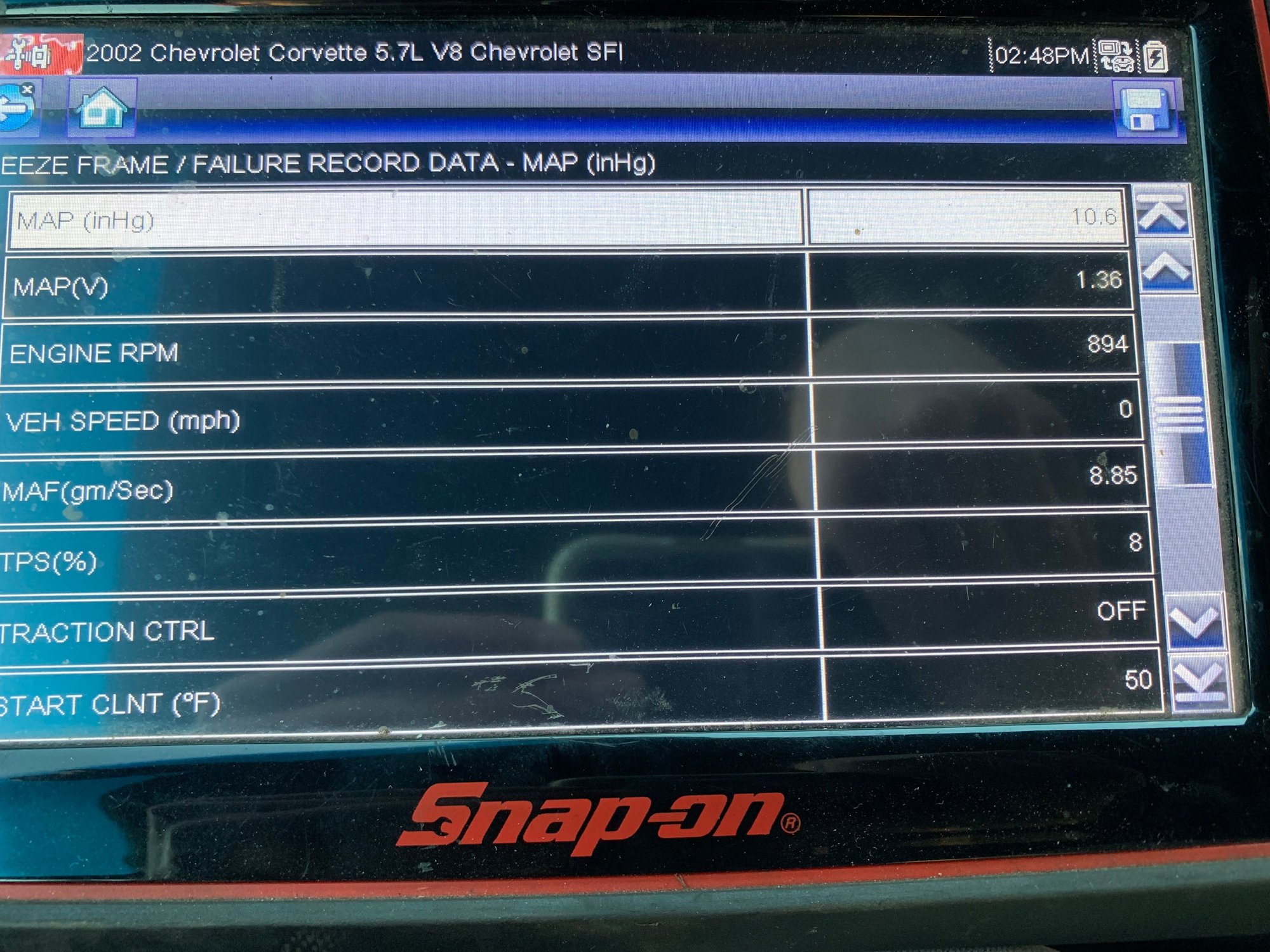

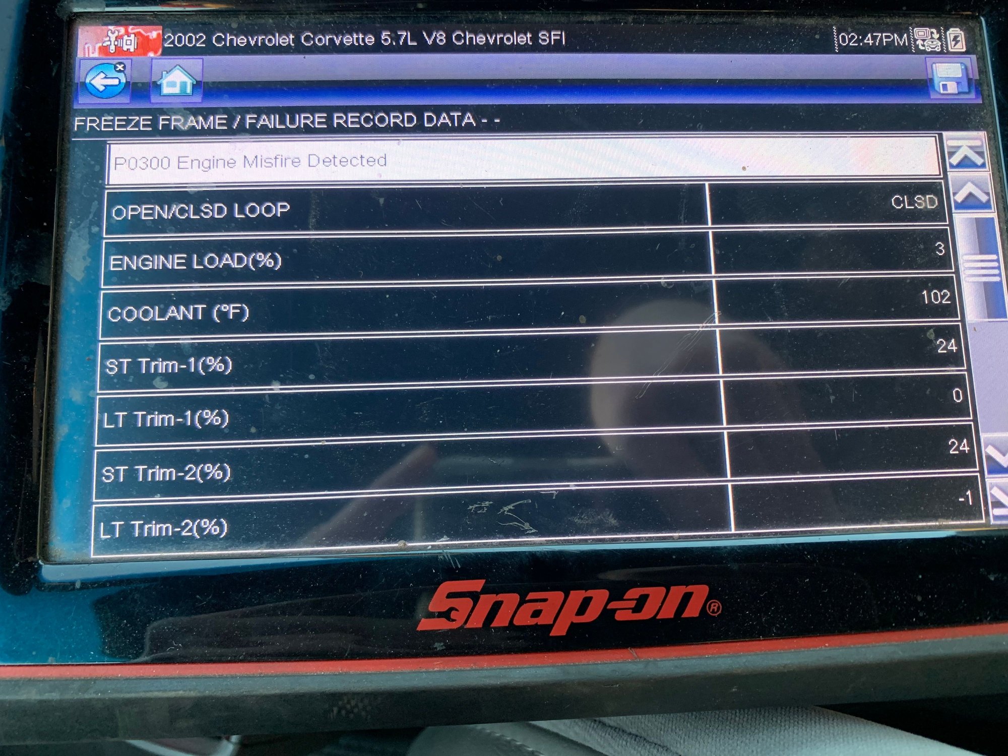

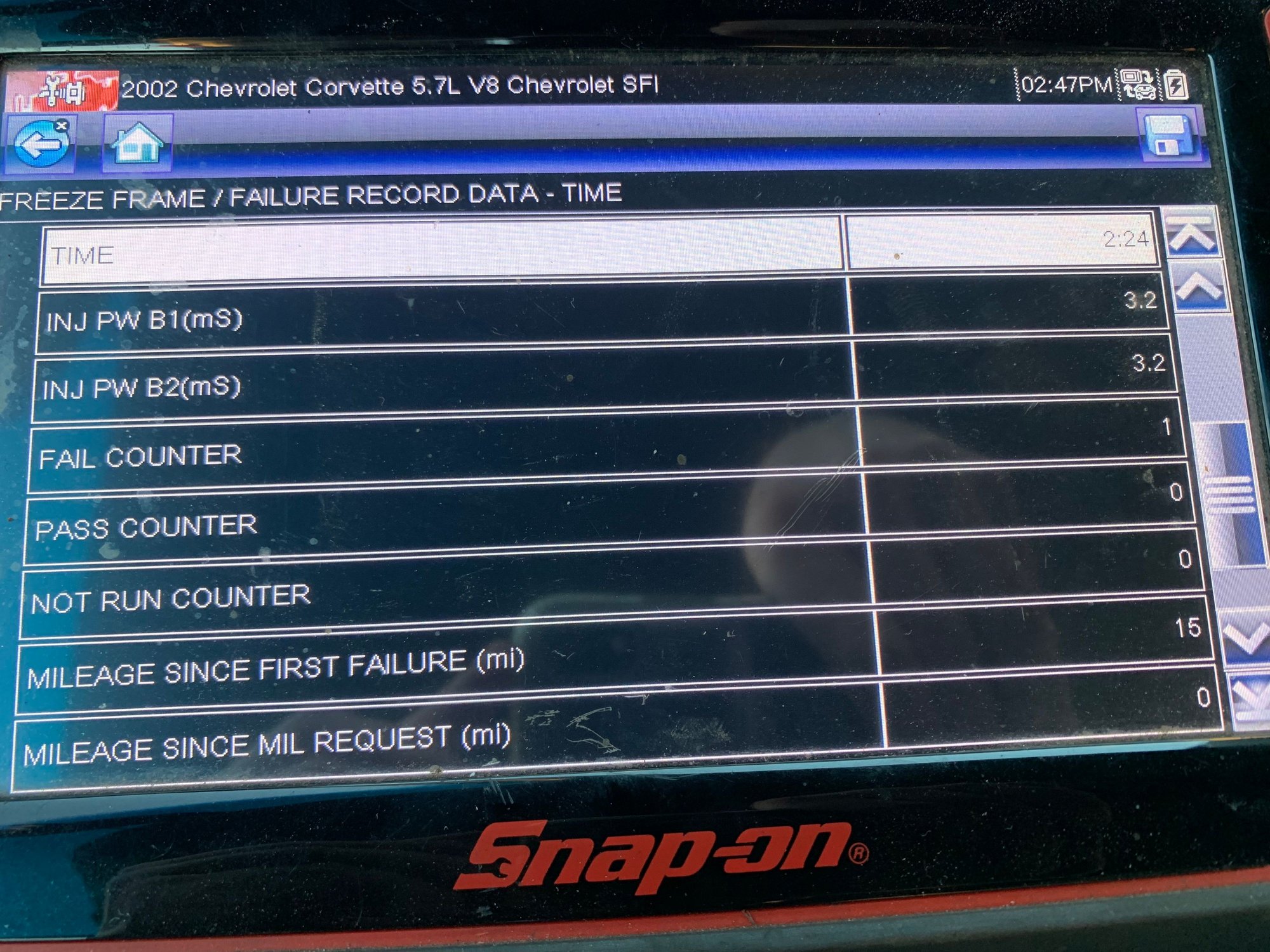

So I had the scanner on the car and the data screen froze while it was misfiring so I wasn’t able to get LT or ST trims but I got these photos.
Cleared up around 150 degrees

Tried to post some attachment photos but for some reason they wouldn't go through.
Got the car to misfire and throw the p0300 code again but the live data froze on the scanner. ST trim1 and ST trim 2 were at 24 at one point. Does this signify vacuum leak?
Noticed the misfire would get worse if I blipped the throttle and would almost stall the car.

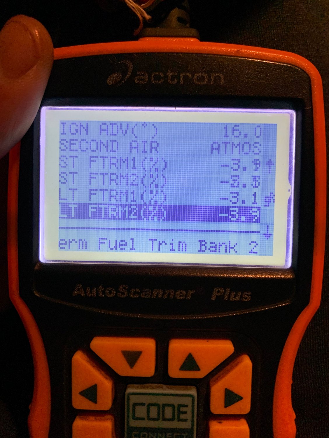

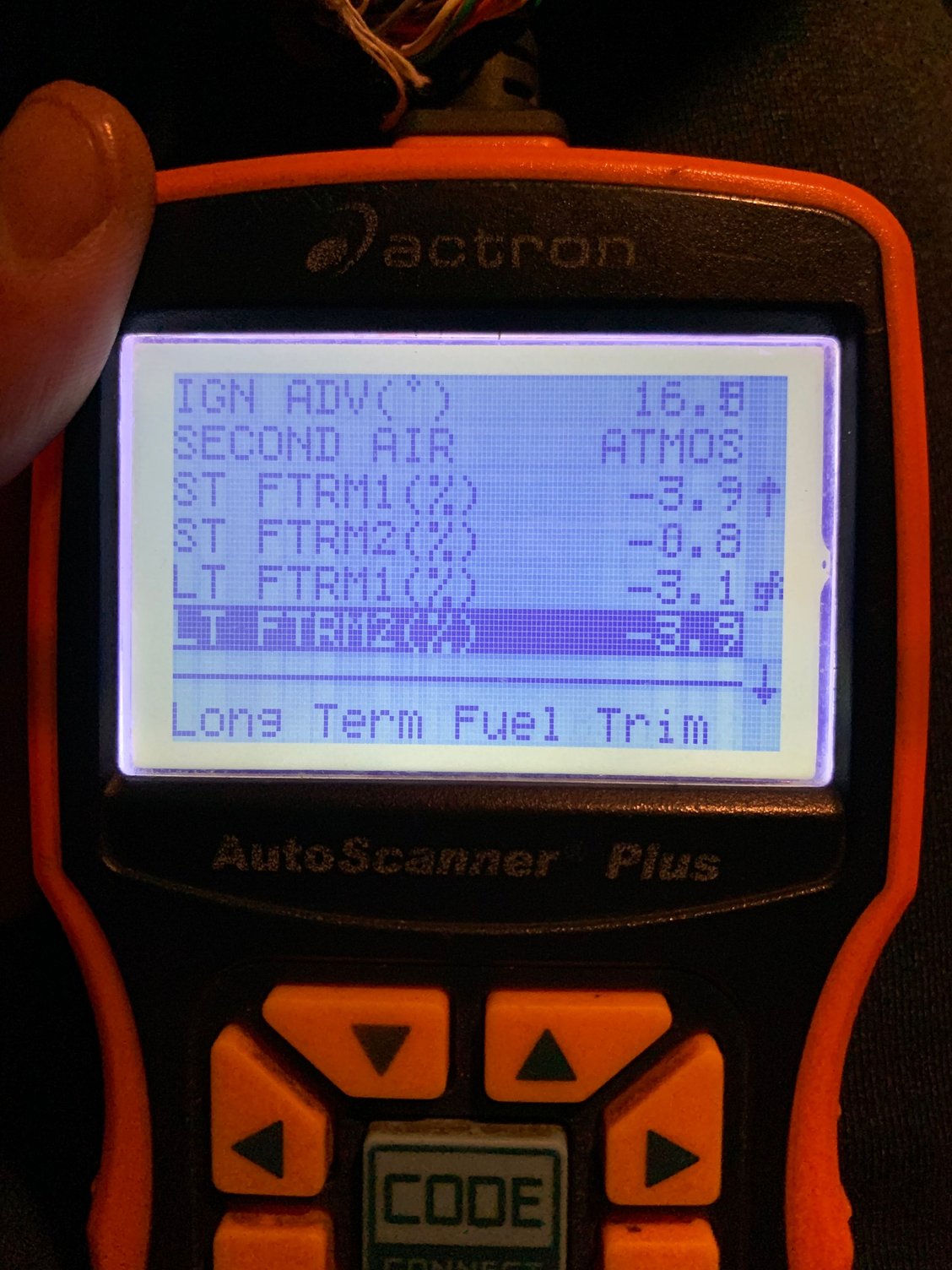

Your fuel trims look good. I would look at the cylinder misfire counters and see which cylinder is misfiring. P0300 is for a random misfire which is usually ignition related rather than fuel. I doubt if you have a vacuum leak but maybe a bad coil, wire or plug.

A Snap On scanner froze ??…unheard of…LOL !!…short terms are what they are reacting to the O2 sensors at the present moment…short and long terms should not be more than plus or minus 10%…you will not see a P0171/0174 until the long terms hit 23%…raise the idle to 3K and see if those short terms quickly go towards 0…injector pulse width at idle should be around 2.5 milliseconds…you show about 3.2 so the PCM is adding more fuel…look at freeze frame data and it will show what the engine was doing when the P0300 set…misfires are a little more difficult to disgnose !!…you can try spraying that Brake Kleen around the intake runners while looking at the short terms after the car is started in the morning and see if the short terms go negative that signifies a vacuum leak.

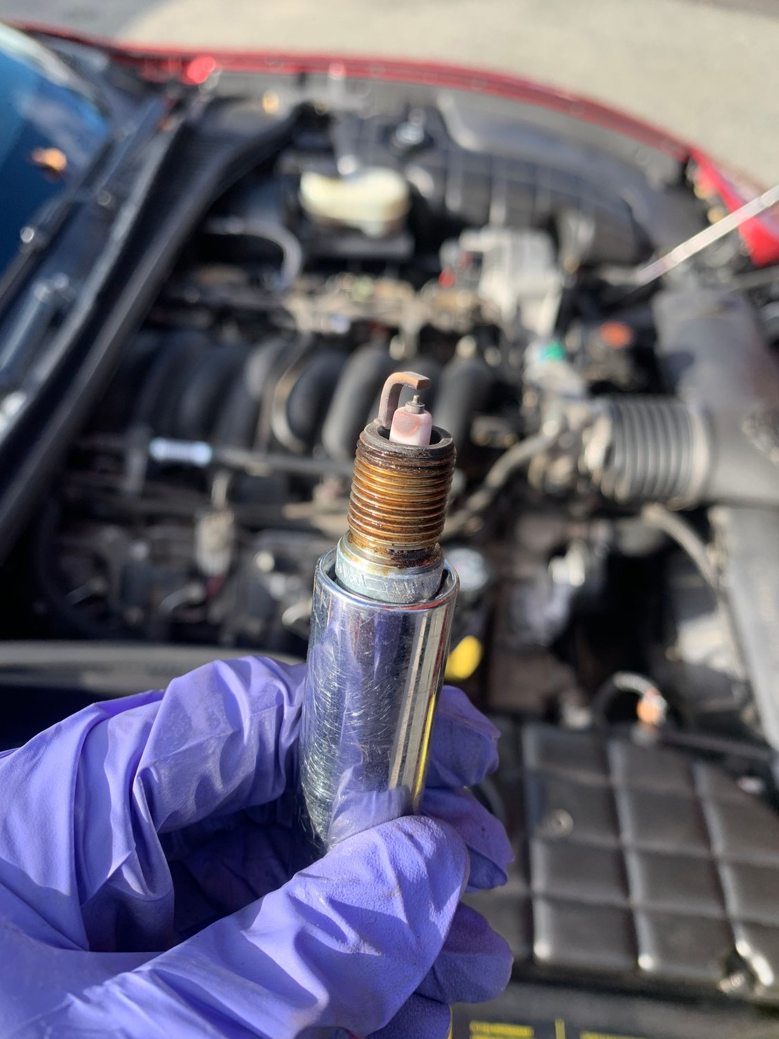

So… changed all plugs, wires, and cyl 2 coil with GM performance red wires, AC Delco coil, and AC Delco 41-110 plugs. (Not incredibly hard, some of the wires and plugs even still had dielectric grease inside) about two hours worth of work with a snack break in between.
However, when I started the car, it still ran slightly rough for about 1-2 minutes but didn’t throw a check engine light. May be worth smoking the intake to check for vacuum leak? About 35 degrees out today and both oil temp and coolant temp showed that in the DIC prior to starting the car.
Pic of cyl 2 plug attached

Got the car to misfire again this morning but did not have a scanner to check out the trims.
Sprayed water all around the intake tube and intake manifold to see if I could get it to stall but nothing.
Going to bring a scanner home tomorrow and see if I can get some shots of the trims when it misfires. Any way to get to the MAP vacuum hose without pulling the intake mani off? Just to check
