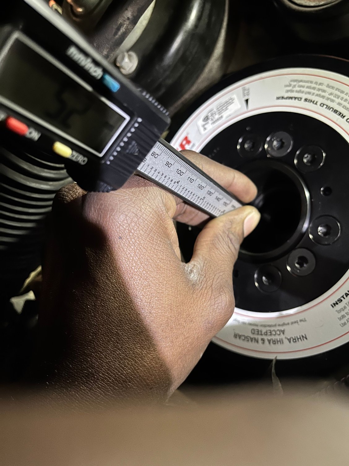

for those that installed the ATI super damper how far recessed was the snout of the crank shaft from the washer surface of the damper hub ? Mine is sitting at 5.2mm that seems right based off the calculation I did per the ATI instructions. But I could off.
I know the factory manual calls out a certain range (2.4 -4.48mm) is that range just for the factory balancer ?
I used the old bolt to seat the hub and torqued it to 240 lb ft (damn near took all the strength I had lol)

Your calculations look good. Hopefully, you installed a brand new bolt, preferably an ARP bolt, as the OE bolt is a "one time use", torque to yield piece.
