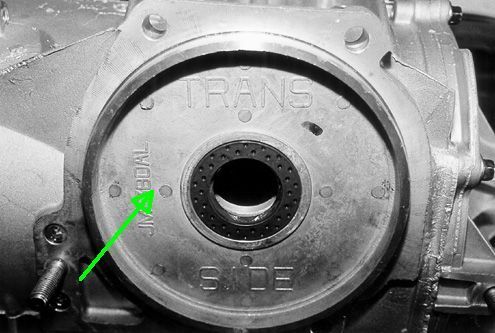

There is a seal plate that needs to be taken out of your old diff. and installed on Z06 diff
And yes they bolt up the same

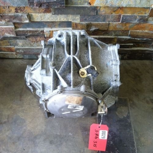

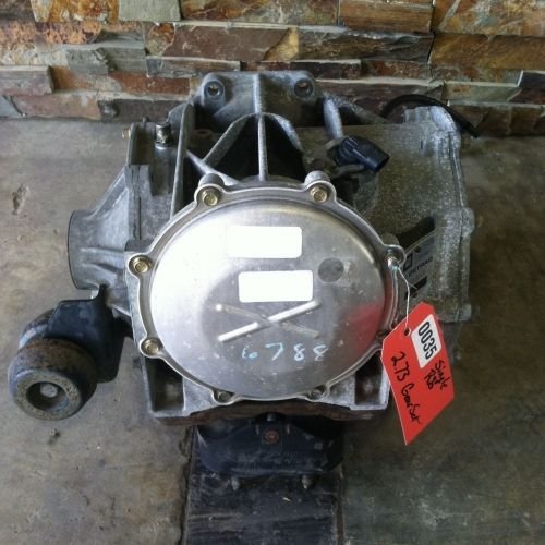

Also not all 3.42 diff's have the 3 rib case. Your best bet is to get one from a Z06 that says 3.42SP
1 rib case
3 rib case
