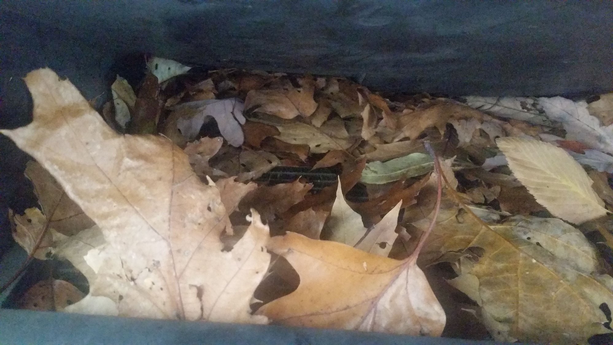

I did the same thing after a trip a few years ago to the Tail of The Dargon in the fall. Sucked up so many leaves that I had to stop at least 2 times a day and clean them out. As soon as I got home I made a screen.
If you look real close you can see a radiator under all those leaves.
