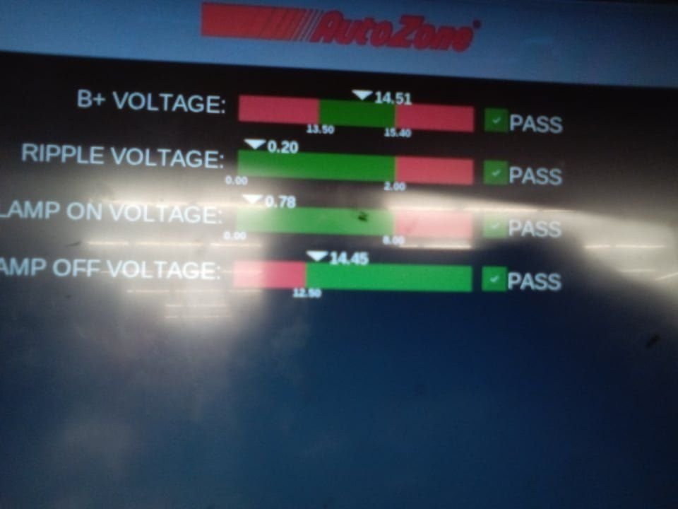

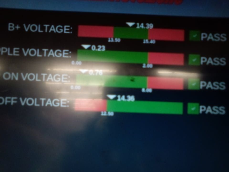

How do you check for battery draw or whatever kills a battery when the car is off. I have another vehicle im working on that supposedly the alternator tests good but sometimes kills the battery overnight after a few months of having a new battery. Also is there anyway for the starter or alternator to be bad but tests good on the autozone off the car belt tester and cause this type of issue as for as battery draw or pulling juice overnight or the couple days it sits?

Great im trying to help my friend with his vehicle kills batteries every few months or sometimes the next day. I think maybe it has a battery draw somewhere as it'll start fine then the next day not start. I tried switching alternators they still read bad on the car according to the associated load tester. Reads 12.6 volts and about 13.1 volts with the car running. I have the bosch premium reman 140 amp that tested good as well as the other alternator i had for the car according to autozones alternator tester off the car. The autozone employee suggests taking the car in to see if it tests bad on the car but one time i had a bad starter on another vehicle that would barely crank he tested it said bad battery put in a new battery and found out the starter had died. Once installed they wouldn't take back the battery they sold me according to their equipment. They told me the alternator was bad but tests on the weaker end. If i take the car up to autozone where the alternator tested 14.5 volts then read maybe 13.1 would have to be a different problem.
