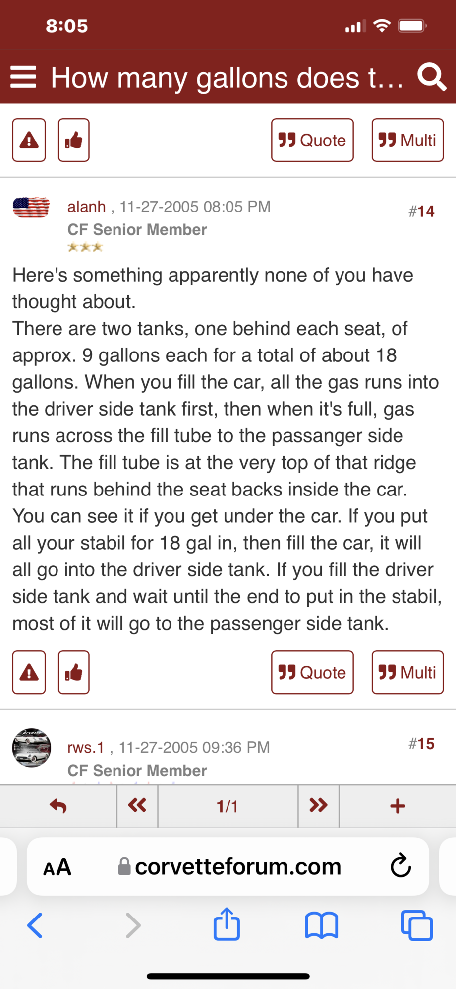

I found this old post about how the fuel tanks are filled. From that scenario I think my leak is coming from the filler tube where it connects to the tank like another person said. Fuel only comes from the drivers side. 🙏

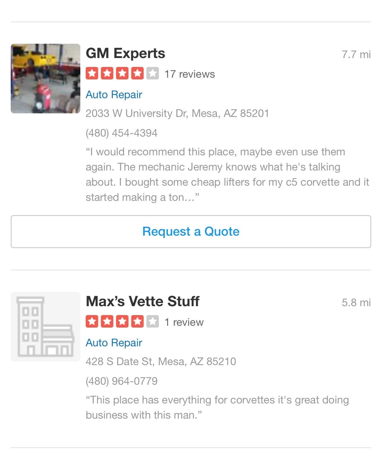

Your concern can be any number of things so we don’t want to speculate !!…Google is your friend and you can contact a Corvette Club in your area for any recommendations…found these in your town so good luck !!
