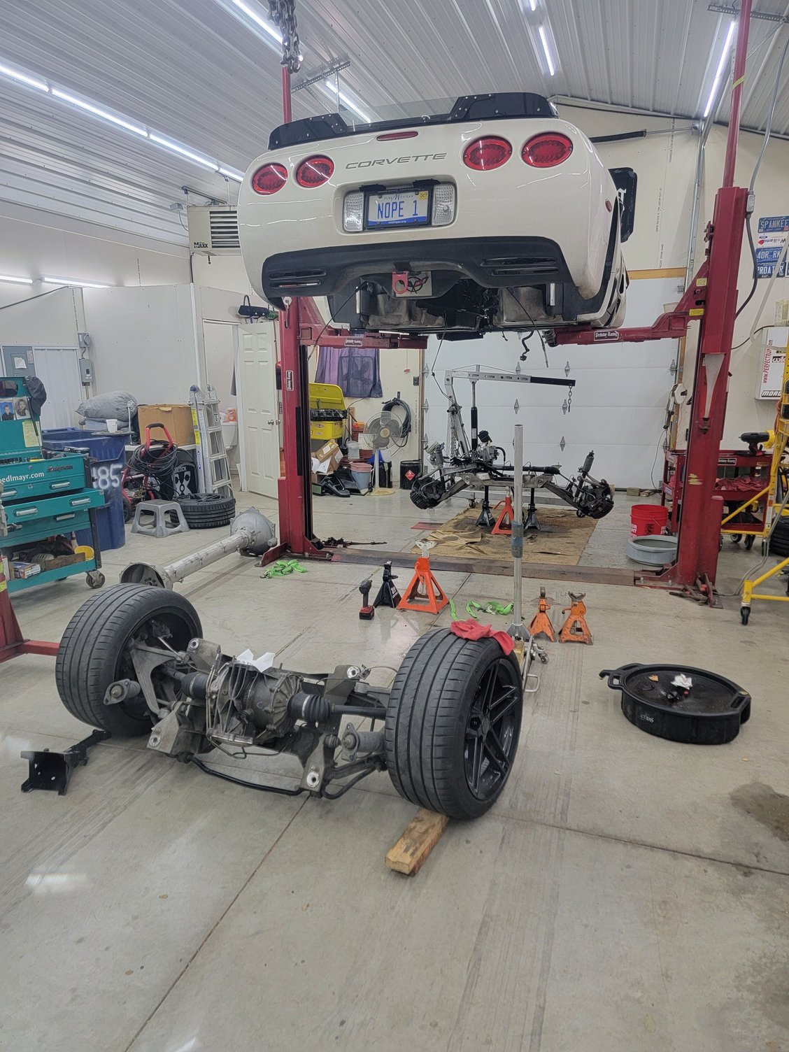

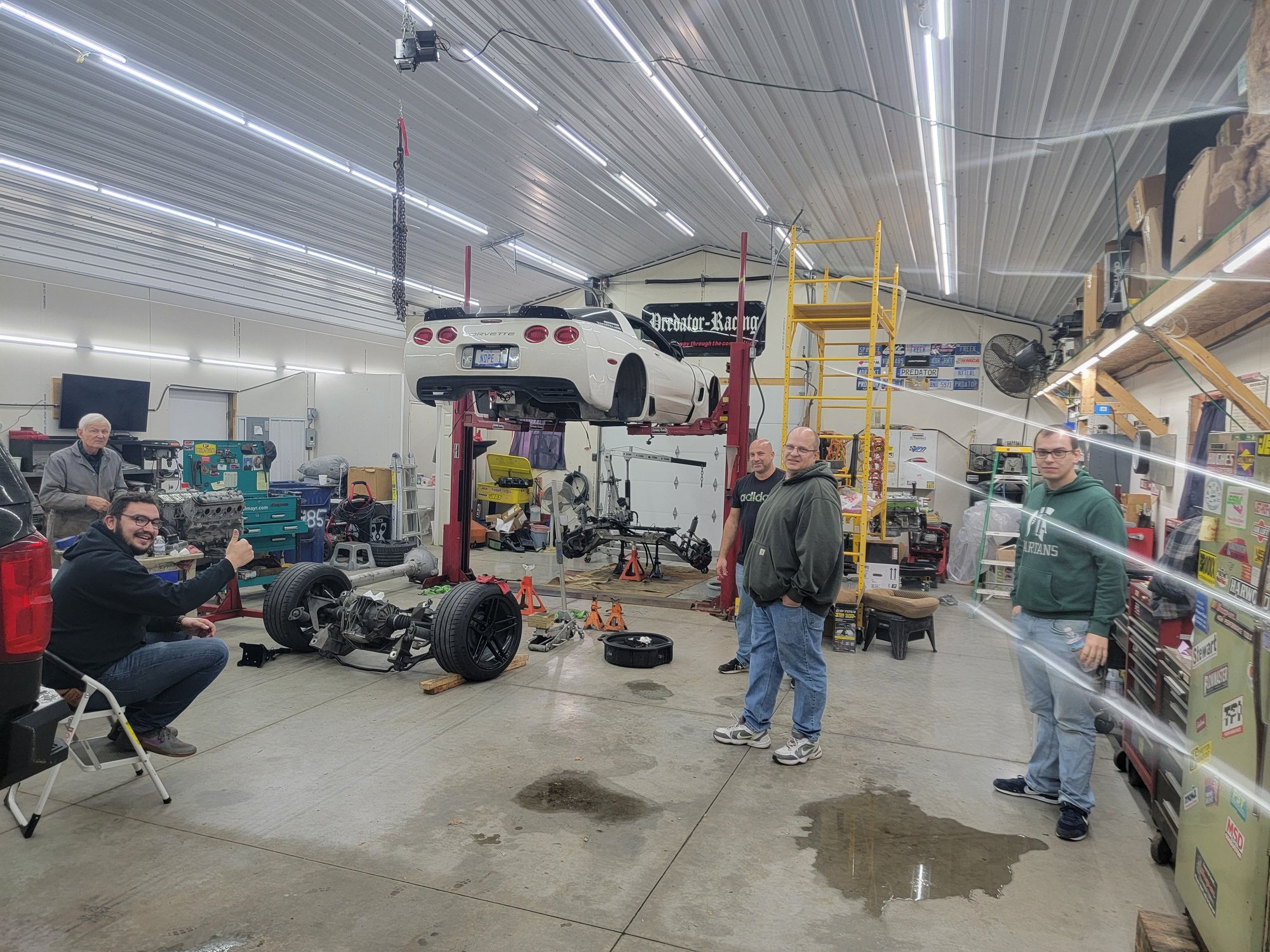

Along with the LS3 too?
Old Jan 2, 2022 | 02:39 PM
2002 C5's Avatar
2002 C5
Joined: May 2019
Posts: 316
Likes: 21
From: Michigan
I finished building that just before Christmas. If you look close by the left rear wheel you can see the red base to the original motor. And if you look close to the mid right hand side you can just see the new yellow hand crank engine stand the the LS3 is on. It's right behind the 1/2" impact.
