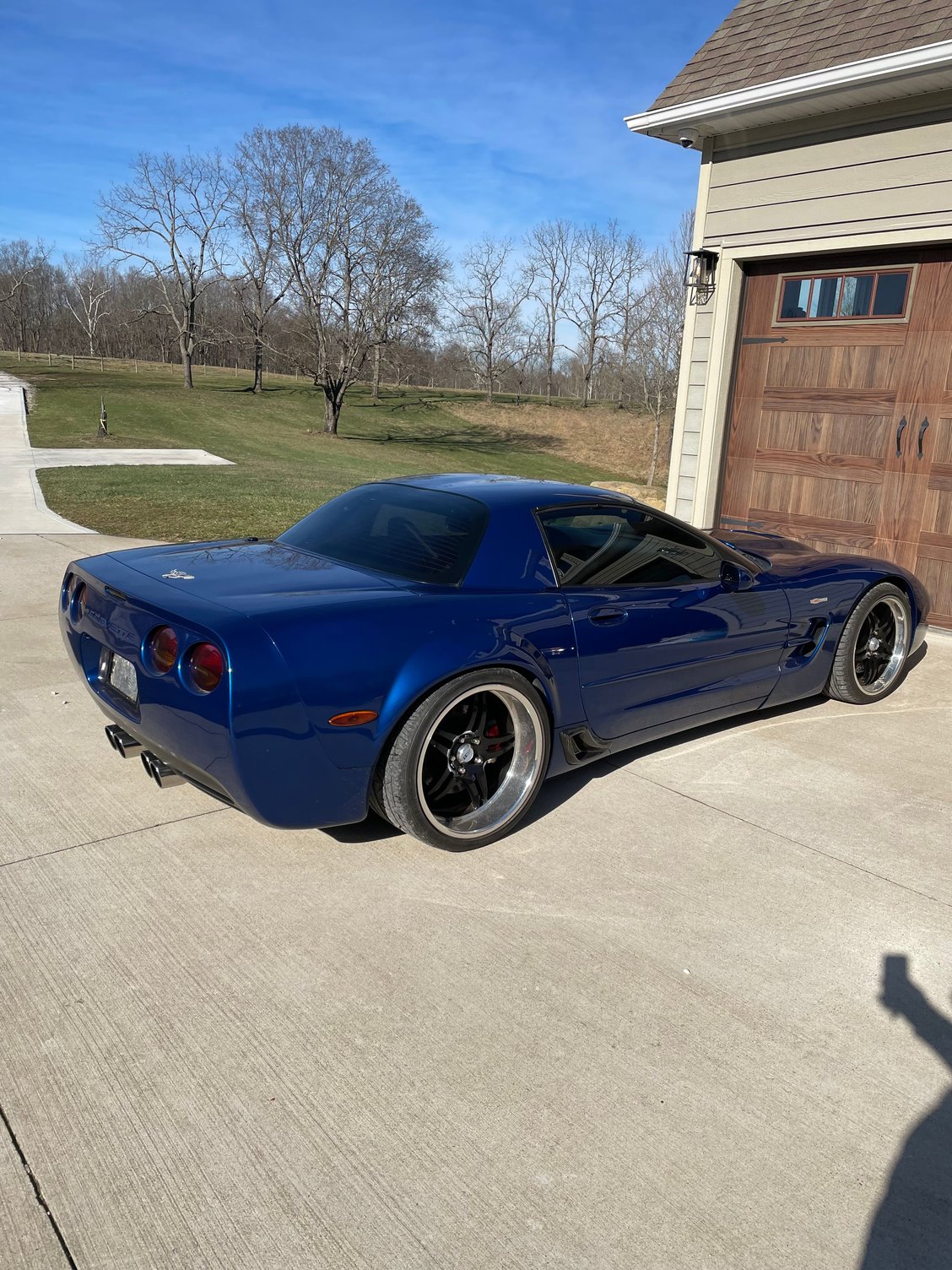

Long story short, just bought my C5Z H/C/I car back that I sold 10 years ago.
There is a very loud, bad bearing type "whine" while driving. Push in the clutch, it goes away. Let off the throttle, it goes away. Back on throttle, it whines, and gets louder as speed and rpm rises.
I am thinking a torque tube issue, or throwout bearing?
Zero noise while sitting still, clutch in or out, nothing. The car has factory clutch, and 35k miles.
Here is a YT video with the exact same issue...
Any thoughts?
