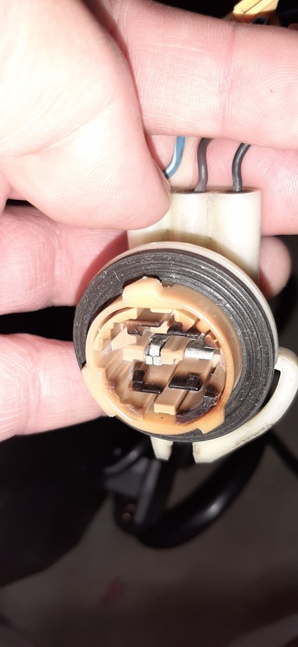

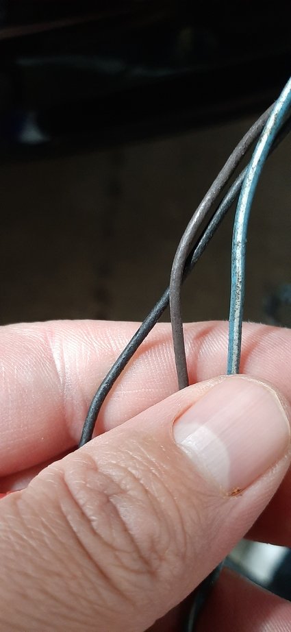

I'm returning to my old drl lights and notice the sockets are not only badly burnt but the 3 wires feel brittle anyone know the correct wire gauge?

Oh yeah it's definitely much thicker and different colors. Would be nice to find the stock style socket though, any idea what each wire does? I'm not sure which is power expect I see the ground is black. But then again I've dealt with black wires that had been powered lol.

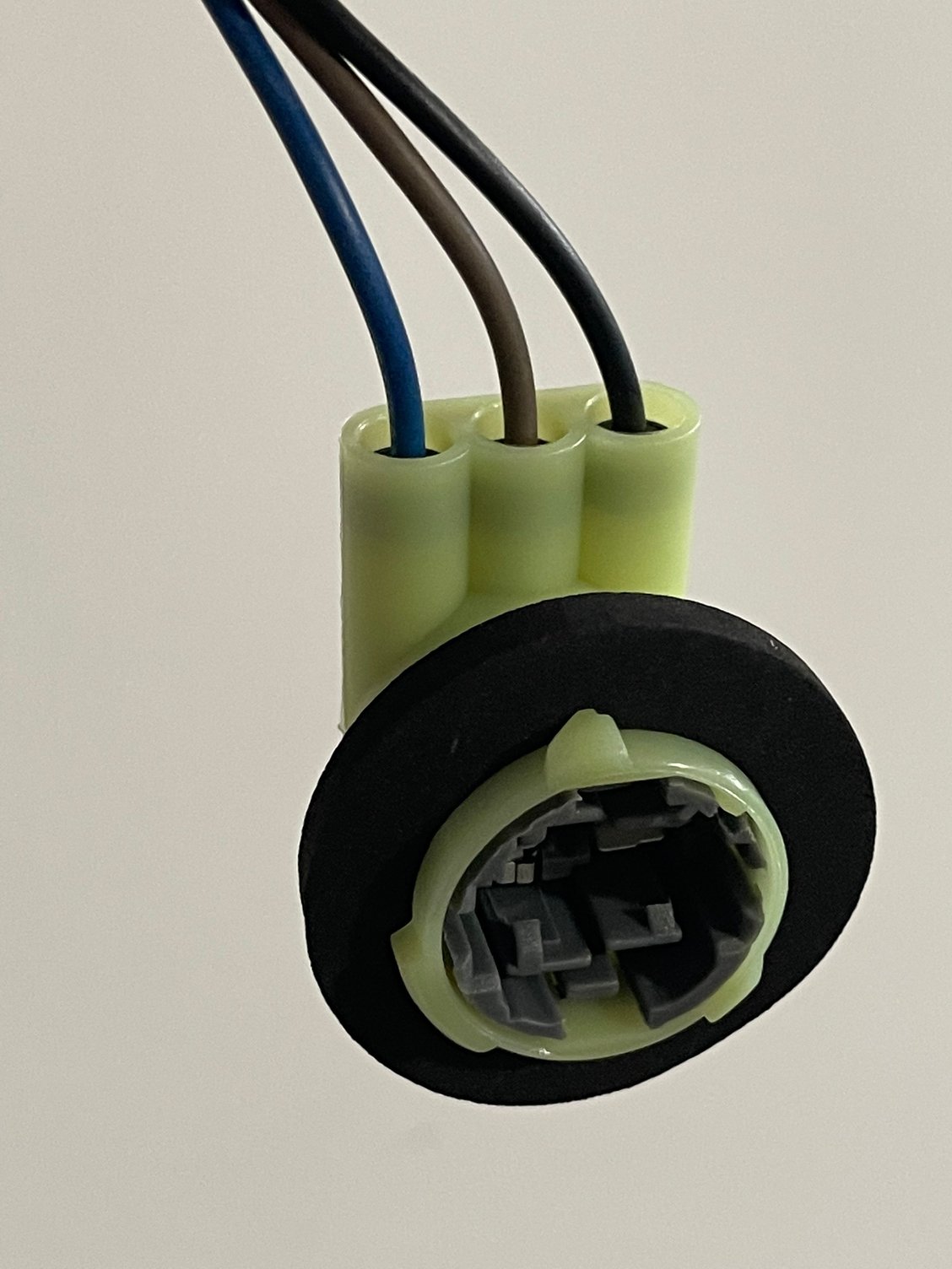

I am in process of replacing a burn socket, new lenses, along with swapping to switchback leds. I purchased this socket from Amazon
Amazon Amazon
The wires were correctly color coded and they popped right in and locked into place. The only thing I found is the gasket is thicker than oem and I needed to use a bit more pressure to compress it fully before locking into place. I soldered the connections and used heat shrink tubing to finish it off.

I am in process of replacing a burn socket, new lenses, along with swapping to switchback leds. I purchased this socket from Amazon https://www.amazon.com/gp/aw/d/B000C...b_b_asin_title
They were a good fit and am happy with the quality.
thanks but those color wires are different than what Is on my car.. maybe certain years had different colors? Will take a picture of mine tonight

Mine is a 2004 base. The black, brown and blue wires were a match. I have one side done and everything works as it should.

Yep your socket wires are larger.

I found this socket with the correct wire color
Amazon Amazon
Anyone know what each cable represents?

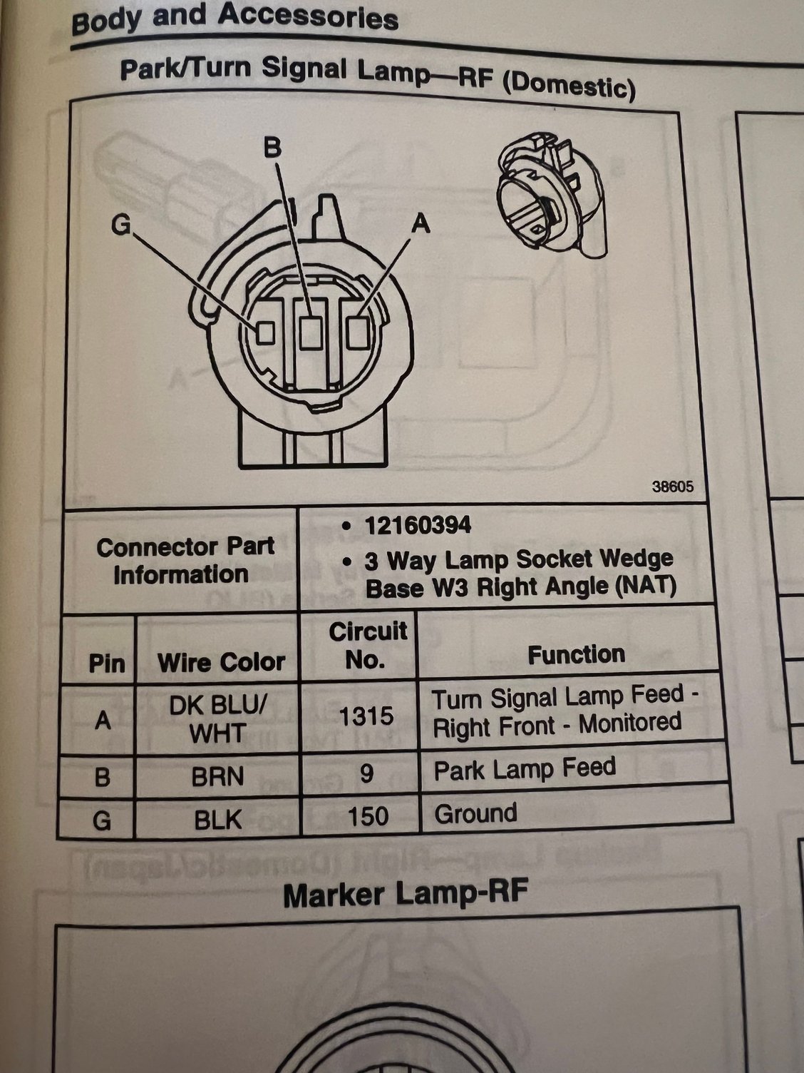

I wouldn’t worry about the color so much but worry about the gauge size…according to the factory wiring the black and brown wires are 22 gauge and the dark blue/white is 18 gauge…yes, solder the wires and use resin filled heat shrink !!
THANK YOU!
I have the 3 repair books and completely forgot about them as I only used it once a few years back lol. I will try to get the same or similar gauge wire for the socket but is the wiring pin and colors the same for all C5? I have a 2001

Originally Posted by My Vette Life
THANK YOU!
What I posted is from my 2001…something like PCM pin outs vary some from each model year..normally the wiring pins and colors are similar each year as well as gauge…and it’s always better to go with a bigger wire to be sure it can carry the current !!
