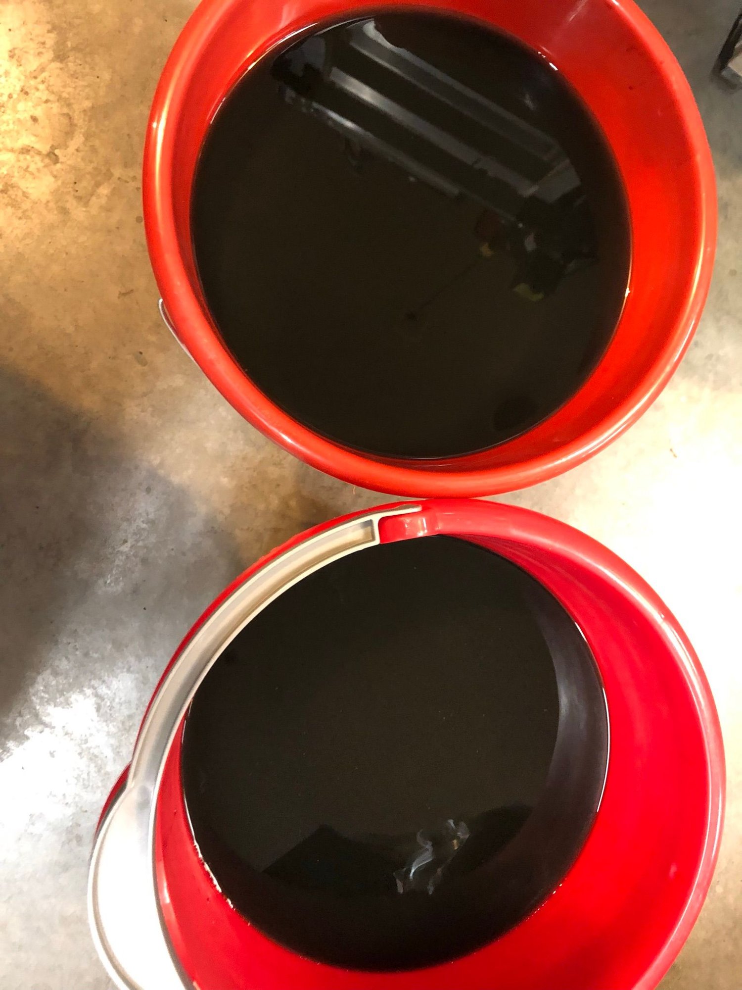

Read the article I posted yesterday, it will help you understand your vehicles cooling system; what time it was designed to run at & how the fans are designed to work. You will be surprised at the temps the engine was designed to run at, & it was all done in the name of better emissions.
Also consider taking the vehicle to an SAE mechanic. Better to have a vette running properly than listening to the wrong people & chasing your tail. Often if an engine that isn’t running correctly (timing off. Compression low, etc.) the engine will actually run hotter. Finally consider using “Thermocure” at some point in time, you can find it on Amazon or most auto parts stores. It dissolves the rust that may have built up in your engine block over the decades. I have done this on numerous old (pre-50’s vehicles & have been impressed with the results.
When rust is desolved it turns black with the Thermocure. This tells me it cleaned out a bunch of rust internally. Rust will not transfer heat as well as bare metal & thus will causes your engine to run warmer. It’s a good tool to add into your arsenal in keeping your vette running its best.
