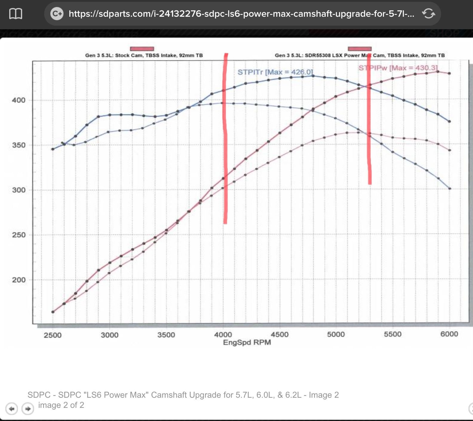

Here’s a dyno sheet on the LS6 Power Max cam from SDPC. More exhaust duration and a bit more lift. Note that this was done on an engine dyno with headers, but not required at this stage…
It demonstrates the mid-range advantage over stock.

I agree with your advice-EXCEPT the cam and springs. Let's say the LS6 cam and springs come to $300.00, as you've stated. IMHO, the OP should go to a slightly better cam. For a cam, for him (not me, I'd go bigger yet!), I'd go with a 219/228 GM "Hot cam". As you stated, the labor is the expensive part. May as we make a real difference he'll feel SOTP. The LS6 springs should work fine with the Hot cam. If the OP is going to fork out $1k for cam swap labor, I think he'd be a lot happier with the Hot cam. Just my .02........
Some good points!
Still, he has an A4, so he needs to consider that a more aggressive cam may require a higher stall converter, another couple grand. In addition, a bigger cam will want headers, another couple grand….
I was approaching the OPs intentions from both budget and overall performance. With the additional expense mentioned, he would be in supercharger price ranges. Just depends on his budget and how far he wants to go.

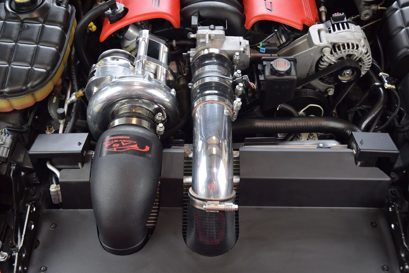

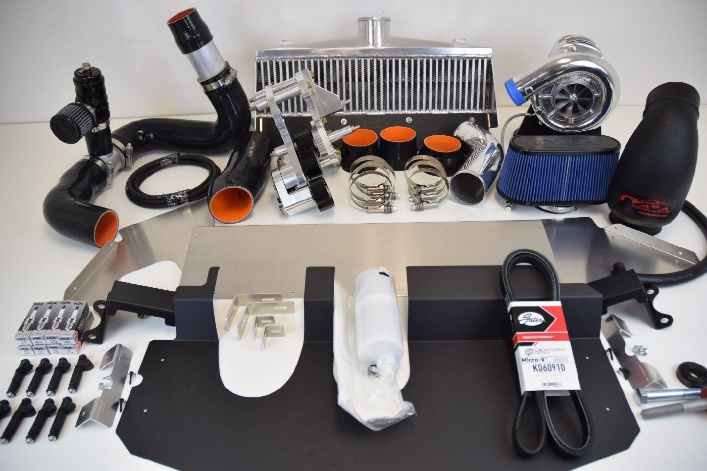

Went down the rabbit hole, you are thinking about. Short answer A&A C5 supercharger and good tune. The ultimate weekend cruiser. No headers, no mufflers, no 3" exhaust, no stall converter and cooler. no rear differential, No extra cold air intake. And all the extra thousands in labor to install. Just POWER.

Was thinking about it but it's almost double the cost right? You mentioned no extra cold air intake, however doesn't the A&A supercharger cut up and into the radiator shroud? Also, since I'm planning to install a new Dewitts aluminum radiator and fan kit, I would need to exchange for the lower rise unit to accommodate the supercharger correct? I'm currently running a Callaway Honker CAI and would like to keep using it if possible but per the kit pics on the A&A website, apparently that gets replaced with their own intake and shroud. How about the Supercharger and 3.90 rear gears? Or would that be too hard on the A4 transmission? Current kit is $6K + Install + Tune.
