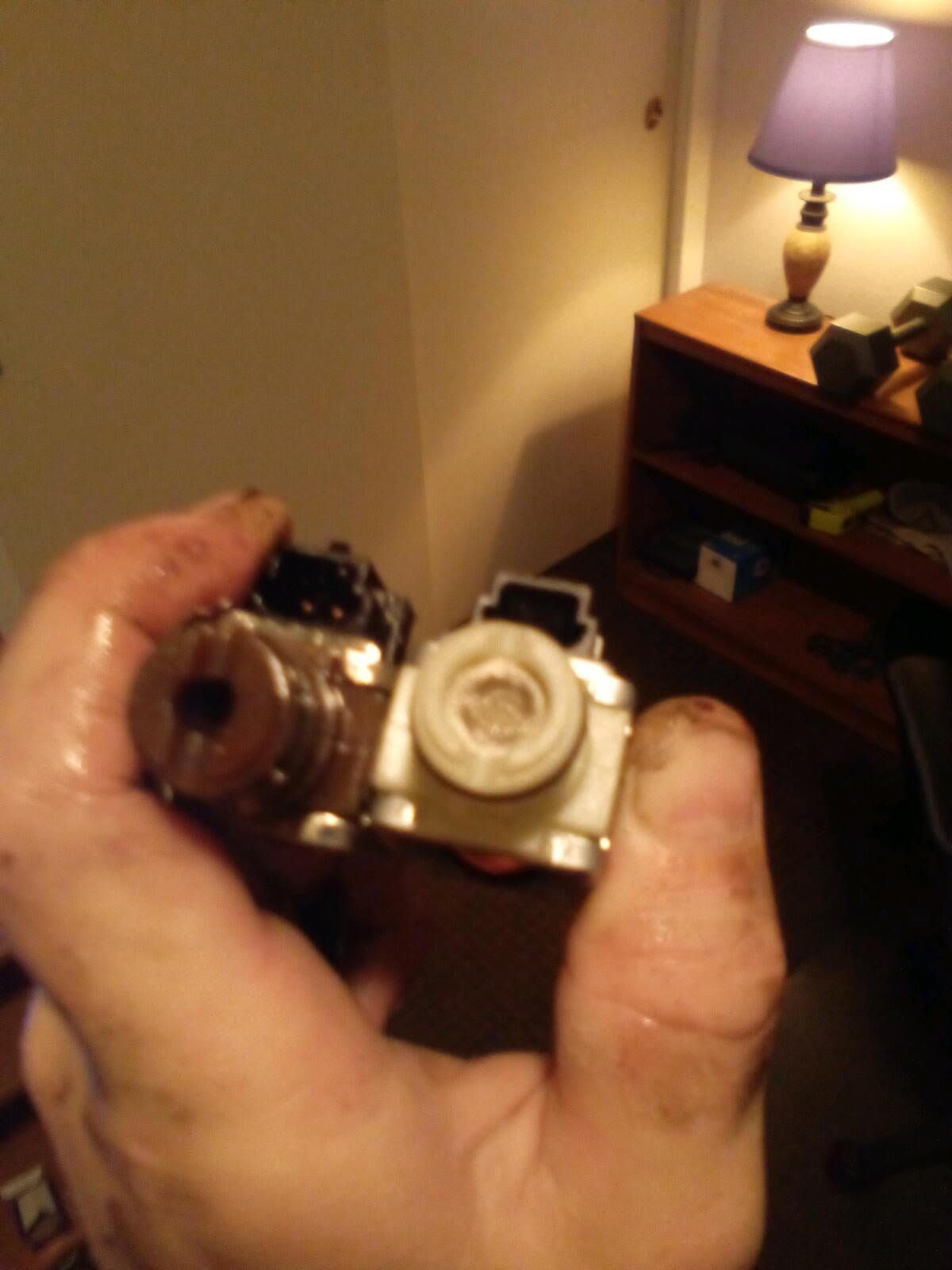

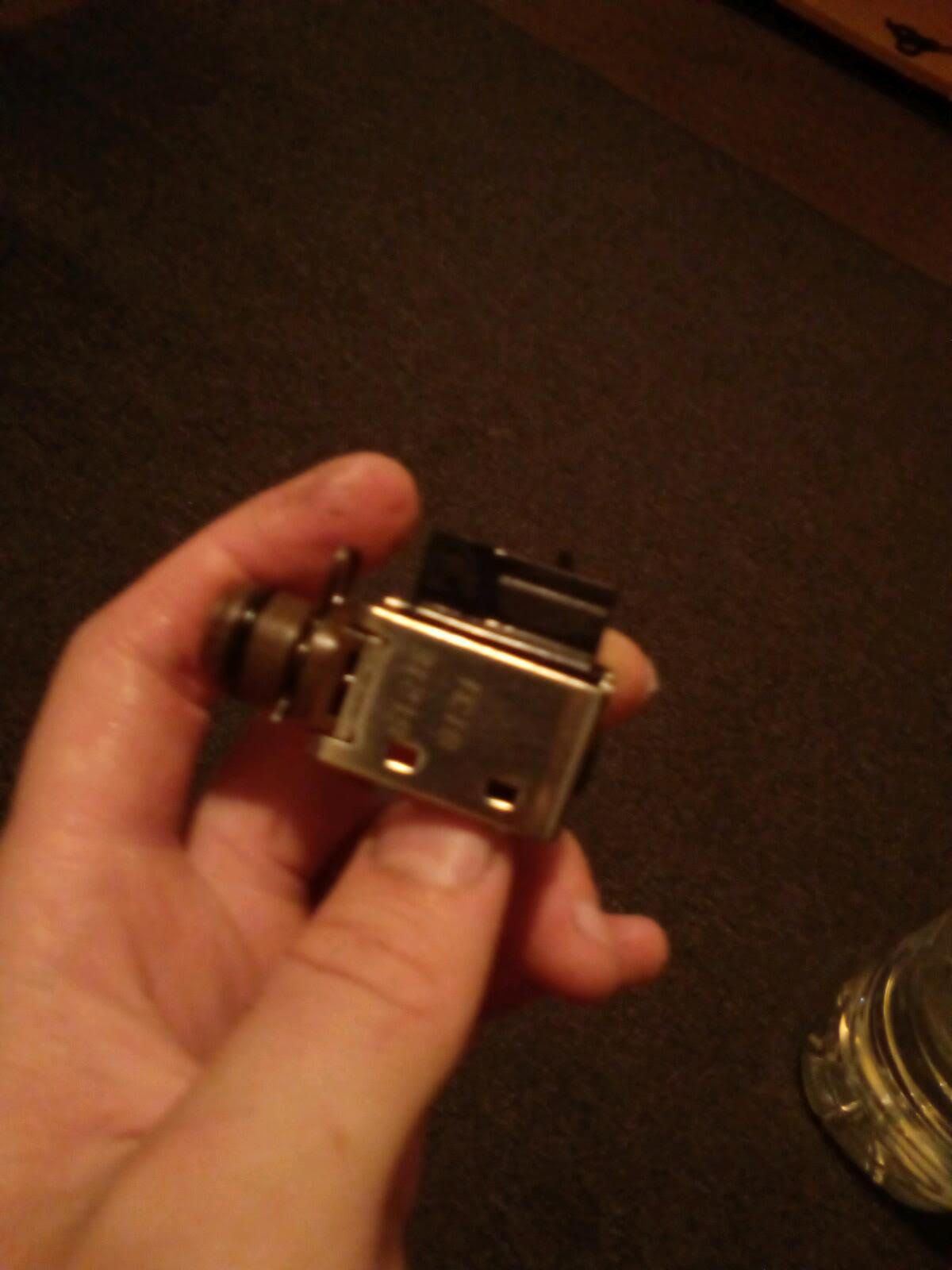

So what are you suggesting pcmofnc who said they were confident as the cam is pretty small and alvins one of the best tuners in that area or a local lsx performance dyno shop thats been around for 13 years. LOL you sure the local shop will adjust the 4l60e before tuning it or WOT see where its at then adjust the tune? Id have to drop the car off for 2hours and 450$. It ran good with the tsp headers but ive only WOT it a few times never 1/4 miled just yet did one manual 2-3-od shift from 30-130 one time and thats it. The engine and trans felt strong.
How many passes have you made on the stock c5 stock 4l60e? Local transmission shop said it was same internals or rebuild as 700r4 and reg 4l60e transmission. Not sure why the corvettes is different other then a corvette servo and from what i seen the original no screen shift solenoid have you ever seen one? I had to replace one of mine with a standard 4l60e shift solenoid as the copper wires and cap were broke when changing fluid and filter when i bought the car. It had the stock style white filter im assuming original vs the metal style filter i replaced it with from autozone. I had asked a question on here regarding this and was never able to find the same part number that the 99 corvette solenoids say. I had to go with a screened shift solenoid. Any idea if the no screen style shifts faster? LOL let me know if anyone has seen the c5 shift solonoids i didnt remove the other one but the one i did remove had no screen and both were the same part numbers that i couldnt find a replacement with the same part number.

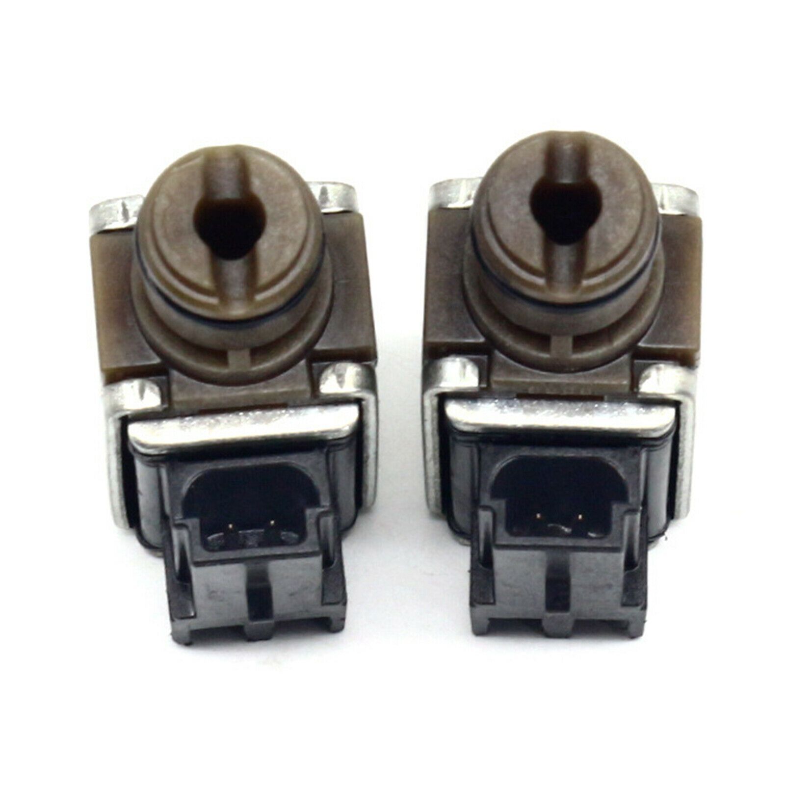

One thing i did find is a shift solenoid similar to the original 8131. Its bundled up with the rest of the solenoids on ebay for 60$. Im curious as amazon and gmpartsdirect as the screened above pictured solenoid listed above for the 99 corvette. I may trying finding one that doesnt have the screen seems it would allow for more fluid flow. Only thing is this is unbranded chinese but does have similar 8131 part numbers. They list it on ebay for 04 corvette. Seems its a big difference from the standard 4l60 solenoid. Metal 4L60E Trans Master Solenoid Kit Rebuild EPC Shift TCC 5pc For Pontiac | eBay
I may stop by the local gm parts dealership to see what they have as the replacement solenoid and part number listed for 99 corvette.
