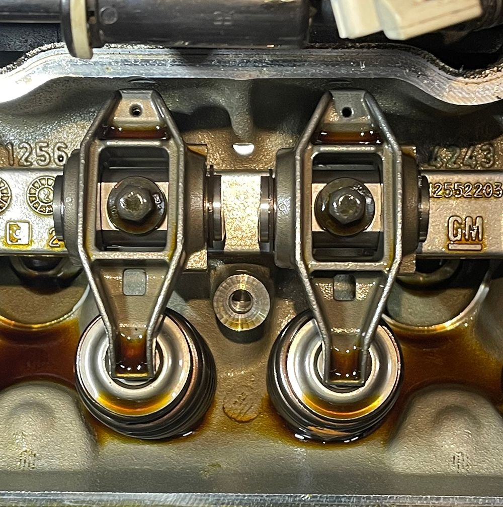

Noticed one of my rockers are slightly off centered. Should this be off concern?

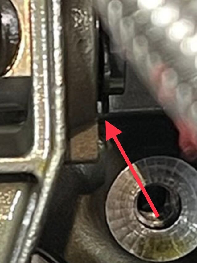

I'd say yes, it's a concern. You can see angular clearance between the edge of the rocker and the circlip, which to me says it's not sitting square on it's needle bearings. If that's the case, then the bearings are fucked, and could start shedding debris into the engine.
But that's just my guess.

Those are trunions

Yes, I know. And between the trunion and the rocker are needle rollers. The rockers are supposed to be coaxial with the trunion. If they are not, then something has worn, and that's usually the needle rollers. It appears to me that the gap between the circlip and the side of the roller is not parallel, but angled. Hence the rocker is not coaxial with the trunion.
Or in technical engineering speak: If your rocker is on the ****, then your bearings are shagged.
