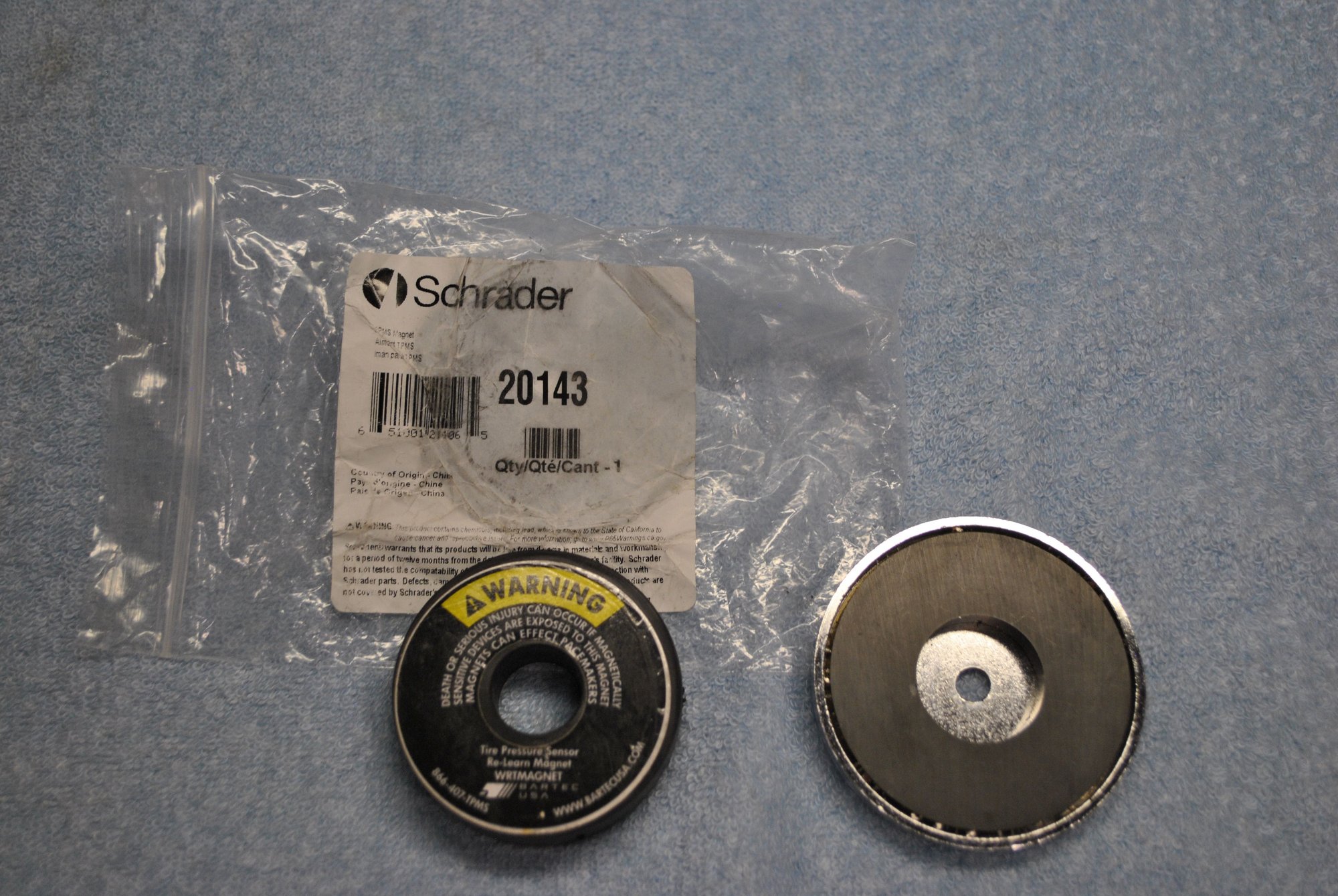

This is what I used to "wake up" the sensors......
I used the Schrader magnet, as well as the "hardware store magnet", too. I also placed the wheels/tires next to the left rear of the car, near the gas filler, during the process, as that's where the TPMS antenna is located. It made the procedure go quicker and easier. After being "recognized" by the car, I put the wheels on the car.
