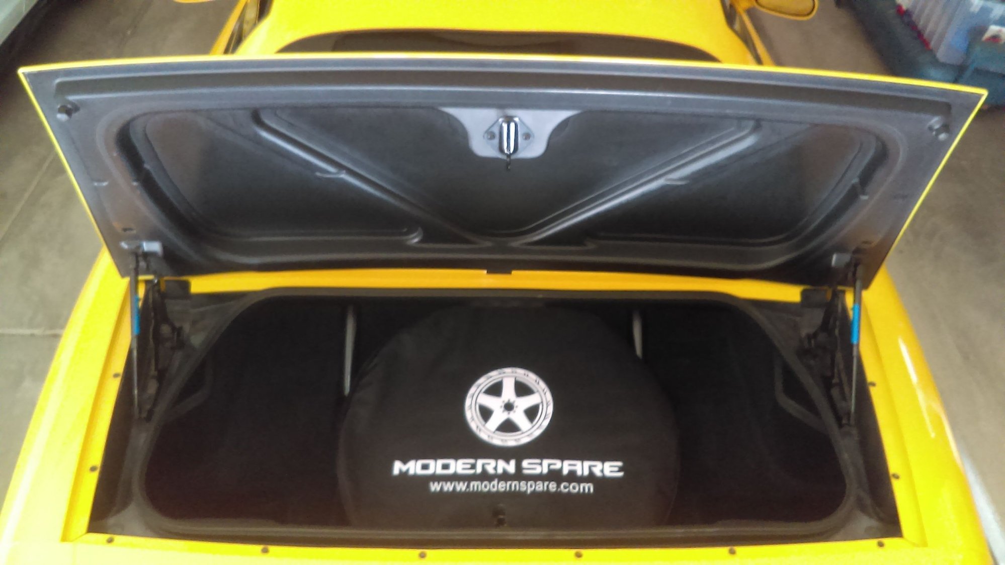

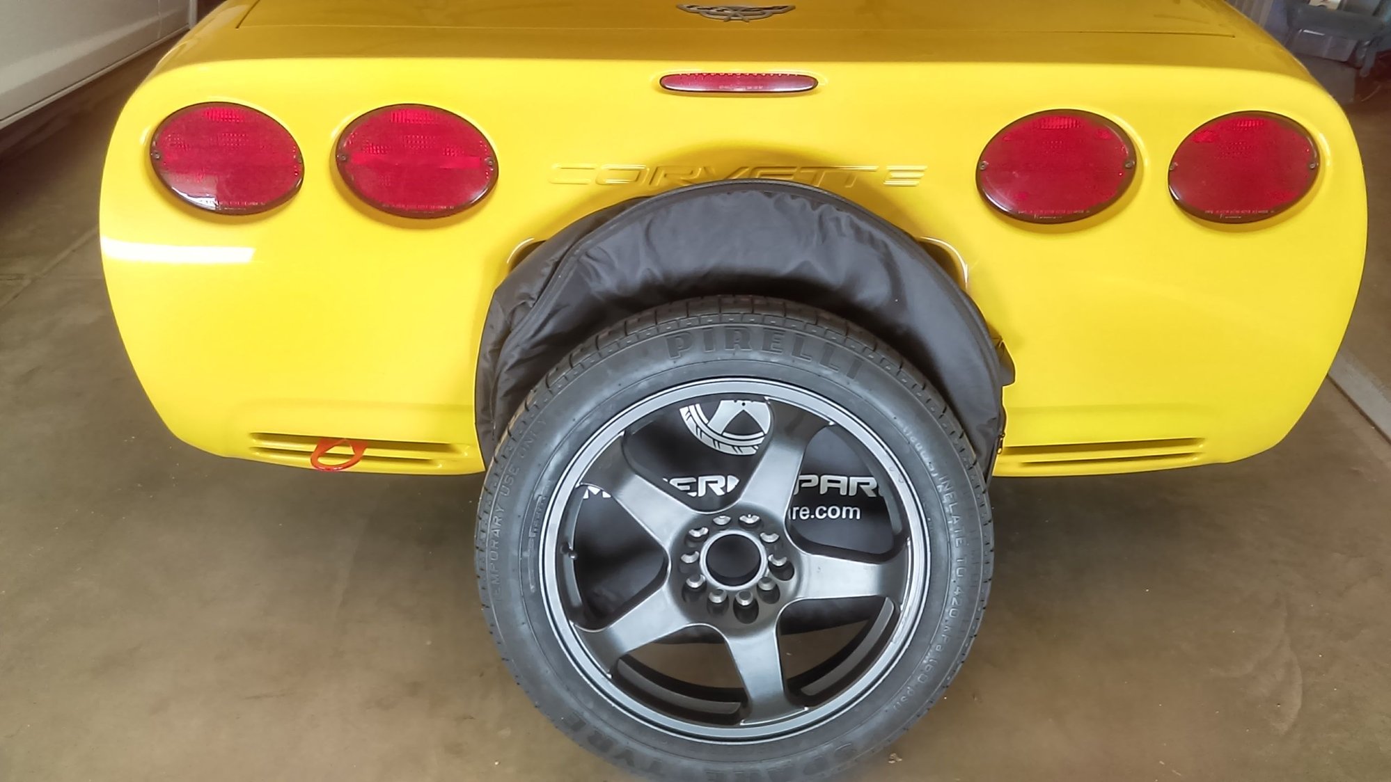

This is what I have. Modernspare.com
Fits great in my Z06.

That is a really nice tire spare tire set-up i see if includes the spare jack and accomodations for the right price. May i ask what dual bolt patterns you got yours with? GTOs are 5x114mm which are nice spares and front runners but wont fit the corvette 5x120mm. Real curious about the dual bolt pattern option you have going on there. If theres anyway to get a spare with oblong bolt pattern in 17" similar to the old classic cragar dual bolt pattern wheels thatd be great. May look into a set of black race stars or whatever option skinny front runner fits the front of the c5.

I haven't really analyzed the bolt pattern, they obviously make this as a universal fit for several vehicles. If I recall, it is about 26.5" tall. I know there is some debate about Posi Rear function but I think for a temporary measure the risk of damage is minimal. GM supplied dinky-donut spares for many, many years with a wide array of vehicles. If damage was occurring you bet the many different forum participants would be calling out for vengeance.

If you're going to be driving a lot I'd say get the entire kit (jack, tools, bag etc.). I think it comes in under $500. I've got a roll bar that keeps the tire secure, in a coupe you'll need to get creative to keep the tire in place. As mentioned in other threads, you don't want to get wacked on the back of the skull in an accident.

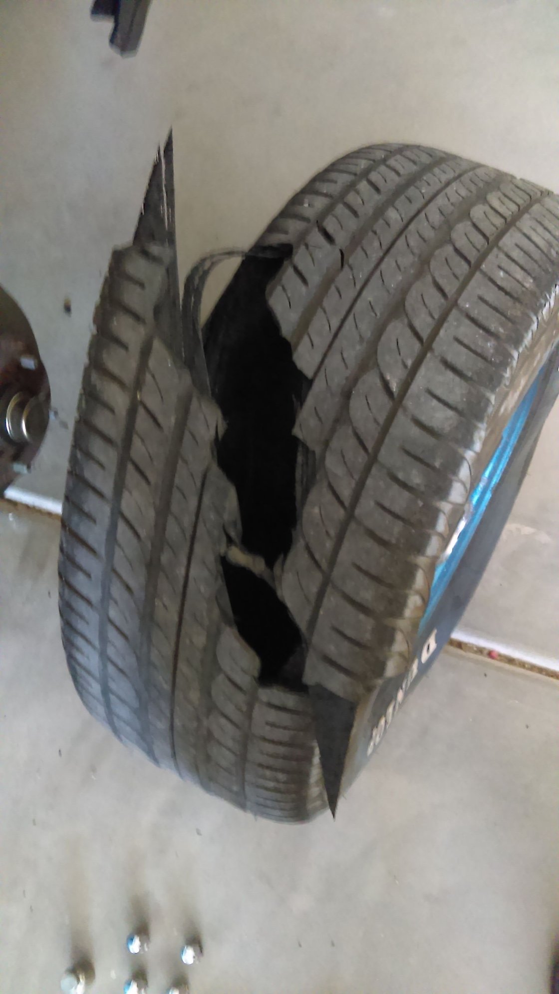

This is why a spare tire is needed as opposed to a can 'o goo. Old tires (plenty of us out there with old tires, you know who you are!), hit a chunk of something on the road or just bad luck. Down here in the Az intense summer heat tread separations happen, often without warning. This was a 15 year old Dunlop GT Qualifier on my '71 Olds. Luckily it blew up in my garage. Neighbor thought a bomb exploded.
