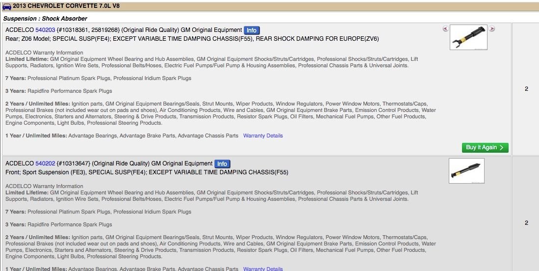

Here are the part numbers I ordered from Rock Auto several years ago and have been running them since.
Perfect . Did you get any code after install ? And is there any different you feel then the original one ? All l knew f55 it's Magnetic shock no need to program right ?
