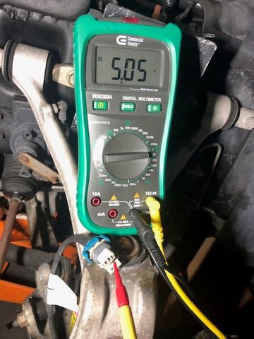

Never heard of a 1001 code...is it a U, B, or C DTC ??...how did your Tech diagnose that it was the sensor ??...I bet he just changed the part just by the code...it can be the hub/sensor, or wiring... the WSS puts out an AC voltage so spinning the hub fast you should see around 1 volt AC...also there is a short harness that connects to the hub so that may have an intermittent connection...have your Tech swap them over and see if the fault moves to the other side...also the connections should be closely inspected for loose or damaged pins...one of the 2 sensor wires has a 5 volt bias on it when disconnected so he could shake that wire down to see if the 5 volts disappears if there is a wiring issue...that would be the white wire for the 5 volts…to check the other wire he can disconnect the connector at the EBCM and do a resistance check on that circuit possibly for an open. He SHOULD be using a scope to check for any drop outs in the signal.I’m moving this to Tech.
