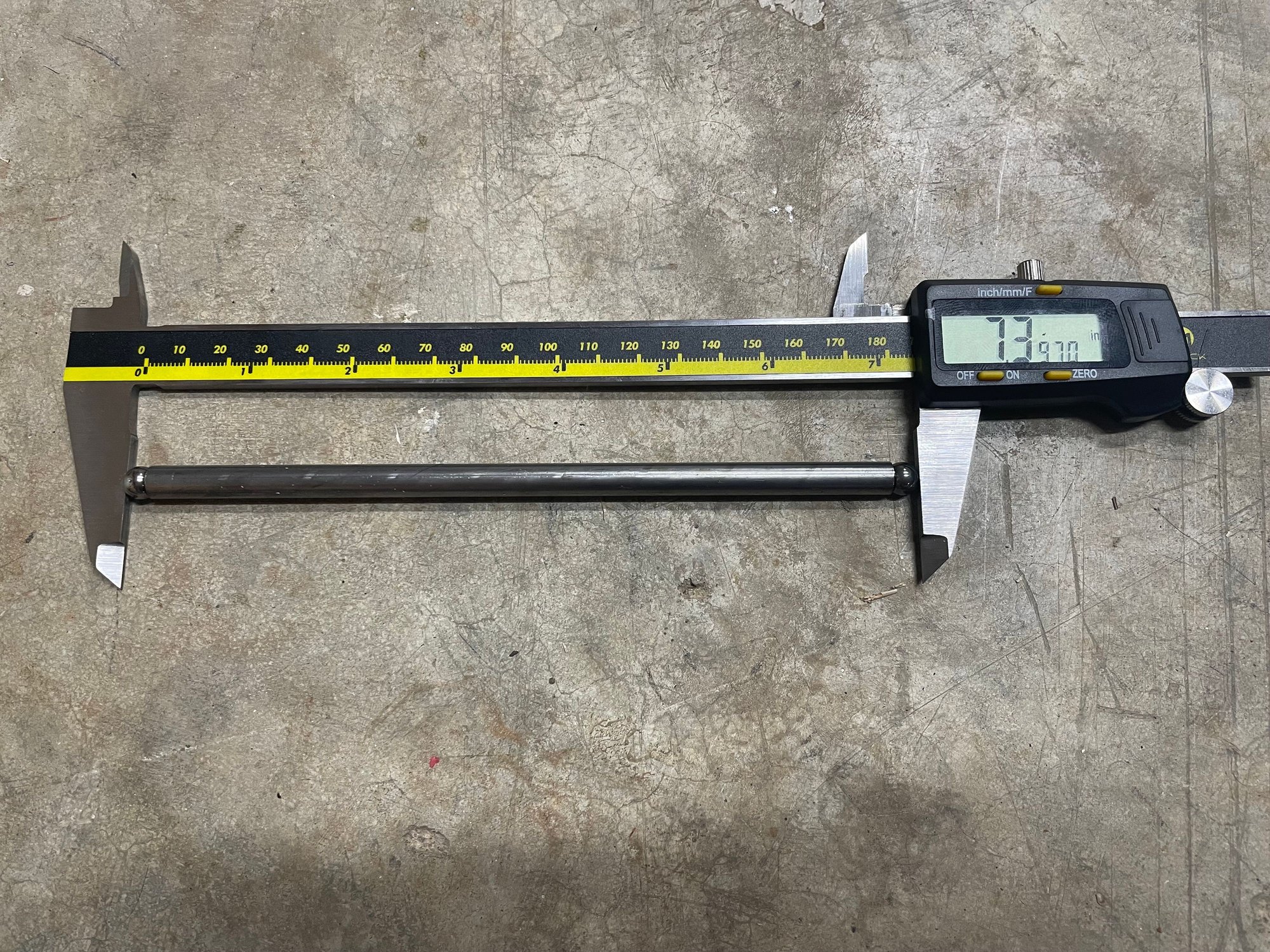

I had already purchased some Tick 7.400" / .080 hardened rods which came with the cam kit (with the understanding I may need different ones). Here is my first issue. The Tick pushrods seem longer than 7.400"
I used a stock pushrod without zeroing:
And here is the measurement tool. I calculated the 11.5 turns to be 7.375" but when I measured, this is what I got:
My second issue is that with the Tick 7.400 pushrods installed, they almost feel too long, like they may be holding the valve open. Turning the motor by hand, it felt like it was getting really tight with that pushrod installed. I put the stock one back in and it felt better.

Use EOIC (Exhaust Opening, Intake Closing) to find where the cam needs to be. So when Exhaust is opening (pushrod is coming up out of the hole), you will measure for your intake pushrod. When the Intake is closing (pushrod going back down the hole), you will measure for your exhaust pushrod. As said earlier, use the checker to find 0 lash on a hand tight rocker. I use teflon tape on the internal threads of the checker to keep it from turning too easily. Once you get close to 0 lash, then measure the checker and adjust it a thousandth of an inch at a time (0.001") until you reach 0 lash. Once you get there, add the lifter manufacturers desired preload. Call manton, trend, smith brothers, whoever.. tell them how you measured and the setup of the car and they will get you what you need within a couple thou.
