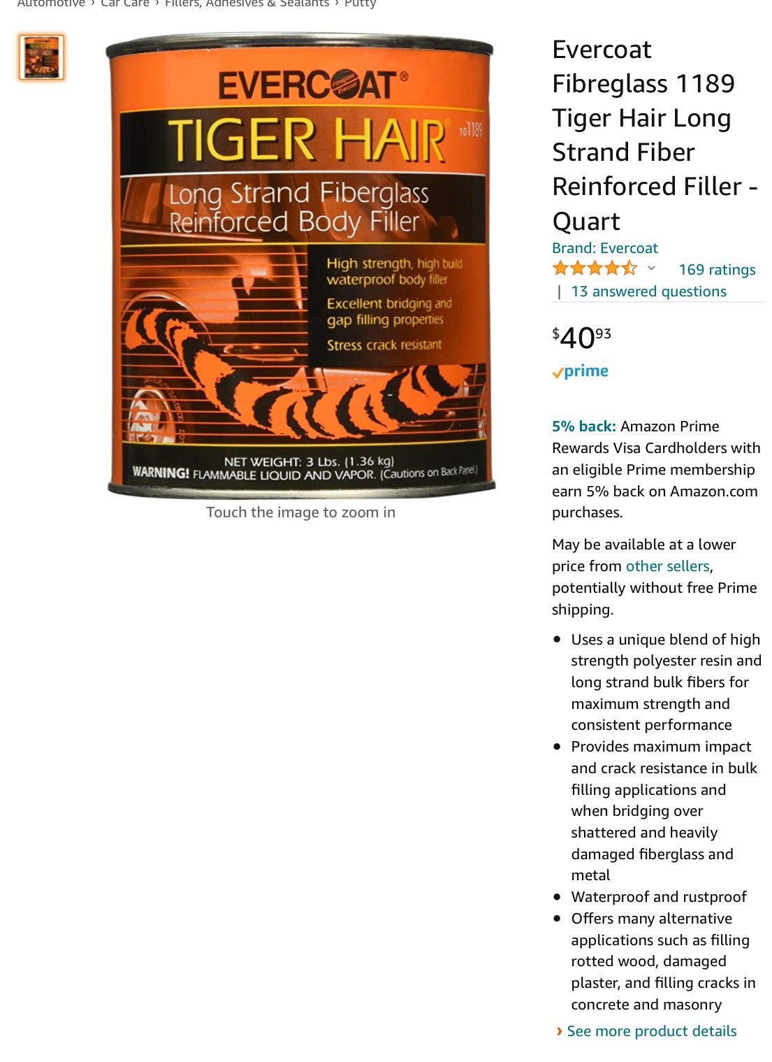

Tiger Hair is a polyester based filler containing fiberglass strands. We used to call it something-else hair, but the point is it hardens like rock to fill odd sized holes and shapes. Now you’re not going to need a gallon, and there’s other brands. A marine hardware store is a good place to find stuff like this.
Just globe it in, let it kick off, and grind off to shape. Then a thin coat of bondo, etc and prep for paint.
Fiberglass work is messy sticky, but it’s really not difficult on some small pieces like your looking at.
