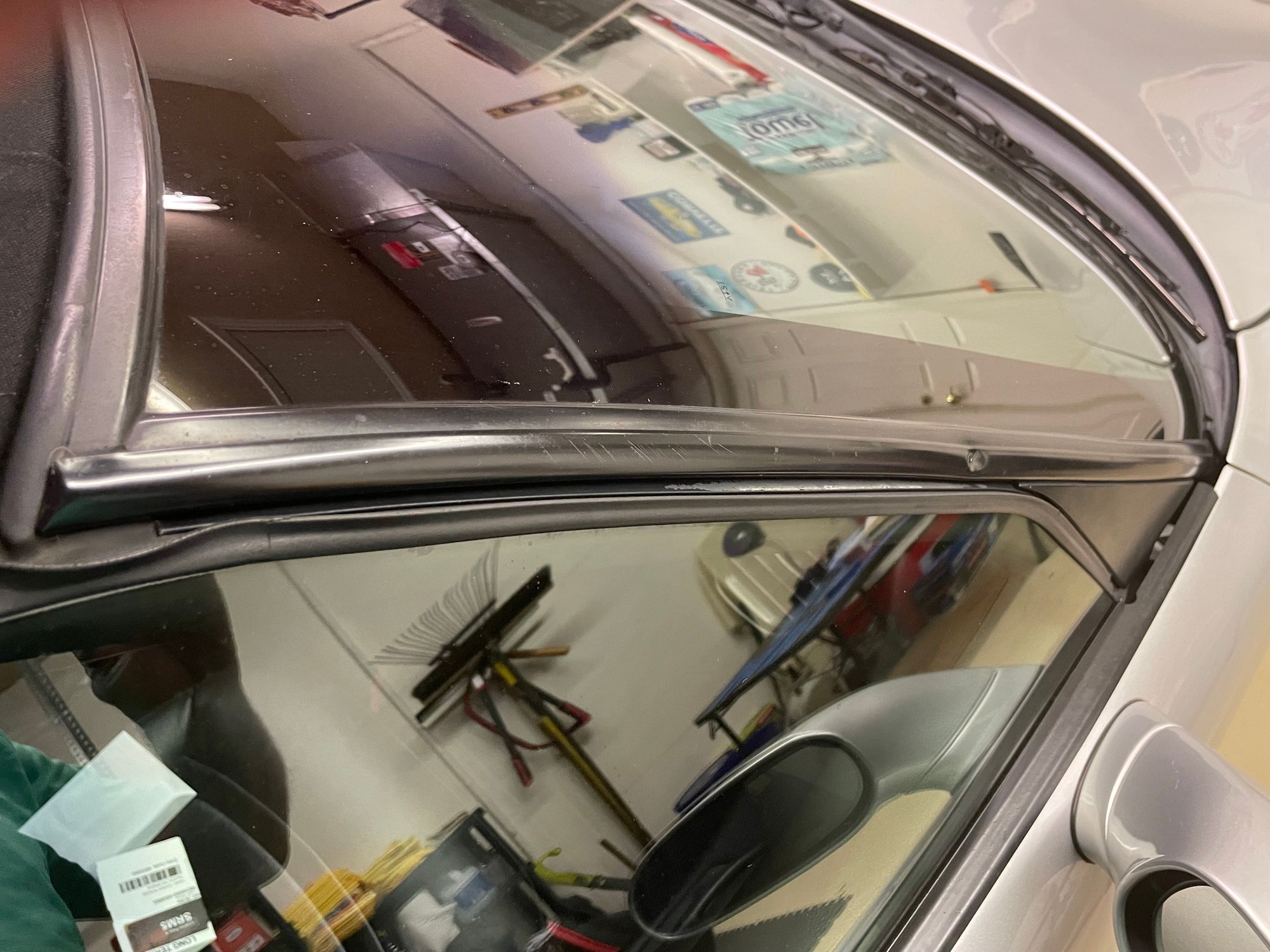

Need to replace moulding along side of windshield. See picture. Anyone have experience with this replacement to offer steps to accomplish it. Thanks.

Here's a video I made of the process. One thing I'd recommend though is to start the very bottom screw first and then work your way up. When I finally put the bottom screws in mine I had to take the others out to get that one in. Hope that makes sense.
