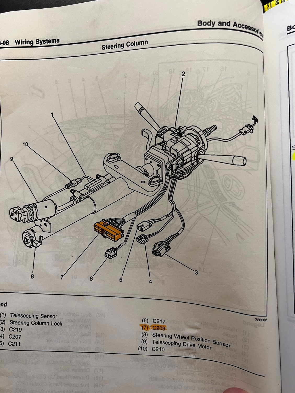

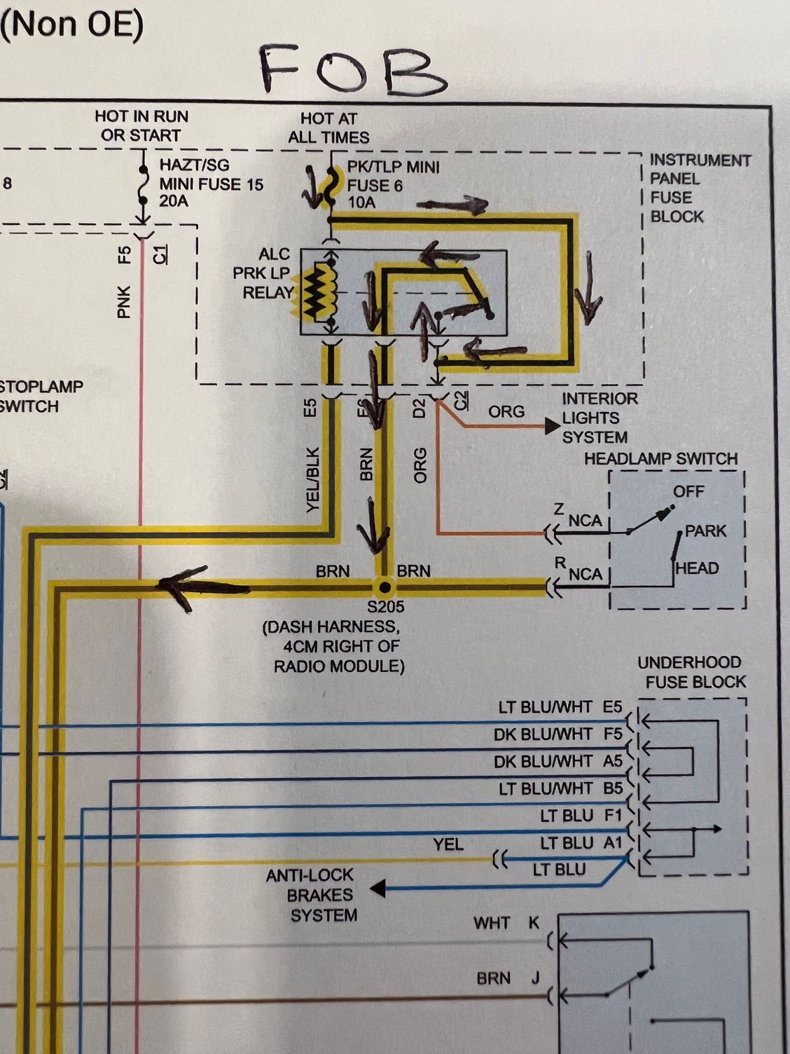

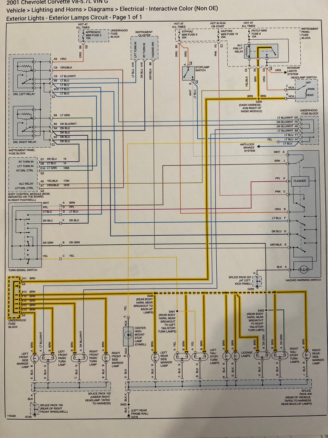

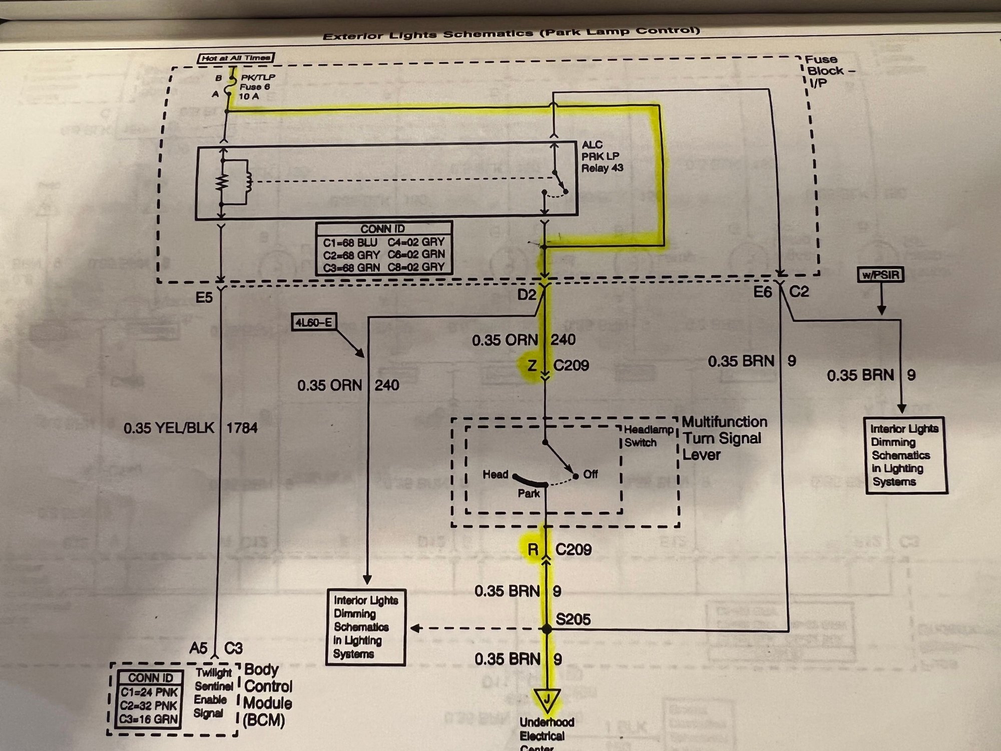

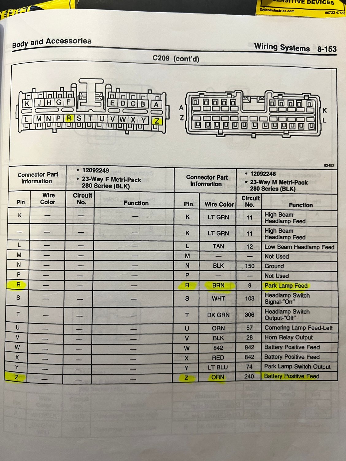

When you use the FOB the ALC PRK LP relay is being used…the control side of the relay is activated by grounding the ALC RELAY at the BCM through the FOB…refer to the diagram and you can see all those brown wires receive power to operate all the lights at the bottom of the page…when you use the stalk the relay does not come into play…power is standing by at terminal Z of the stalk…when you turn the lights on all those brown wires are receiving power through the orange wire…locate connector 209 and jumper pins Z and R…if the lights work the stalk is bad…also make sure pin Z has power on it !!…did you ever get your other issue resolved from last month ??
