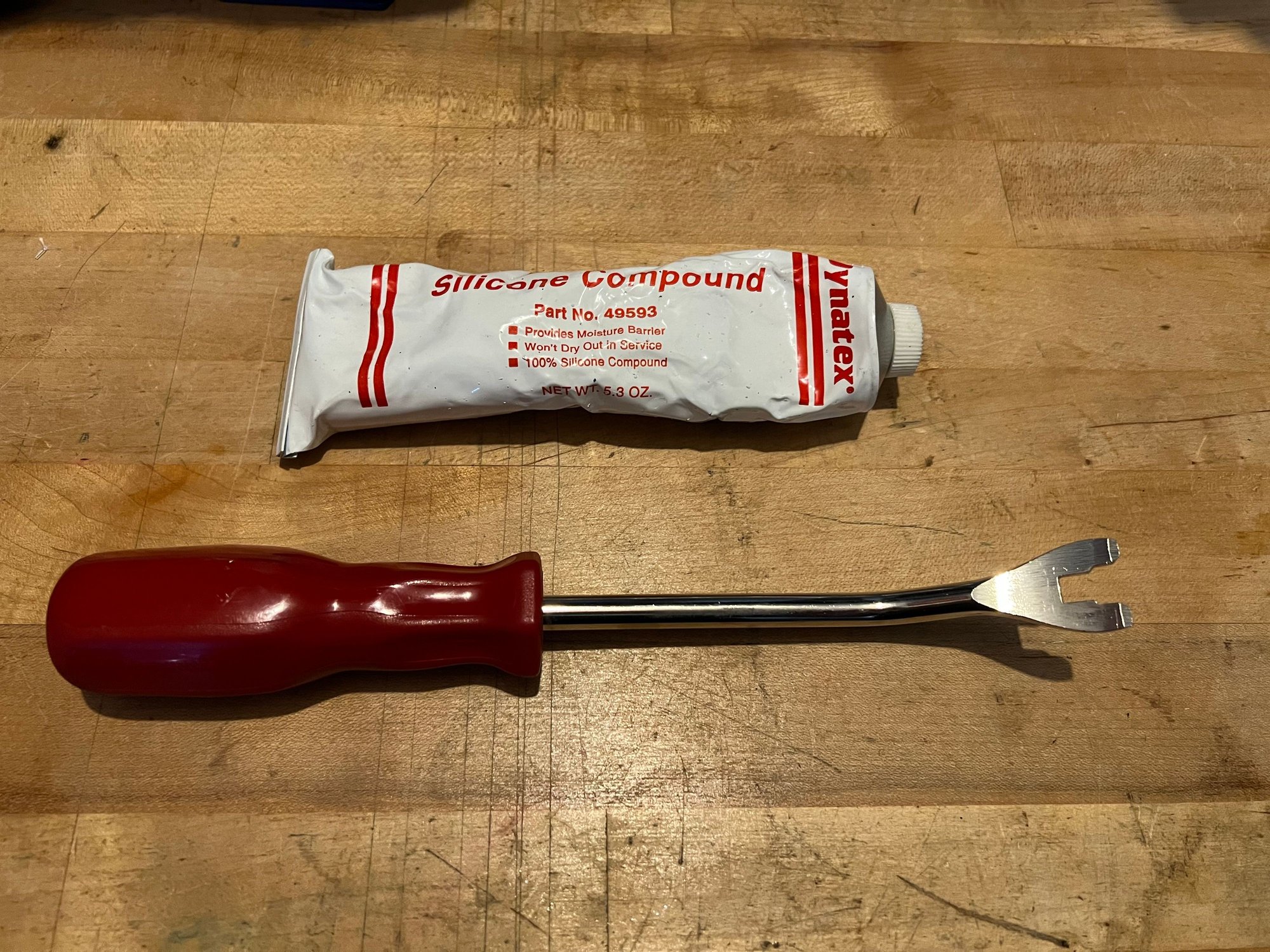

As we all know, the #7 spark plug on the LS1 can be a bitch to work with. I'm currently wrapping up a project where I swapped out my radiator, hoses, belts, water pump, stat, belts, and spark plugs/wires. Everything is pretty much buttoned up with the last remaining item being the ol' #7 spark plug. After struggling to get the new plug installed, I was finally able to lock it in via a long swivel socket. Now I need to get the plug wire attached. I can get it on the plug with the wire and metal sleeve/spring but I'm not able to reach in and twist it on with any type of leverage in order for it to click onto the spark plug like I did for the other 7 plugs.
Any tips, tricks, or tools for this plug wire without removing all the other brake plumbing, etc.?

Thanks for all the advice. After multiple, stops and starts, I was finally able to get the plug wire/boot seated and connected on #7. I used some silicone dielectric grease on all the wires both at the spark plug and at the coil pack. To pay this thread forward to other members, after positioning the wire and aluminum boot/spring over the plug, I used an automotive trim tool that had a wide enough fork on it to allow the wire to sit in between. I was then able to apply enough even pressure to push the wire and connect onto the plug without damaging the wire. Usually I try to twist as well as push when installing the wires, but I had enough grease to get it done, plus the wires were new which helped. Lesson learned so when I do this again (in 10 years) I will remove the coil packs and vacuum lines to make access easier. It took me longer on the removal and install of the #7 plug and wire than it did for the other seven plugs and wires combined!
