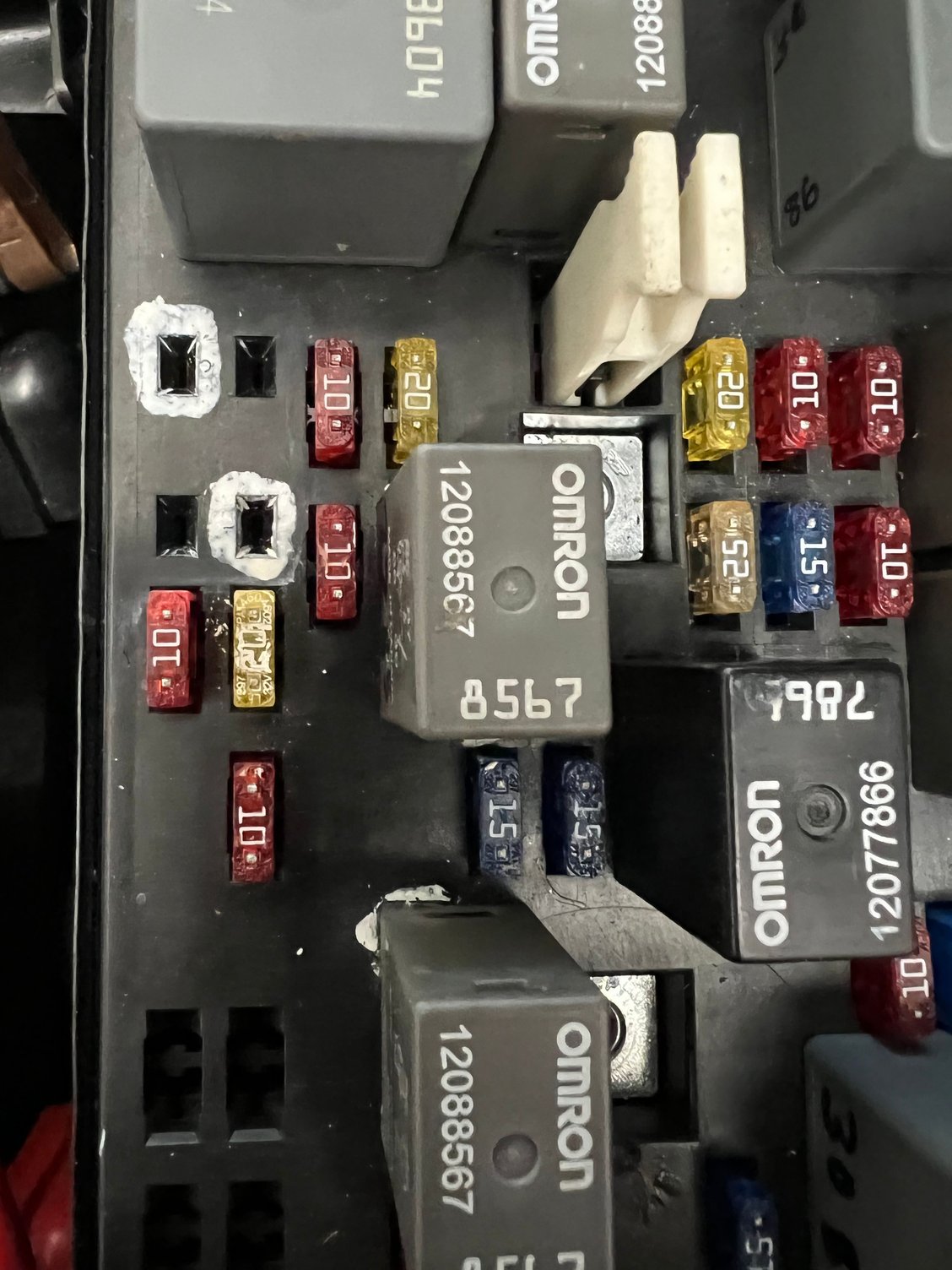

Just jumper pins 87 and 30 at the relay with key on (white highlighted terminals)…doesn’t matter if PCM is installed or not.

Diag - I was hoping I would hear from you. I printed that same pic and took to the O.R. Then, my head started doing what it always does and the PCM thing entered the room. Just a simple Panic Attack - I was gonna have a hose running and 2 fire extinguishers next to me....
