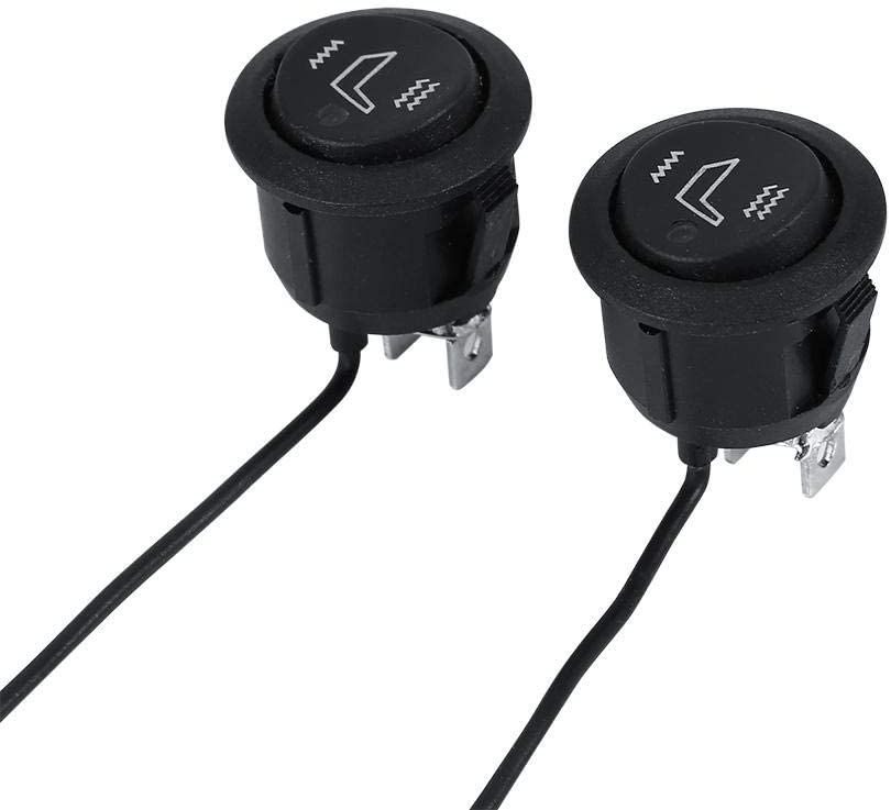

Hi Gary, have you seen these switches? I like that they have the LED built in, etc. but I'm not sure if they are momentary switches or permanent switching as none of the listing say so
https://www.amazon.com/Universal-Hea...A5F8C0FW66V2CK
Those won't work for the C6 seat heaters.
The description for the switch should include (on)-off-(on) to indicate that it is a momentary switch.
Gary

Oh damn, I was gonna be all fancy smancy with it lol. Oh and about the connector I found universal male and female connectors in 4,8,12,16 pin configurations that I could solder on so that would work!
