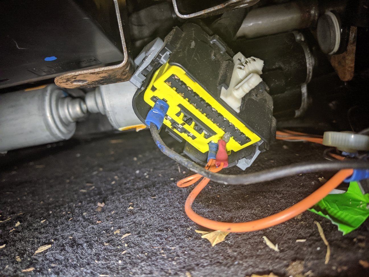

As for wiring, the passenger factory power is 3 wires
But you only need two, the thick orange power and the thick black ground
Same thing for driver side, you just need the thick orange power and thick black ground
The connection is as below, driver needs the thick black in bottom left and thick orange in bottom right. The driver side also borrows power and ties into the 3rd from right in the lower-upper row (not my pics)
Passenger side is same as driver but ties power into farthest pin on upper-lower row (not my pics)

The seats are pretty much plug and play with 4 bolts + the 3 wires mentioned above which are all that's needed to get them going. I did lose the power telescoping steering column, but I am thinking I can just pull the module from my stock seats and stash it back under my new seats to get that feature back again. There is also a C5 to C7 seat harness that will make them truly plug-and-play but the manufacturer is having supplier constraints due to coronavirus so had to do the wiring manually.
