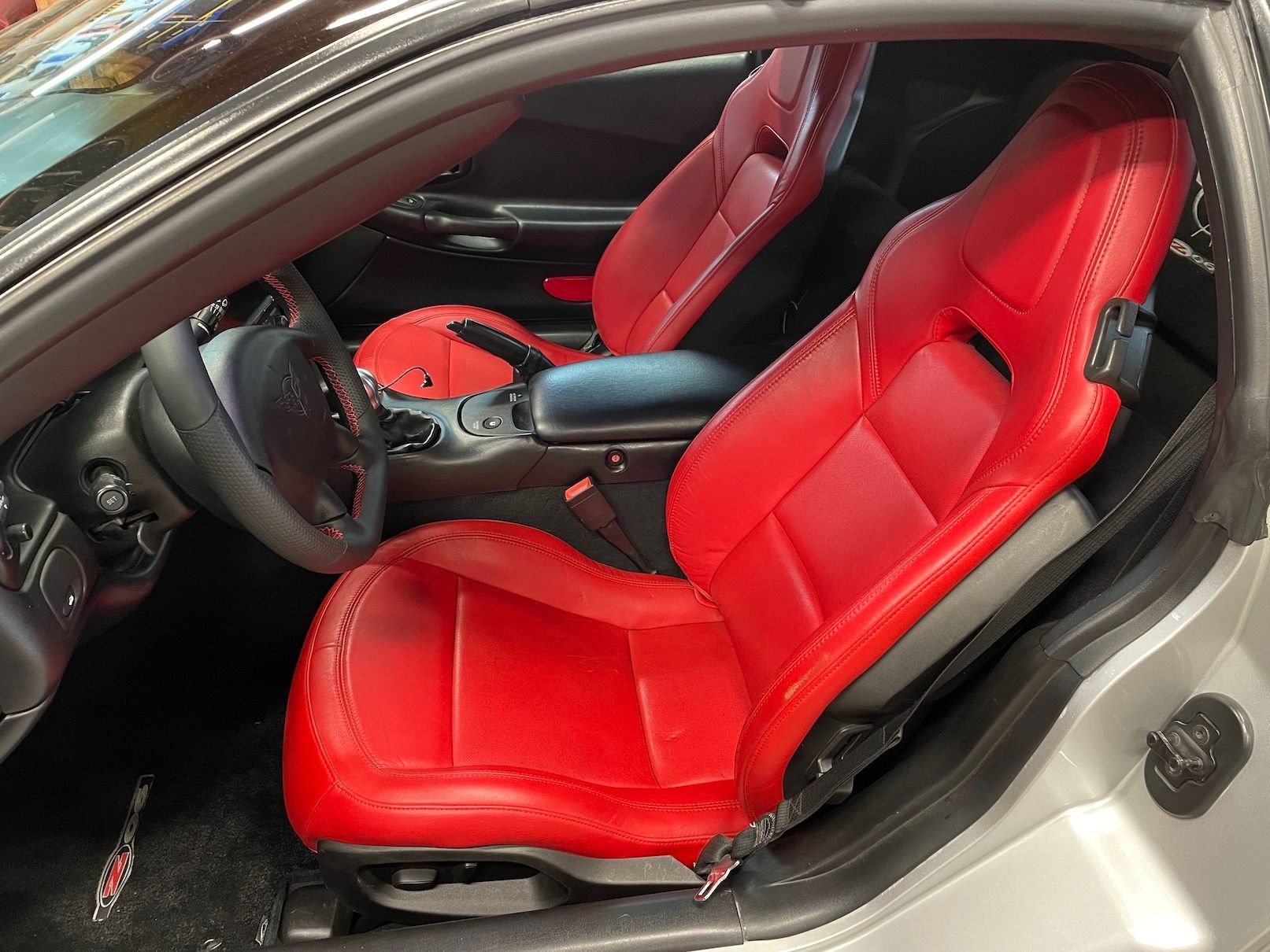

Just wanted to add my install to the mix.
I ended up finding a set of red C7 GS seats in pretty neglected condition, but for a steal. It took many hours of elbow grease to get them cleaned up and looking presentable.

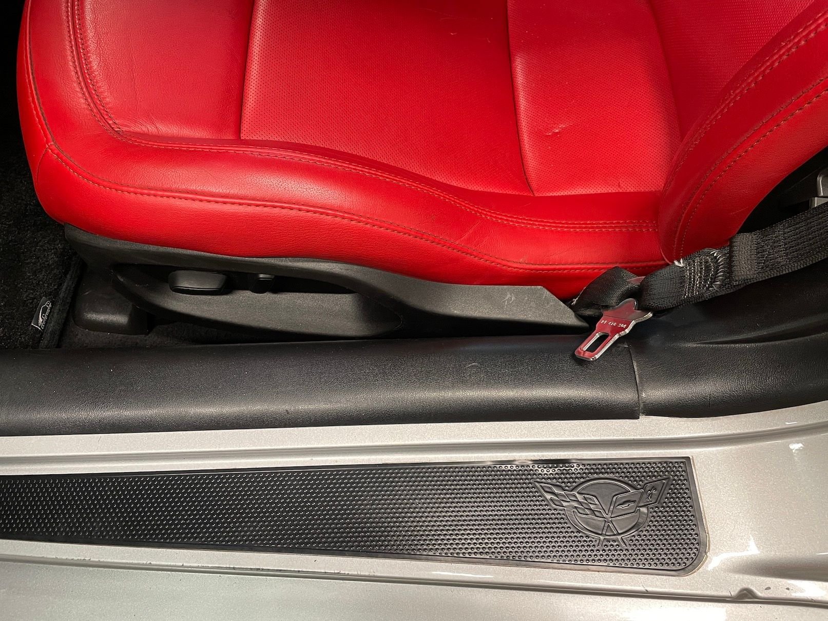

I left the C5 belts intact, so the hump at the bottom stayed. I cut away part of the C7 seat side panel to fit around it once I found where it would need to be for my seating position.
I bought jdmvette's seat pigtail, and used that to create a wiring harness to the stock seat connector.
I also designed and 3d printed an adapter to allow me to use the stock C5 bolt covers. Sure beats spending $30 a pop on C7 covers!
Now that I've installed the flat bottom wheel, I'm really happy with the interior. It really freshens up the interior and the seats make a WORLD of difference. They're solid and keep me snug where I need to be. And they look amazing.
I really appreciate the write-ups from all you folks. It made it much easier to go through the process.
All in all, I'm very happy with the result, and the red really pops (I've always wanted a car with red seats, so I may be biased)!
Seats mounted
Seats & new steering wheel
Cutout for seatbelt
Just a bit of red poking out
How i found the seats
