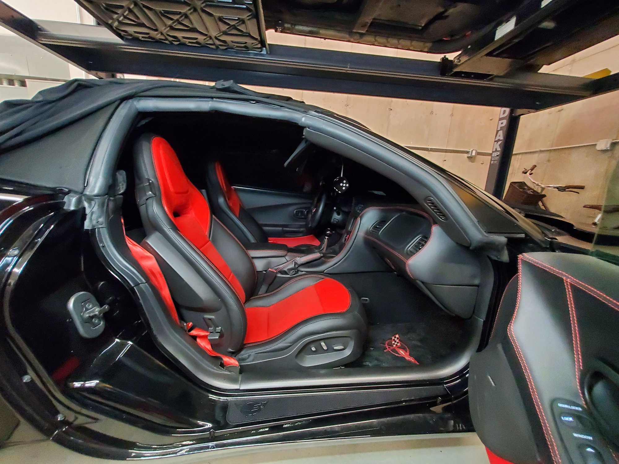

Originally Posted by BossHoggTX
How is the height of the seat compared to the stock C5 seat?
It's a bit higher than the C5 seats bottomed out. For reference, I am 6'2" with a 31" inseam, and I fit comfortably in a C5Z.
Old Feb 24, 2024 | 04:06 PM
  #88
Ramathorn178's Avatar
Ramathorn178
Joined: Jul 2018
Posts: 80
Likes: 70
From: Washington
Interesting as Im 5'10" with a 33" inseam and also fit comfortably in C5Z w/ C7 seats. I dont feel the height is any different. Long torso, short limbs vs. Short torso, long limb debate i suppose.

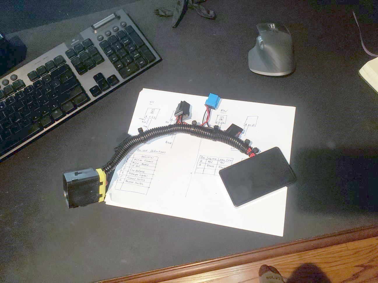

Originally Posted by JMG2
Damn, is that what you put together or is that what he sent you? If that's what he sent you -- wow -- his quality has REALLY gone down. I get that it goes under the seat, but that looks like a prototype.
making the harness is really ridiculously easy, and you won't have to deal with dan's lack of communication. There are several write ups on the forum, you can build it from scratch or just use the SCM harness under your seat (if you have telescoping steering, this is the easiest to do -- to my knowledge, dan never was able to get telescoping steering to work-- it's super easy to implement, he just never got around to it, and told me in a text that he wasn't going to. ).
Here's a harness I put together for a C7 seat in my c5 -- same amount of wiring, just a different plug. The box houses the two relays needed for telescoping steering -- which is needed whether you're using c7 or c8 seats to get telescoping steering to work (gm for whatever reason routed telescoping steering and memory through the seat control module):
that's a nice set up. If you decode to make these for sale, I'd be more than happy to by a set.
I'm shopping for seats now. This set is good for the telescoping steering wheel, thats awesome. If you have a thread on this or making this, could you please send to me or post.
Beautiful job!
Beautiful job!
I'll dig it up.. I've no real interest in selling those, trust me, it's not worth it.
By FAR the easiest thing to do is to reuse your existing SCM. It won't be as neat, but it's super simple, and if you dig into it, you can cut away most of the wires. If I was doing this again, that's what I'd do.

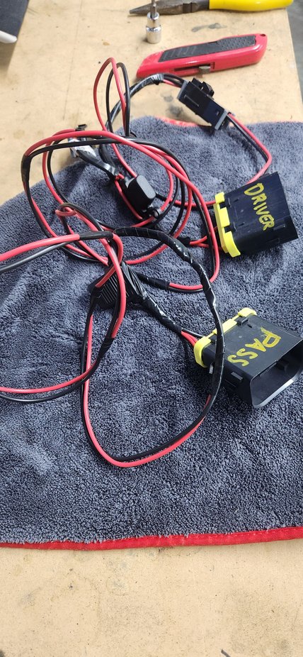

I sourced all the connectors and parts to finally make my harness more permanent / OEM looking.
Given that I have a C5Z, I don't have a power seat plug on the passenger side. I was originally going to power it from the driver side, and run a patch wire to the driver harness over the top of the tunnel. Now that I'm ready to actually do it, though, I'm wondering if there's something better / easier to tap into in the passenger side / passenger footwell where the fuse box is.
Thoughts?
Thoughts?
Personally i think its fine and thats pretty much exactly what i did. I honestly dont think it gets any easier than just making the jump harness to the passenger side.
Thoughts?
Its easier and about 2 min to just run power behind the tunnel trim from the drivers side seat.
I bought all the mouser connectors and pins to make it look OEM but it turned out to be a PITA and much easier to jump wires to the correct pin on the seat connector.
