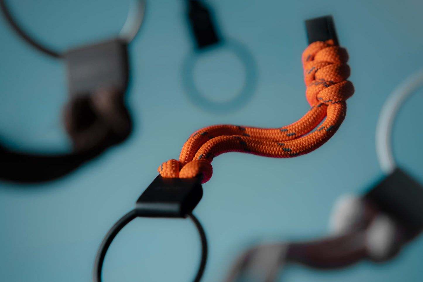

When I installed my Corbeau A4s with the swapped rails such that the seat back lever was buried in the center torque tube wall I drilled a hole in the end of the metal tab and installed a pull ribbon on it. In my case it was a Mighty Mouse catch can key lanyard which he no longer sells. Basically, a strong flexible fabric pull tab. Any similar pull tab can be used as well such as the hard aircraft preflight check tabs likewise mounted to a key ring or slot. Anything like that would allow you to cut back the metal tab if it protrudes to be a minimal height, tuck in nicely, and sti be fully functional.
The wristlet style (I googled the product) is the most comfortable to use. All would work. I'd probably make myself a parachord one. I can do the same for anyone interested. I'm down to my giant green roll but can do black with reflective weave in them too if I source it.
