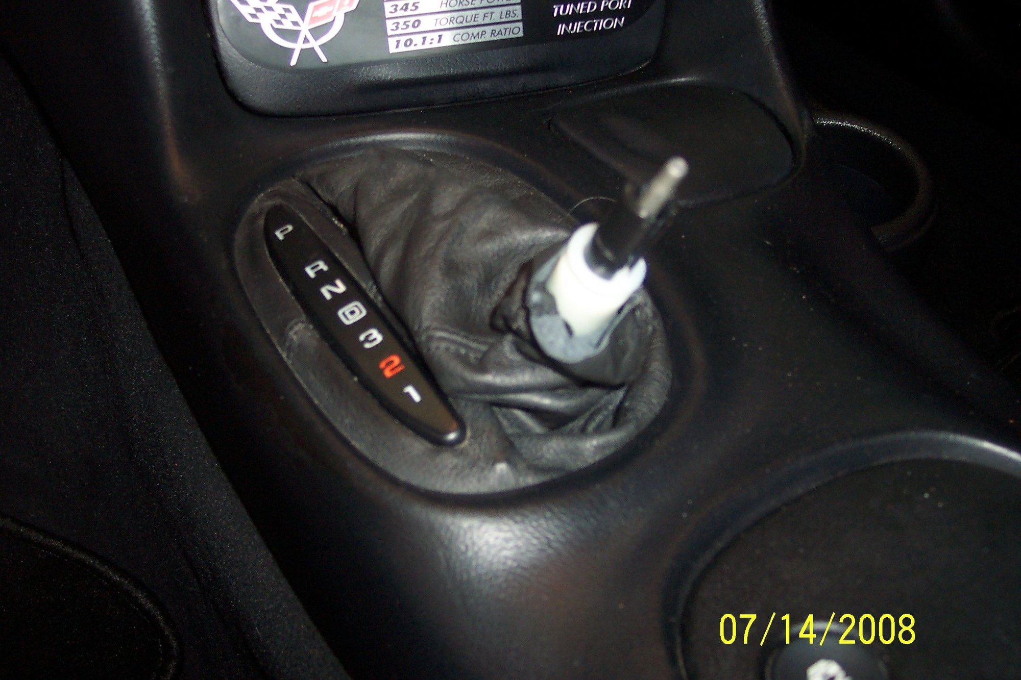

As far as I know, the shifter shaft isn't adjustable. If he did change it in any way, he most likely cut it down some. That could explain why it doesnt seem right. That would be my best guess anyway. If you can take a picture of it maybe we can compare it to a stock one and better be able to tell. Maybe put something I some the shifter button to take up some space.
This photo is blurry and I'm installing an aftermarket ball, if you need a different one then I can remove it and get a new photo.
