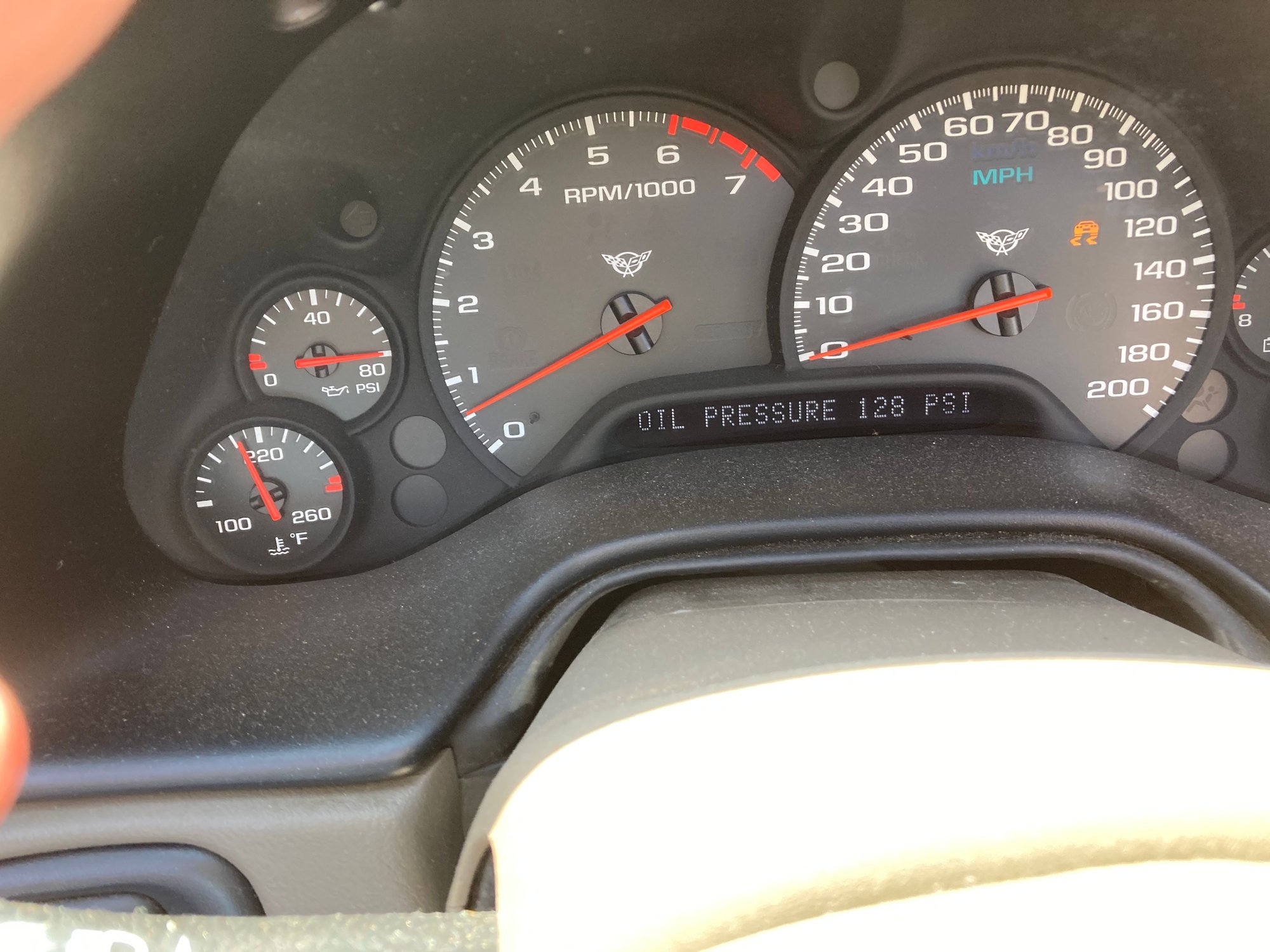

High volume oil pump or ??? 🤣

Definitely high pressure!Hope the seals and gaskets can hold it.I am sure you know what the issue is.
Yep. I cut the access hole about 4 years ago. Should be a breeze this time. 🍻
IDK what seals or gaskets need to hold oil pressure, other than the barbell restrictor O-rings. Anyway, sounds more like the oil sender is junk. Easy fix.......

Originally Posted by Eshoremd
Can someone explain what exactly causes this or paste a link? Just curious.
Has to be just junky sensors...never had this problem with any other vehicle.
Yup!! I usually lean towards replacing most electrical components with OEM. This is one of the few that I wont. Bought a 1 year warranty replacement from O'Reilly 5 or 6 years ago. Lasted longer than any of the OEM units I've bought in the past, and still works fine....
