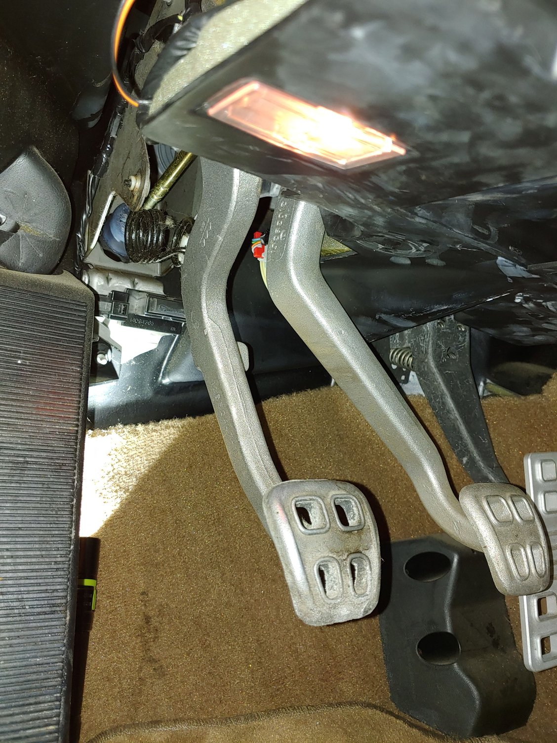

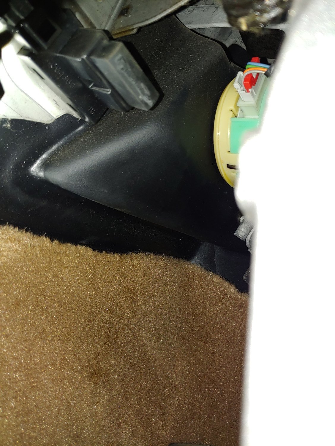

From: Clark, NJ
Old Apr 6, 2022 | 09:27 PM
ThomasR's Avatar
ThomasR
Joined: Apr 2019
Posts: 2,466
Likes: 700
From: Clark, NJ
In the first picture is above the bend in the brake pedal.
Just squeeze the tab and pull it off. You'll be 100% active handling free and can safely drive and enjoy your car while you decide on how to fix.
