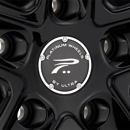

Will this will fit correctly on the front of a c5 corvette with the correct +35mm offset its an 18x8 platinum atonement. The wheels look nice for the front of a 99 corvette. Has anyone had experience with this wheel size and offset. Its 18x8 vs the normal 8.5,9.5 rims. The offset is measured from the middle of the rim to the inside hub mounting surface. 35mm will probably hit the front brake calipers correct if not be pretty close on a c5 corvette. Theres about 1" of space so 25mm between the stock 5 spoke rims and front 99 c5 calipers.
These may be within 5mm of the front calipers? The wheels look nice for the front. 18x8 platinum atonement 18x8" +35mm offset. 54-56mm offset is what stock is so with 1" or id have to measure with a caliper gauge would probably leave 5mm or so from hitting the front brake calipers. Has anyone ran a wheel this close to the calipers and does this cause issues. Spoke design would also play a factor in har far or close they are to the calipers. Im just about the pull the trigger and order some oe replica c7 z06/ c6 zr1 black wheels 18x8.5 but have a 54mm offset so yes 20mm off and id have to measure the exact distance from back of spokes to the front caliper with a caliper gauge to get an idea.
These do look nice but the offset is 20mm off being a 8" rim i think the backspacing is correct so the wheel would be in the correct position just close to calipers. Can always use the 50$ ebay c5 20mm spacers. Does anyone think these are better then the c7 z06/c6 zr1 wheels? They look nice and are a cool name brand.
