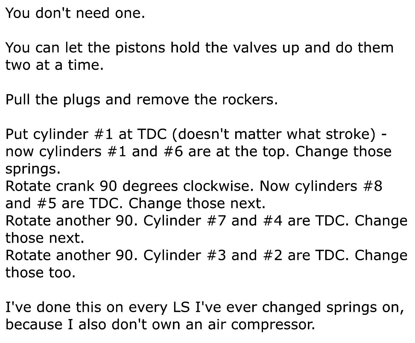

Not all of us have an air compressor handy… The TDC method is fine, but if you are also changing the seals, the valve will drop a little bit. So the rope goes in the cylinder, crank it lightly back to TDC and the valve will stay in place. Since your pushrods are out it doesn’t matter if it’s in compression or exhaust stroke, as long as the piston is TDC. So you can do two cylinders at a time. For example #1 and #6 are both TDC at the same time.
The top photo is the sequence for changing the springs, and bottom photo is the sequence for torquing the rocker bolts.
