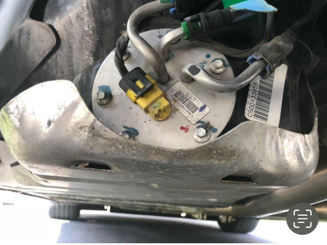

I have been smelling fuel while the car is in the garage.
I looked under the tank by the skid plate and saw it was wet. I started to take the plate off and saw that the leak is flowing down the belly of the divers side tank. Im guessing this is the fuel pump seal maybe? I also have a evap / lean code that maybe this is affecting? p0171..im going to change the purge valve also but apparently all the parts are discontinued be the dealer..
Does anyone have a parts list for this and a youtube video to work on the fuel tank? If I take of the fuel tank metal plate off will the tank just drop or is there another harness? It seemed it was coming down as I was taking the plate off... I have some pictures...

I vaguely remember your issue from a few months ago but did you ever use your scan tool to see what your fuel trims were doing after you filled up the tank ??…I said the purge valve MAY be the cause so I wouldn’t just go and change it. Did you fill out your profile so we know what we are dealing with here…do you have a non FFS fuel system ??…is your fuel pump at the bottom of the left fuel tank ??…tank removal is VERY labor intensive and requires the rear of the car to be pretty high off the ground…hard to tell in your picture where that leak is located…is it the left rear corner of the tank ??…you should take off the aluminum access plate and look !!..is the leak coming from above the pump ?!

The fuel appears to be leaking down the tank and sitting at the bottom inside the aluminum plate. ...I went to take the aluminum plate off but i was afraid that it was holding the tank up? If I take the plate of is there something else holding the tank?

If you take the access cover off you would have seen the pump so with the FFS RPO code it’s topside…it was changed roughly halfway through the 2003 model year…that aluminum plate doesn’t hold the tank up…I’ve had mine off a few times !!

ya mine is not on the side of the tank unfortunately ...
