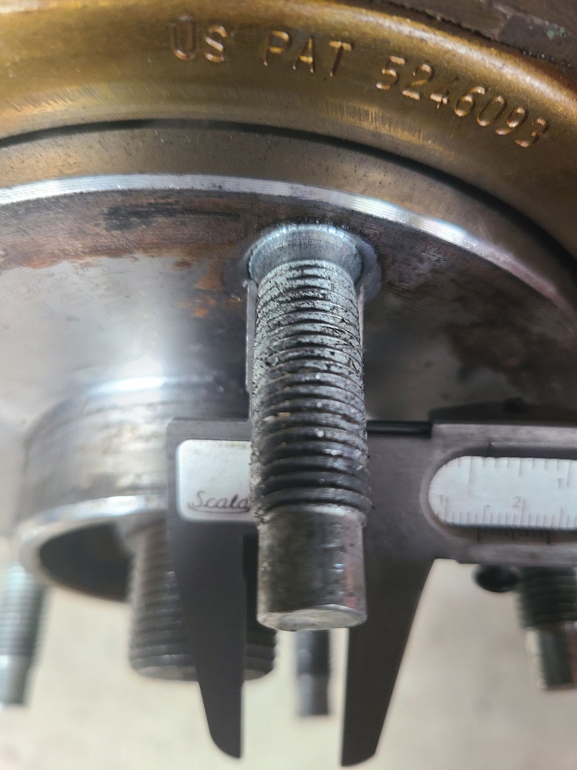

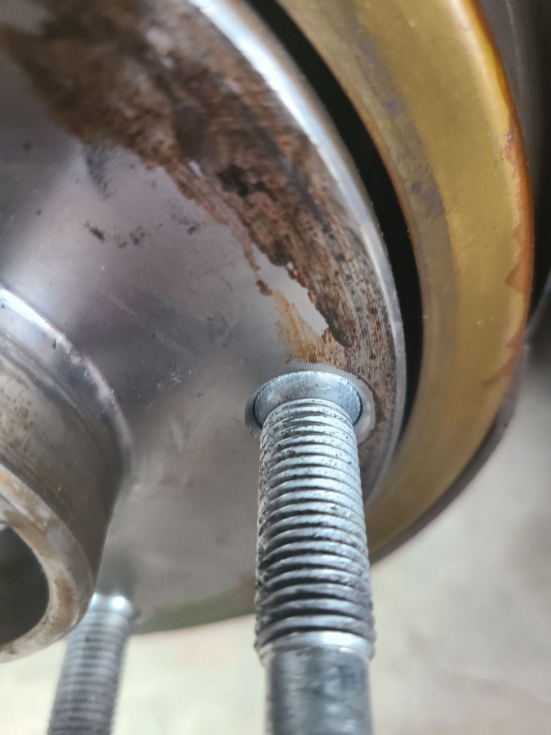

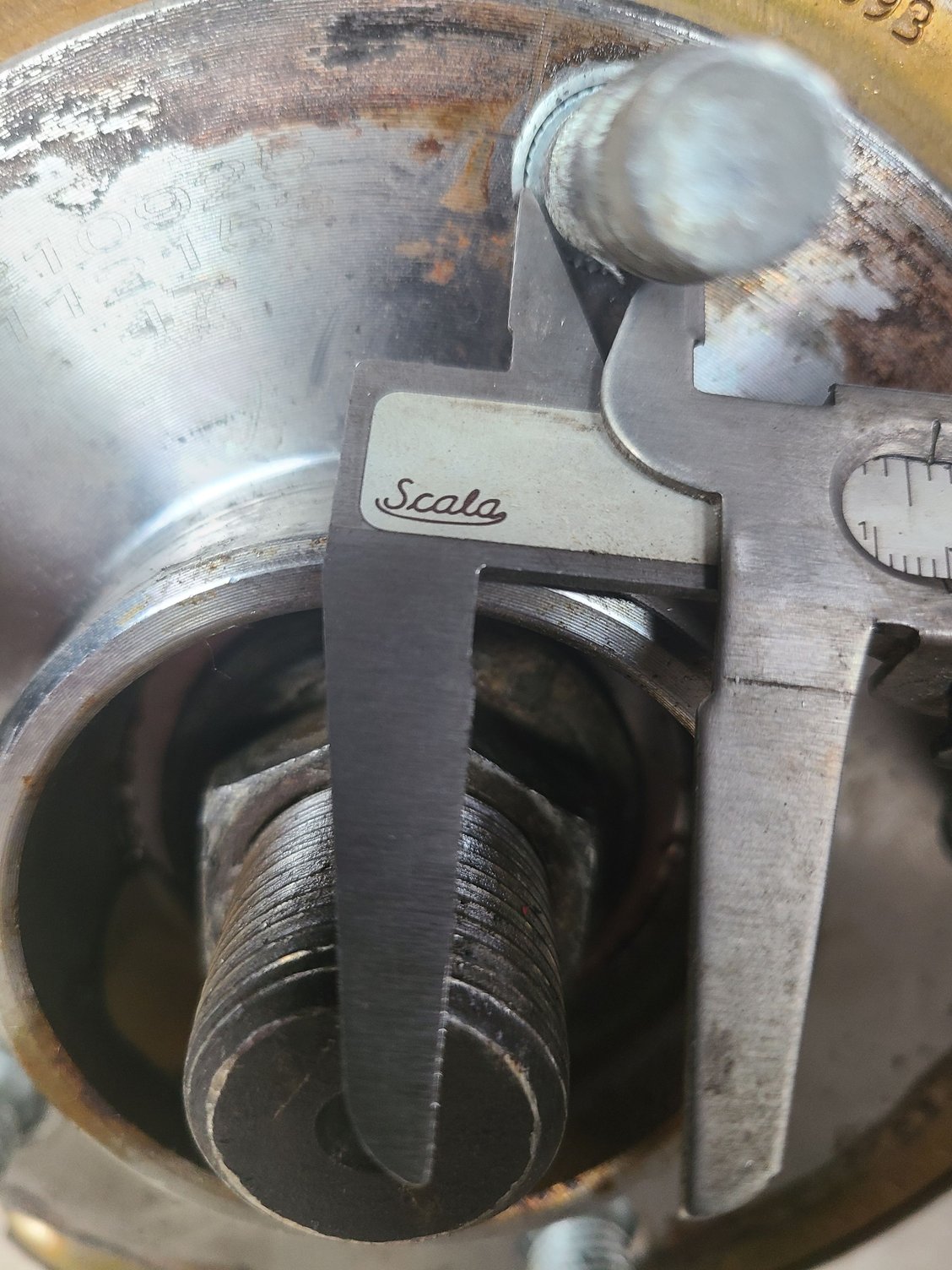

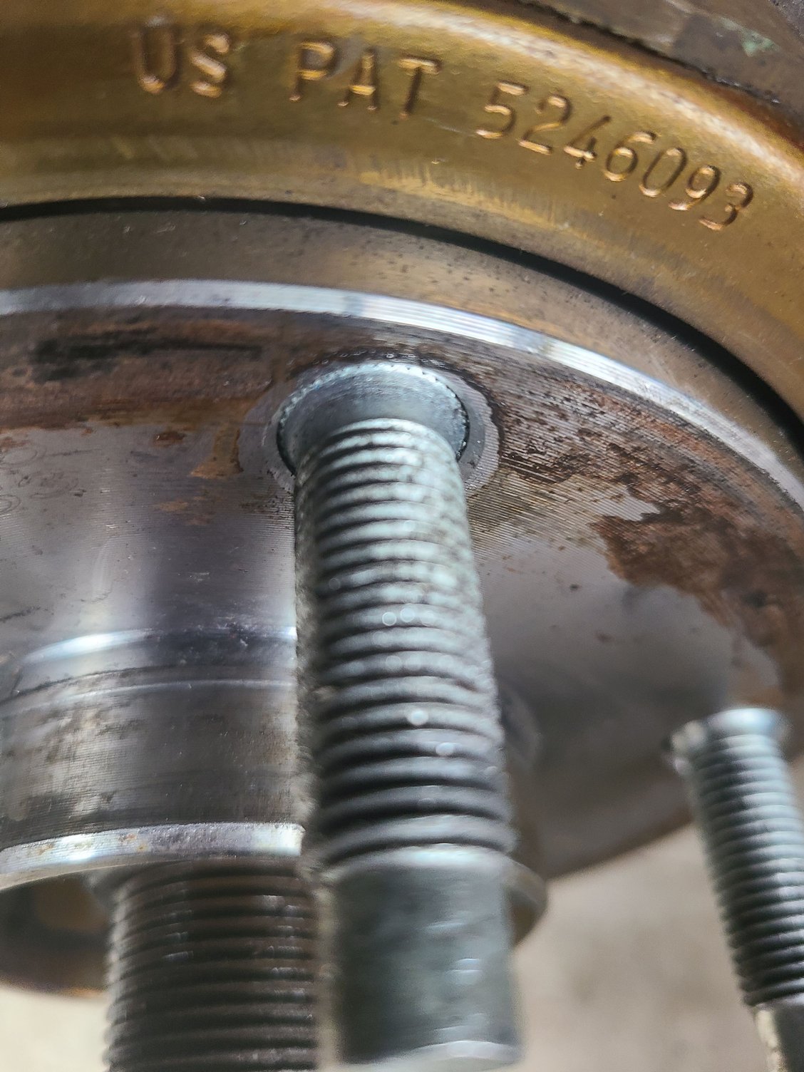

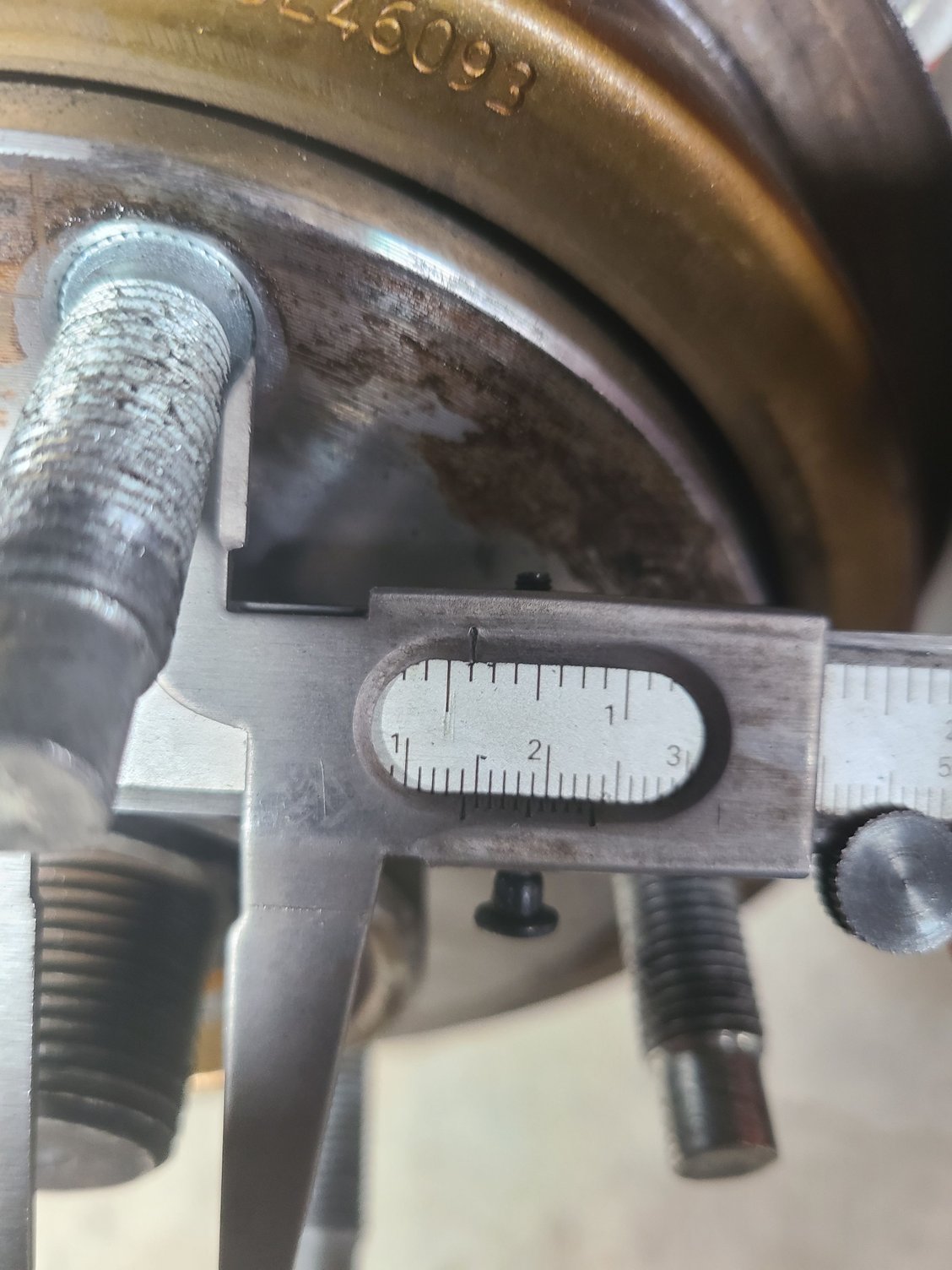

I took it apart somewhat, don t feel like disassembling suspension again right now.. but the SKF holes are definitely larger than OEM.
hoping these pics can show the difference.

Can't tell much from the pics but Kubs is correct, the standard knurl diameter is 0.509. Specs on the ARP M12 x 1.5 studs show a knurl diameter of 0.509 (same as stock), with a required bolt hole size of 0.493 - 0.503. But specs on the SKF BR930198 hub show a 0.510 bolt hole size (as SKF stated) so I understand the confusion. Even the ARP web site https://tech.arp-bolts.com/wheel-stud-fit.php clearly says the hole should be .006 - .016 smaller than the knurl diameter, so a .510 hole would require a stud with a knurl diameter of .516 - .526.
I've always changed studs myself and have never had an issue with the ARP M12 studs so I'm not sure what's going on here. Don't know who "RA" is that you purchased the hubs from but maybe you could reach back to them and ask if they offer that same hub with studs installed, and if so what studs to they use.

What are you measuring in the pictures? What was the reading you got?
Old May 4, 2022 | 09:49 PM
walleyejack's Avatar
walleyejack
Joined: Oct 2008
Posts: 8,892
Likes: 981
From: Whitby Ont.
was a feeble attempt at showing hole measurement, which .51. that does not accept a m12 stud.

Just curious, if the SKF hubs came with studs, why wouldn't they work? Too short? Wrong thread? Or both? Too bad, because SKF makes very good bearings. Just asking. I want to point out that the OP is using the internal measurement fingers to attempt to measure and outside diameter. This isnt the most accurate way to measure when using calipers. But sometimes you gotta do whatcha gotta do...

Yeah I didn't really look at the measurent pictures, but they're definitely larger. Can't really measure them without popping them out of the hub haha, I agree. I did measure mine while they were out, but I didn't document the actual size.
