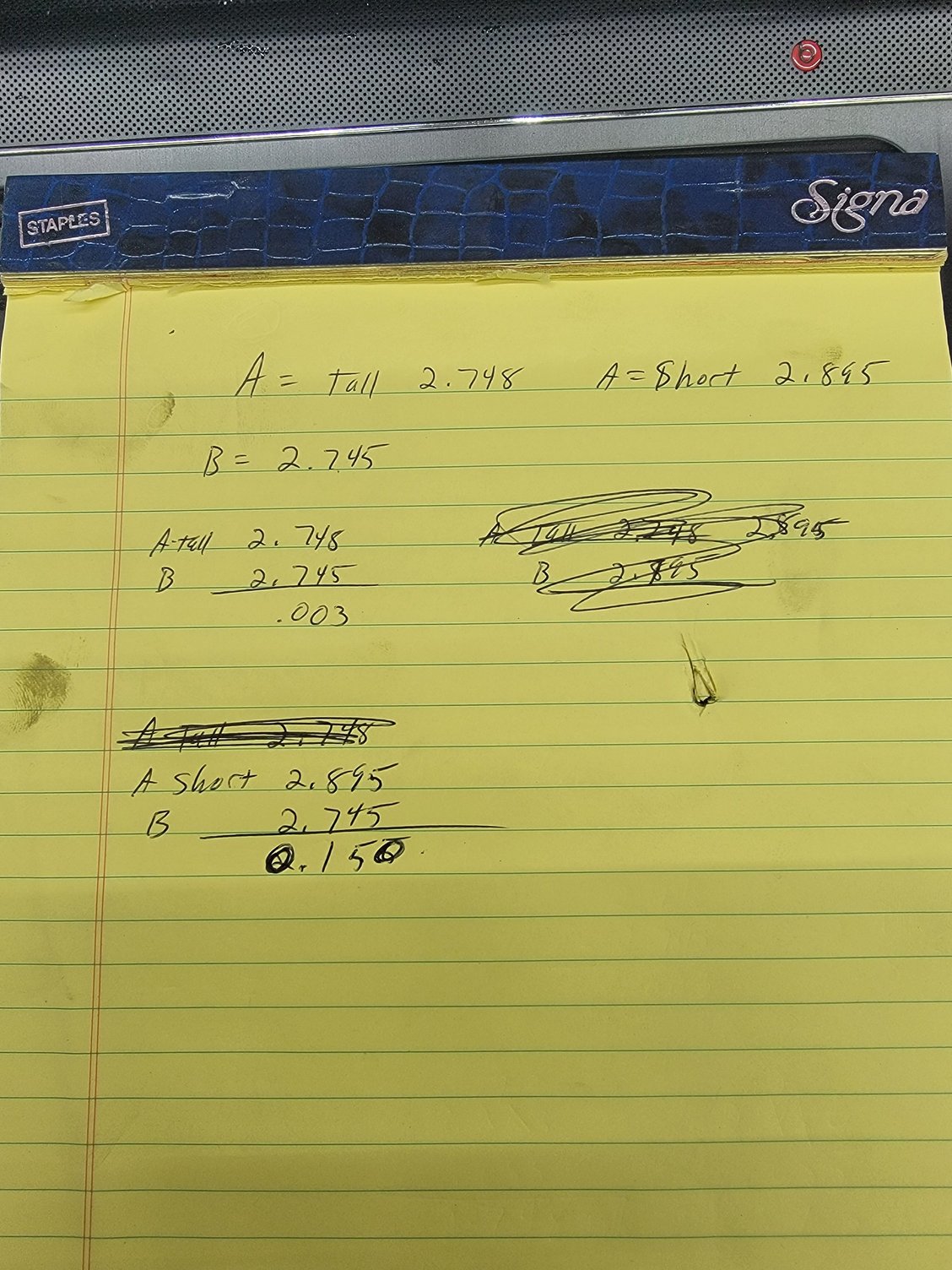

Here are the numbers.

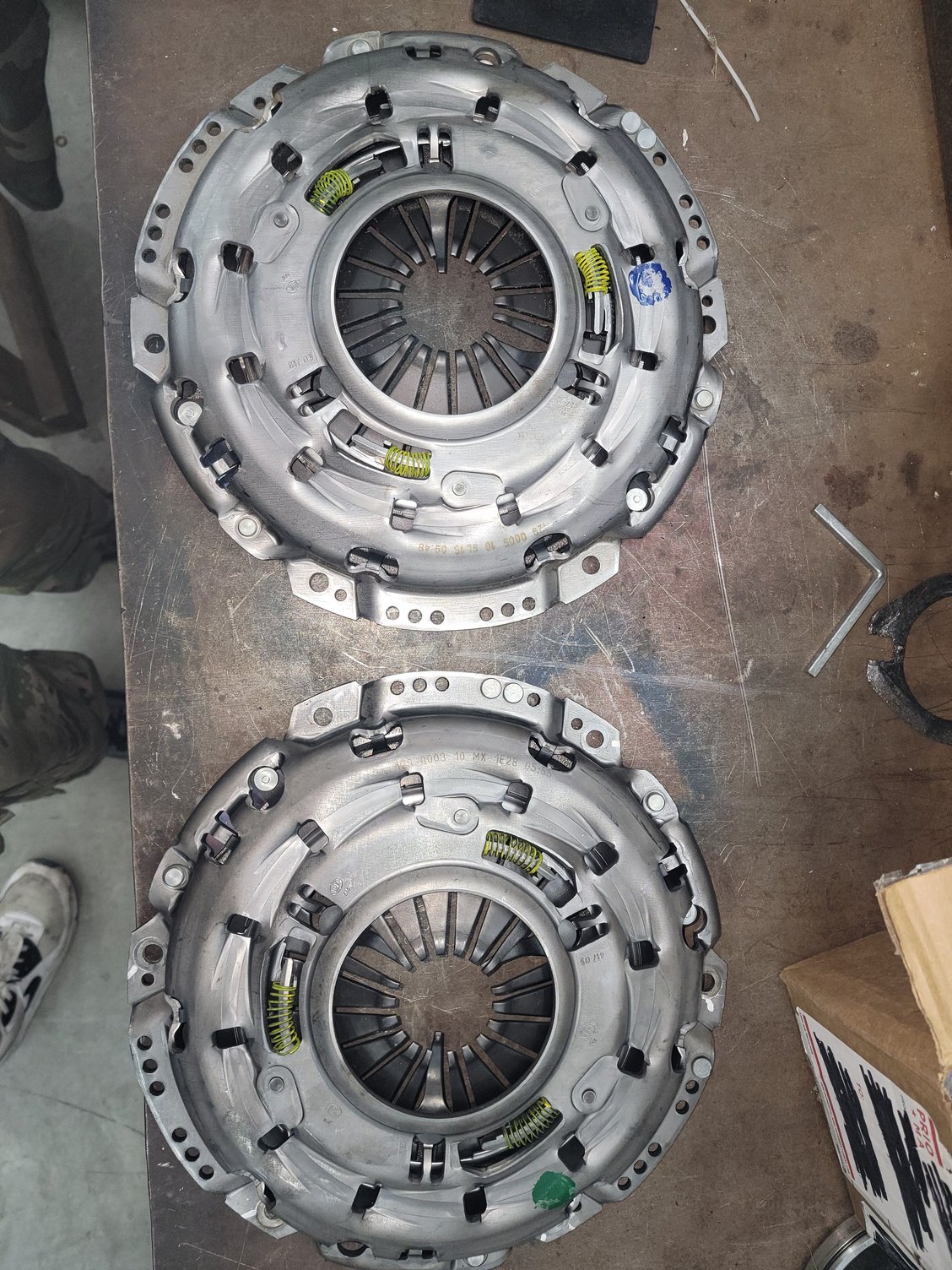

Brand new one on the top, on the bottom is the new one from the car. I see no differences in them other than the length of the yellow springs. Maybe something is stuck? I believe the slave cylinder is the upgraded C5. Definitely not a C6 slave cylinder.

Do your A and B measurements match this?
Old May 8, 2022 | 07:24 AM
2002 C5's Avatar
2002 C5
Joined: May 2019
Posts: 316
Likes: 21
From: Michigan
Yes. That is what Tick sends you when you buy from them. Although, it doesn't state what set of fingers to measure to. That's why I called again the first time I took it apart, three of the fingers were just a little bit more toward the rear of the car than the others. The difference was small to the eye, but huge when it comes to measuring. That's why there is two sets of numbers showing on the yellow page in the above pictures.

Looking at your measurements, the "tall" number only gives you .003 clearance?
Old May 9, 2022 | 08:33 AM
2002 C5's Avatar
2002 C5
Joined: May 2019
Posts: 316
Likes: 21
From: Michigan
That was with the .113 shim. I've read around on other forums, in the '90s jeep had an issue with the master cylinder. Mine is the stock unit I bought with the trans and such. Thoughts?
