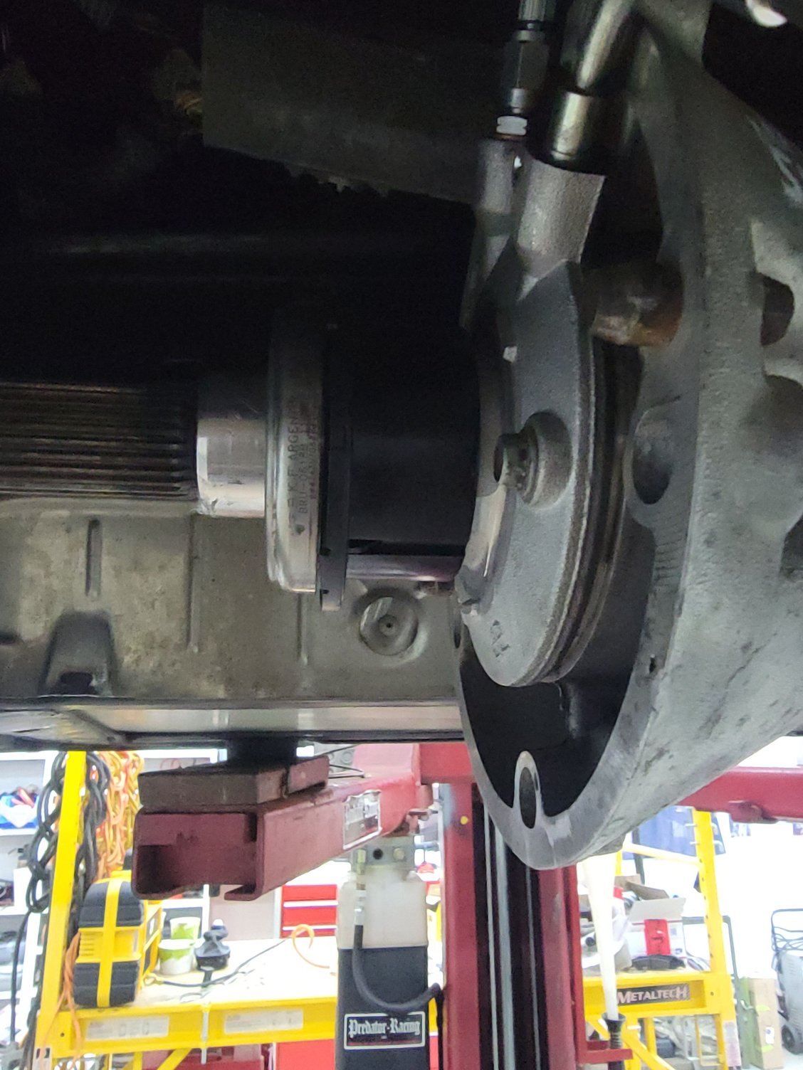

Was just out in the garage, we did a few things. I installed the new pressure plate and new clutch plate. Had my son get in the car and work the clutch. The slave cylinder moved back and forth, but stuck to the floor one time. But, at least I know it's moving. That was with no shims at all.
We pulled the torque tube back and re-measured the salve with no spring installed

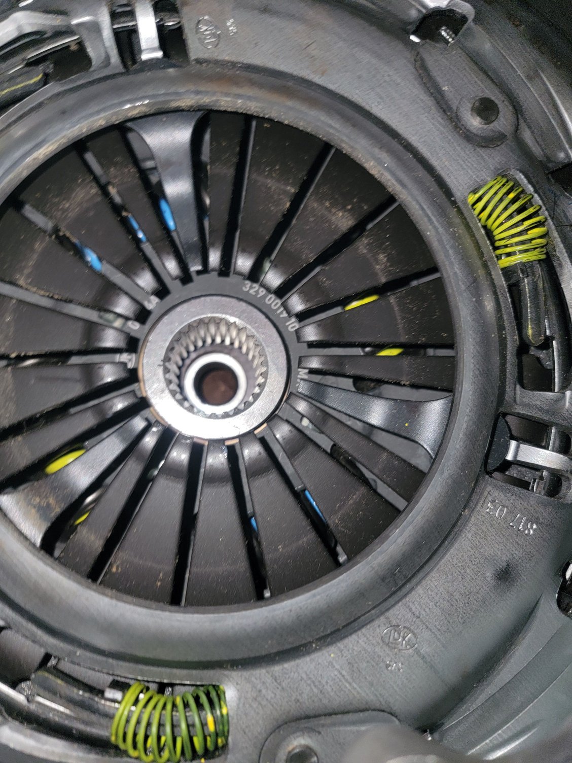

Everything looks the same, just as it did when I first installed the other set. The fingers are all facing the correct way, the 3 fingers are closer the the engine than the rest of them.
Fingers facing correctly
No spring on the slave
