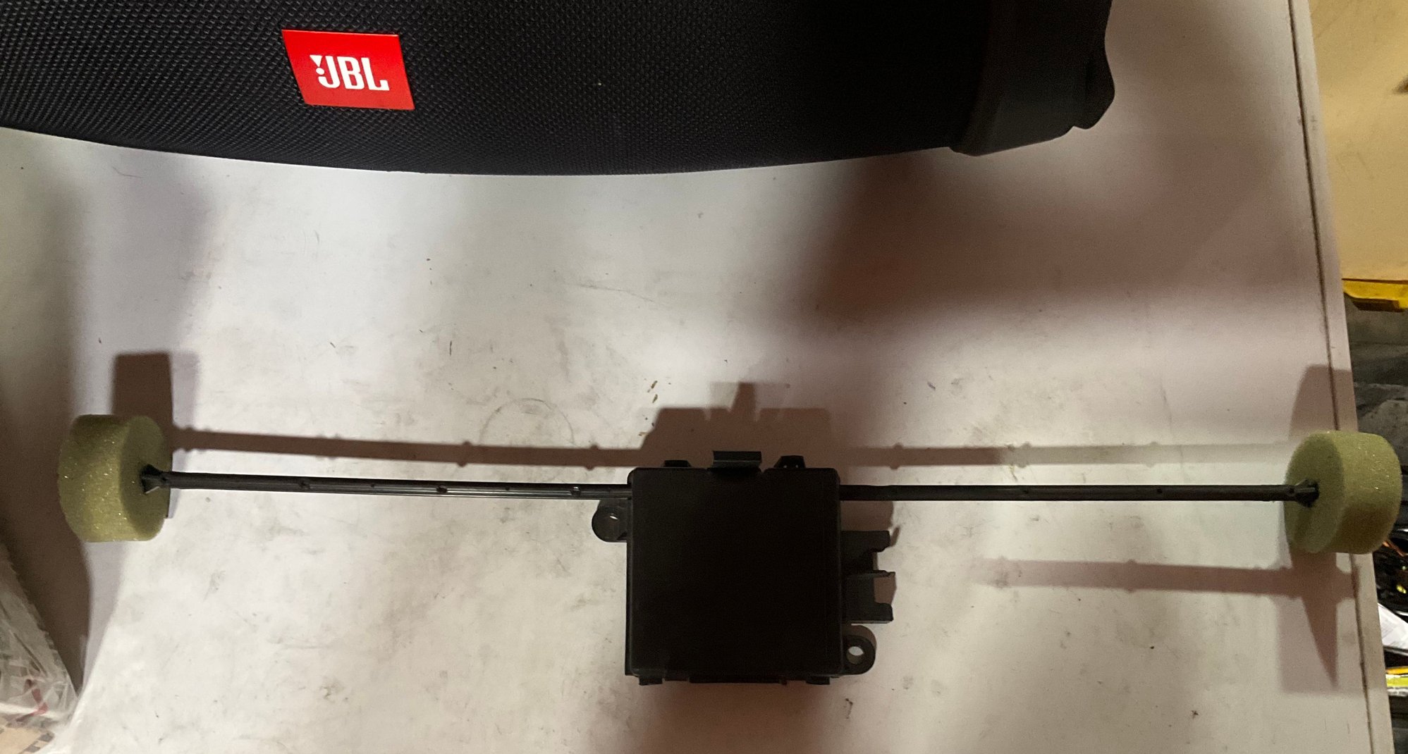

Hi. I have a 1999 Coupe. Up until Saturday, my FOB's and TPMS were fine and now both not working. I did little research and think the receiver may be the issue. Anyone have this happen or can confirm as i believe they use the same receiver, thanks.

^I have a receiver in working order should you need one

in in the same boat with my Z06. Fobs not working, new battery, still not working, won't relearn, new fob won't pair. They don't make the receiver anymore you'll have to find a used one.
