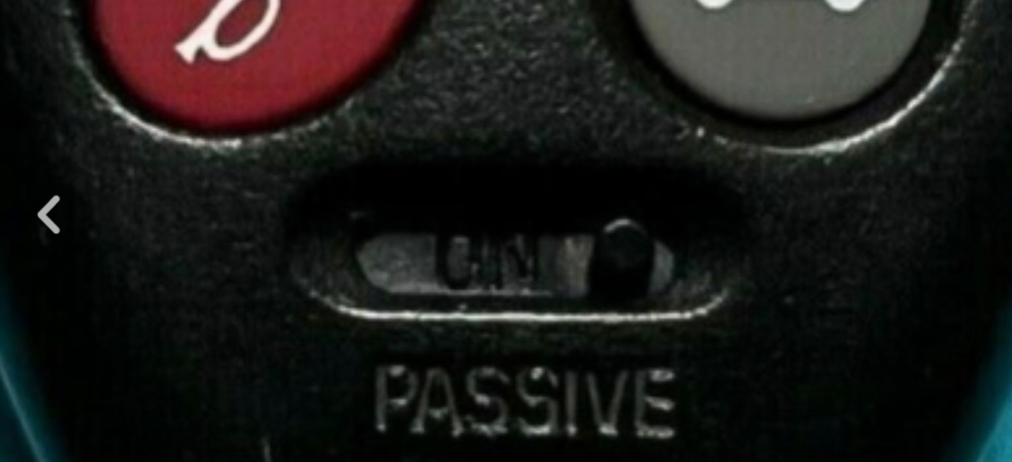

You have a '99 vette. The 97, 98 and 99 came with passive entry remotes. If you don't replace with the same passive entry remote...it won't work.
Is the new one you purchased equipped with the pasive entry feature, or is it the standard remote?

Unfortunately that one won't work either. 1997-2000 original FOBs have the little switch at the bottom for passive entry. So you need that FOB.

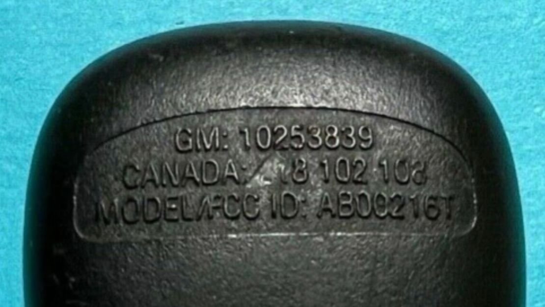

This part number is on the back of the passive fob
I'm pretty sure there were 3 fobs for the C5.
97-99 with passive switch.
2000-ONLY which is a 1-off piece of ****
01-04 which are the most desirable after an OEM upgrade to the system

I've owned three '99 C5's and bought one brand new, which I still own. All '97-'00 models can use the passive FOB, all 97-99 came with Passive FOBs. I've struggled with this over the years, just as you are now.
Soldering is #1 easiest and cheapest remedy. When it works. Otherwise finding a used passive FOB is option #2.
Online retailers tend to advertise the 2001 FOB for all years. Which is incorrect.

You are missing that the 97, 98,99 and 00 are RFA FOBs that are different frequency than 01-04. The 97,98,99 all came with "passive entry" (switch at bottom of FOB) which is a feature that unlocks your doors automatically upon proximity to the vehicle without having to touch the FOB.
The 01-04 FOBs can be purchased for $20-$30.
The passive FOBs are no longer in production. Early year C5s with RFA frequency will NOT accept the new FOB for 01-04.
