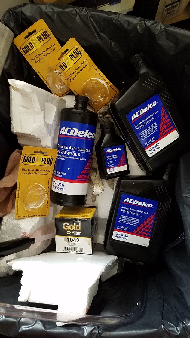

I just did the trans Fluid dump and refill on my 98',
Everyone has their favorites. I just went with the factory fill after reading about the paper blocker rings on the pre-2001 trans. I also added magnetic drain plugs for all the fluids, I have to tell you the original 1998 M6 trans fluid I removed was not as red as it should have been at 44k. Nasty dirty. Hard to believe they say this a 100k lubricant in the owners manual.
YMMV.

I second factory fill. I have 92k miles on my car and just had the dealer replace all of the fluids - this being one,
